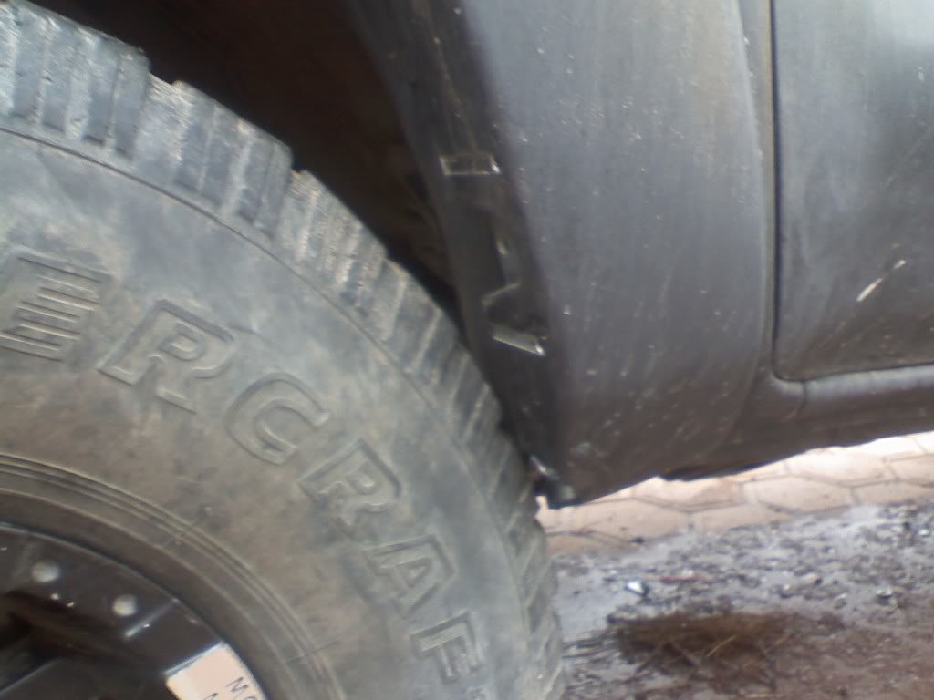

    o really. Even if i put a diff drop on? My problem is i had to get 35 inch tires on my truck because my 33s were bald, and i got these for free and they have more tread. Ive trimmed the plastic, but it is now rubbing metal. I need only 1 or 2 inches

    Rubbing body metal or frame/cab mount metal??

    ya cab mount metal

    i think cab mount metal. Right at the back end of the fender when i turn

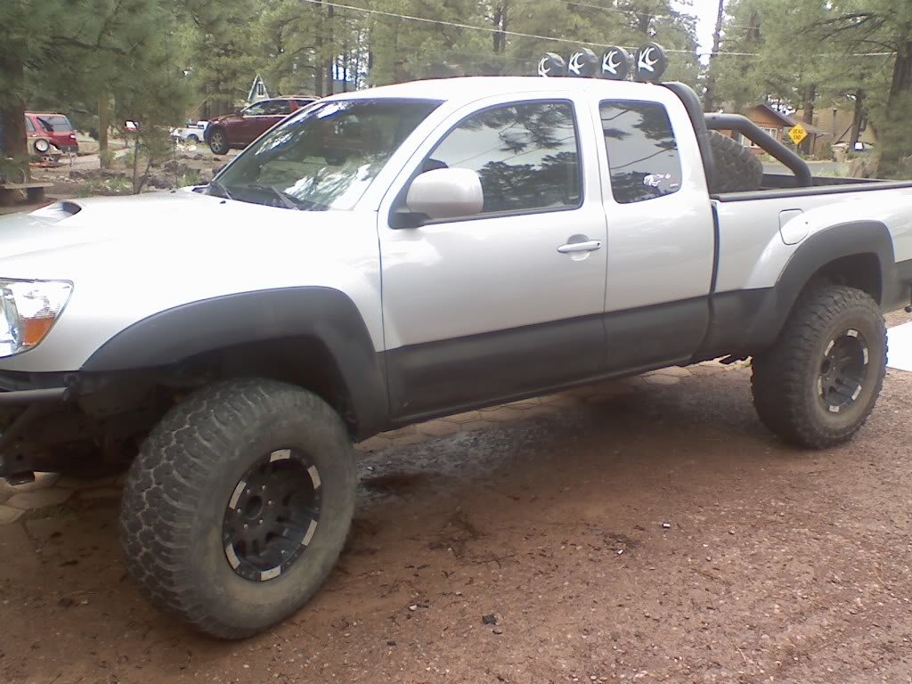

    whats blocked off? Here are some pics of how it sits.

    Hey man, the diff drop kits are to aide 3" lifts, they won't do jack for more than that.
    Your suspension will be absolute crap if you go more than 3" as is. like mentioned before you have 3 options.
    1. Cut the front up, body mount chop for sure: requires a little cutting/grinding/welding.
    2. 4.5" lift
    3. 6" lift
    4. Isn't an option in my opinion, but a body lift mould add more room... you would still need to chop that body mount.
    Look up "Relentless Taco" I think he has 35s with a 3" lift.

    ya i really dont want to do body lift either. I will be going to a 6 inch db down the road, just dont have the money now. Thanks for the info. Damn wish i coulda just stayed with 33s

    It doesnt matter if you had a body lift, you would still rub the cab mounts.

    x2 his truck is sick
