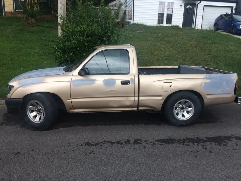

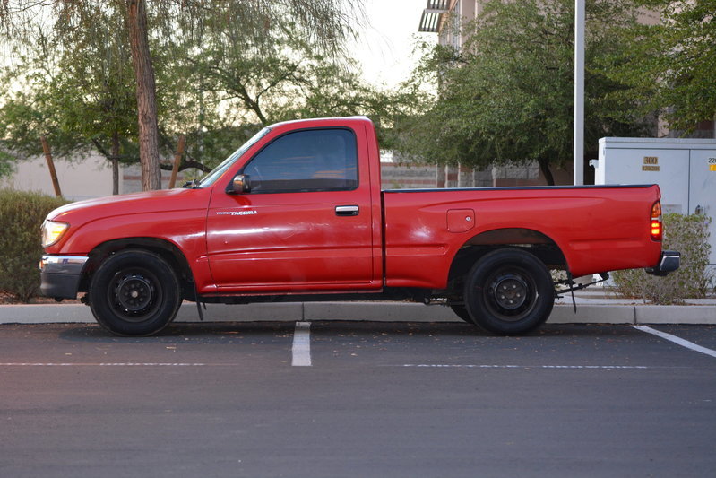

    Hey guys so I bought this beater of a truck and basically I'm sprucing it up to be a weekend warrior. Previous owner beat it to hell and lowered it. I know I can take the blocks out in the rear but I can't figure out if the front is lowered or not. I bought some 15" wheels that came stock on a ranger and the tires sit against the wheels wells in the front. I feel like there's no way it is stock and maybe he changed the springs or cut them? Provided is a long for reference from a guy who had a ext cab with similar issues.
    Here are pics of my truck and how it sits.

    Did they take the front and real shocks out? looks like they took the entire front and back shocks and put them down lower. I wish I could help you with this, but I have no idea what the prevouis owner did before anyway to contact him? and maybe ask.

    I have asked multiple time he claimed he only put the rear blocks in to lower the rear and that's all but there is no way that's true because the sway bar links have about three inches of slack in them. I'll post pics of that later. I'm just wanting confirmation that I need stock springs to raise it because I don't want to buy stock springs and find out that's what I already have and waste my money. But I don't see how I would have so much slack in my sway bar links

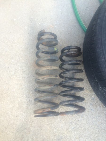

    That spring does look either cut or swapped out imo as well. Here's mine with stock suspension all around and 195/75-14s. I'm guessing those are 235/70?

    You're right mine sits about 1-2 inches lower thank you for the reference pictures that's what I needed!

    Just wanted do give a huge thanks to you guys. Picked up a whole rear end, springs, spare tire hoist all the brake cables for 150 put her in and after busting a few knuckles I got the stock springs in and my existing springs were cut, but she's sitting pretty now thanks for all the help guys!
