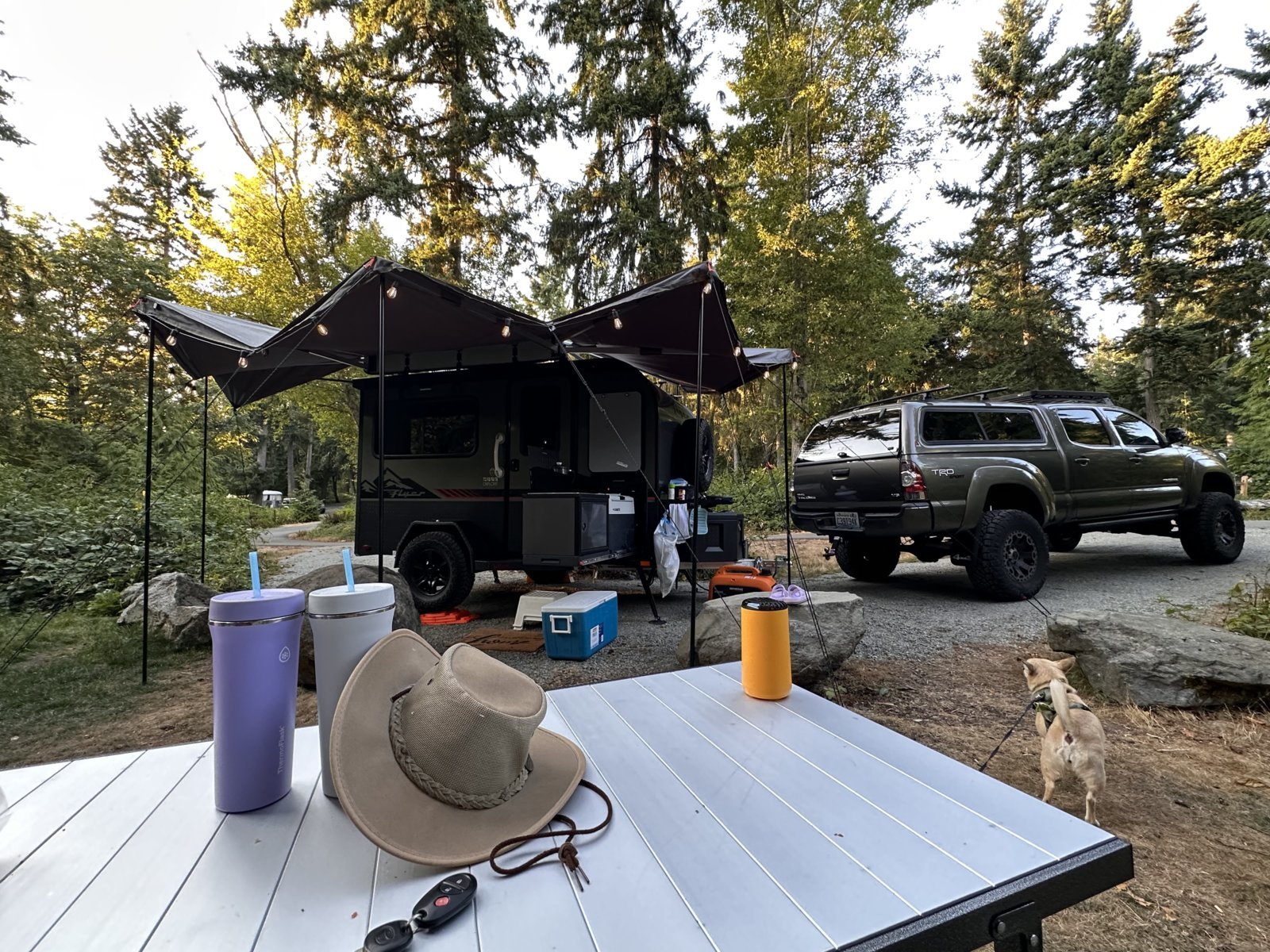

    There are a lot of people that are comfortable towing at capacity. I’m just not one of them. We live in Western Washington and to get anywhere requires us to travel over mountain passes. The Tacoma tows fine in 4th gear but struggles with wind and/or long steep inclines when towing. We have had a few white knuckle experiences in the past. In light of that, we now have something a little more manageable. Ours is right at 2080 lbs dry with a 190 lb hitch weight. By the time we add gear and propane we are at 2900lbs and we have spent more than a few trips figuring out the perfect load configuration for reducing hitch weight and balancing the load. 2013 Tacoma TRD Sport DCLB with a lift, canopy, cab rack, and 34’s. The lift, canopy, roof rack, steps, and tires reduce payload down to 550 lbs. just enough for me, the wife, and the dog with enough left over for the spare and a little bit of gear in the back. This works for us. The trailer is not as well equipped as heavier units but we are okay with that. In fact we are hybrid campers at heart. Trailer gives some additional comforts and conveniences while still allowing us to feel like we are camping. Plus it doesn’t mind the forest service roads we love to explore.
    2023 InTech Flyer Explore
