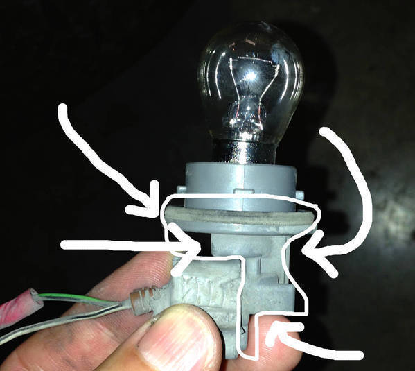

    Hello all. This is my first post so please excuse if I've posted in the wrong place. I had a fender bender last weekend and lost my right turn signal. I sustained damage to my valence as well. I have already ordered a new valence and right turn signal but am missing a part. I went to the local Toyota Dealership this afternoon to see if I could buy the part and the guy said I'd have to spend $1,000 to buy the entire wiring. I have been unable to find the part online anywhere. The guy at Toyota said I could possible make this work by splicing the wires and connecting it directly to the socket. My question to everyone here is this: Firstly, does anyone have this part or know where I can get it. It is the part that connects to the socket and is between the socket and the actual wires. It's not the part my thumb is touching. Secondy, if I'm unable to find this part, can anyone tell me how to wire this directly to the socket as the Toyota guy described? If I can't figure this out, I'll take it to a mechanic but I'm thinking it shouldn't be very hard. Hope someone can help. Thanks in advance.

    Thanks motor head, but the seller has no items listed. I wish I knew what this thing was called so I could search or ask for it properly. If anyone can help me find this item, I'd truly appreciate it. My new valence is coming in tomorrow and I should have my truck put back together except for this part. Very frustrating that not even the Toyota dealership had this item for sale. I'm looking for this part for my right turn signal on my 1997 Toyota Tacoma 4WD.

    Update: The guy at my local Toyota dealership is an idiot. I initially went to order a socket, thinking the entire thing (not counting the part my thumb is on) was the socket. He claimed it wasn't...that only the circular part (above the part I circled in my pic) where the bulb actually sat was the socket. I went ahead and ordered a socket from him but to my surprise, today when I went to pick up my part, there was the entire part I needed....that is the socket..it includes the part I circled and have arrows pointing to! For those of you who get in to a situation like I did, with a Toyota person who doesn't know what they're talking about, this entire thing is the socket....part # 90075-99092 to be specific. Thanks to all that posted replies in an attempt to help me!

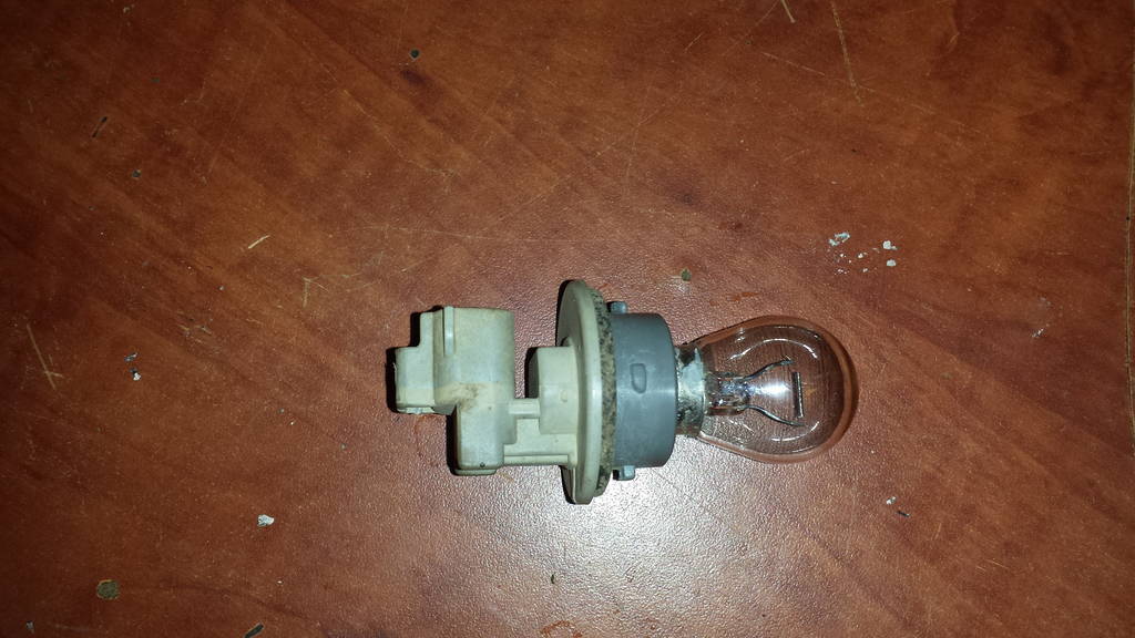

    Got this
    10.00 plus 5.00 shipped
    my bad, just saw you already got one.haha

    ya kinda odd, that whole part is the socket that the bulb fits into. when I ordered new signal housings from rockauto they were already there with bulbs.
