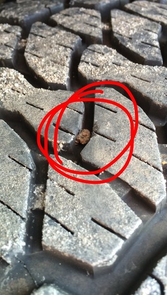

    Hey guys.
    So it looks like I've got a small screw in the tread of my stock Rugged Trails. Not sure how long it's been there but it's a slow leak, doesn't even trigger the TPMS sensors after 24 hours.
    I've attached a photo of where the screw is, located in about the middle of the tread.
    Do you guys think I would be okay to plug this, or is it something that would need to be patched from the inside?
    Thanks.

    I would have it professionally patched from the inside and sooner than later scrap the rugged fails.

    IMO a plug is just a temporary fix to get you to the tire shop for a patch to be installed. I'd just take it to the tire shop and have them patch it.

    Many shops won't touch it after you plug. Take to shop but get rid of those tires. :)

    Plug it!! I had 2 plugs in one of my tires before I put the new ones on in Feb.

    Air it up to max tire pressure, pull the screw, rasp the hole, then plug it and use a very generous amount of vulcanizing fluid. Once dry, shave the top off the plug and check for leaks. Congrats, you just repaired your own tire.

    3 votes patch, 2 votes plug.
    My every intent is to replace these tires when the money allows it, but I need them to at least last me until that uncertain time.
    I've been quoted $25 for the patch from 2 garages. Does that sound fair?
    Dealership will patch TIRES purchased from them for free, but won't patch the tires on a TRUCK purchased from there. Load of BS, but they're asking the same dollar amount as the other nearby garage and I'd rather have the dealer mess with my truck than Jo-Bob's tire and auto.
    It pains me to pay these people for this, I'd always prefer to fix it myself, but I don't have the tools to mount/re-balance.

    A plug you can do yourself easily.
    But a patch requires dismounting and remounting the tire, possibly affecting balancing, which you may have to pay for also.

    Also unmounting and remounting the tire, you run the risk of damaging the bead. At least when you do it yourself, you're not going to encounter that.

    ^ This. I use plugs for emwrgencyy repairs all the time. They can last almost indefinitely but sometimes they can start leaking after a fairly short time. If you plan to keep the tires take it to a shop and have it done right with a patch. Some places like Les Schwab will do it for free in hopes they you will buy your next set of tires from them. Discount may be the same.

    Looks like you still have about 5/32 or so I would repair it the right way, a patch from the inside. America's tire / Discount tire will fix it free

    There's nothing wrong with a good repair. Plugs can come out at high speed. There's not much holding them in - think about it. Those tires aren't great, but may as well milk the last miles out of them in safety.

    For $25, I'd just take it in, have it done and be on my way. Not even worth considering it for that price, LOL.

    I'd plug it, never had an issue with a single tire I plugged over the past 20 years.

    Patch/plug works fantastic

    Just thought I'd do a follow-up for you guys that posted and might be interested in a quick story:
    So after getting advice on here, I decided to take the Tacoma up to the dealership to have the tire patched. Turned out the tire had the screw AND a nail in it. After getting quoted $46 for a repair from Firestone, the dealership said they would charge me $28 which came out to $20 to dismount/remount the tire and $4 per patch.
    Took the truck in on a Saturday, took forever, but the service manager said it patched just fine and only charged me $24. Great!
