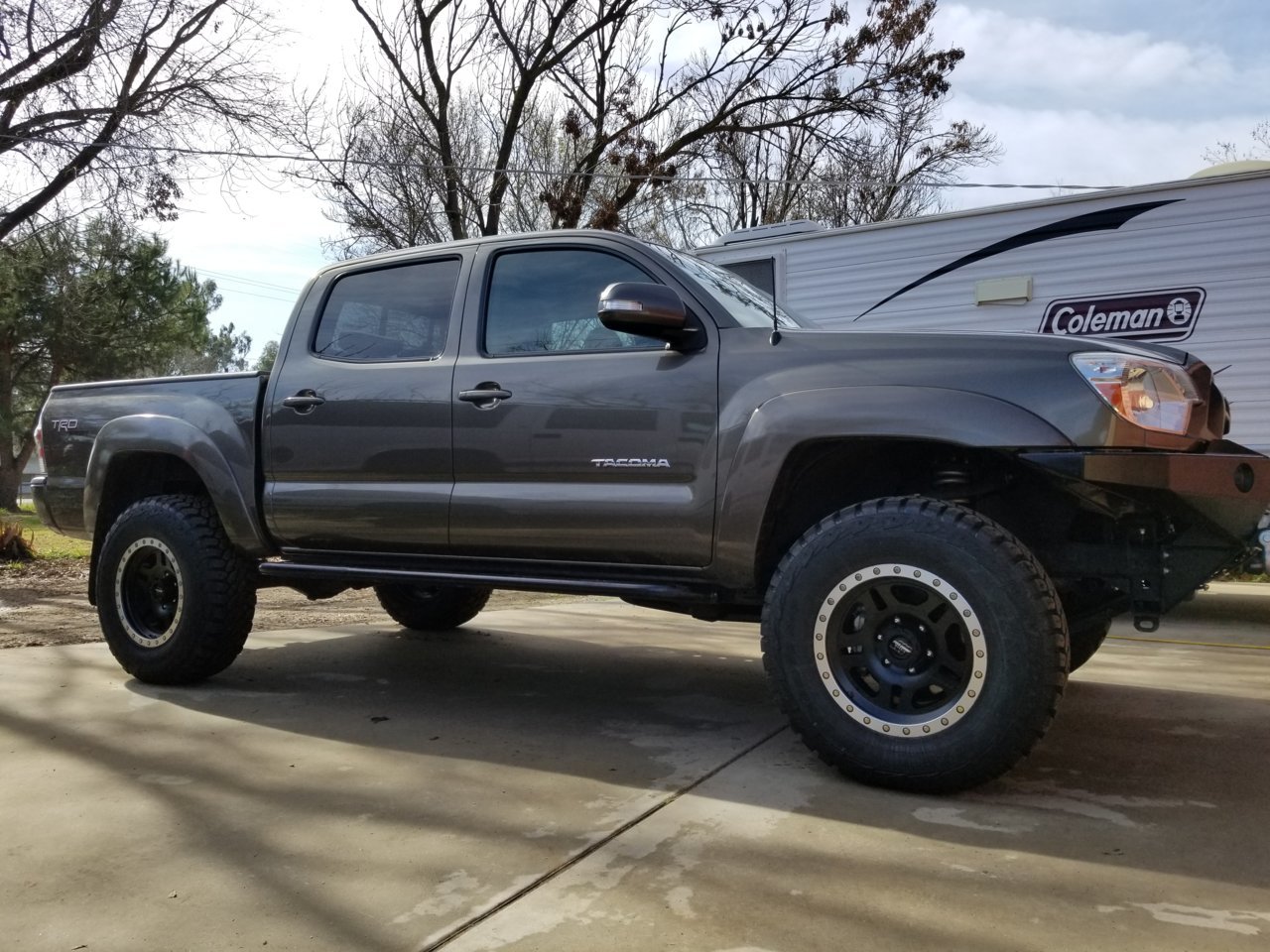

    Lift. 2”
    6112 front with Monroe Top Hats
    5160 Rear
    Icon AAL
    ECGS BUSHING
    SPC UCA’S
    Gonna use stock 17” wheels
    Tire size now 265/65/17
    What size should /can I put on with no issues. Daily driver with very limited off road
    Thinking Cooper ST Max or Nitto Grapplers

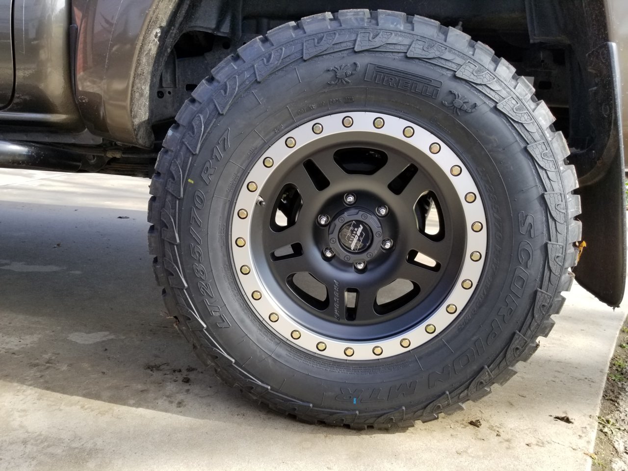

    12 DC 4x4 Lifted Sport
    Lifted, Kings, Locked, 295s and more.
    I am a 2nd gen, with 2 1/2 lift, running 285x70x17. CMC, pinch weld hammered over and minor timing. Good luck with your truck.
