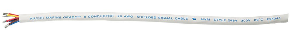

    Yeah... when I do the wiring I'm running wires for all 6 rocker switches whether or not they're being used at the time. A locker would certainly be nice... I have the TRD Sport DCLB 4x4 so no locker.

    it's 3/8 ~ 1/2 in diameter, has 8 conductors...
