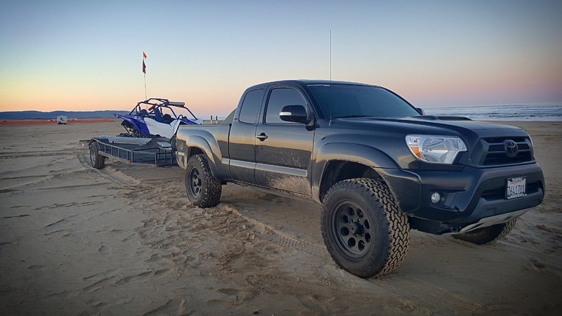

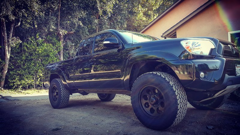

    I have 285/70r17...so.....almost the same size, youll be less than 1" taller.
    All i did was wheels (level 8 tracker i think its like 3.5" bs)
    Bilstein 5100 at 3rd notch
    Cab mount chop.
    I still rub at full lock amd compression (coming im to my downhill driveway a little hot) but they are fine 90% of the timeIMG_20170114_071410_069.jpg IMG_20160627_064129.jpg IMG_20160824_055115.jpg

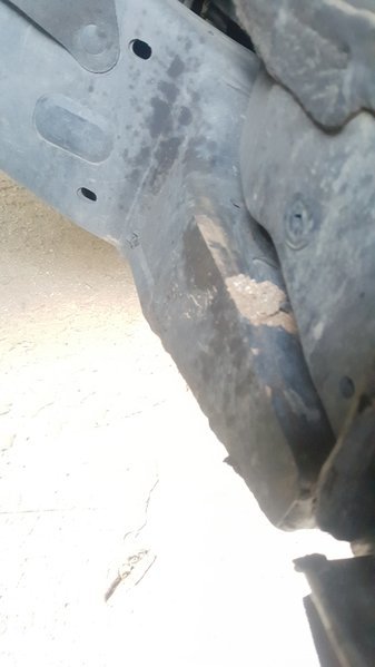

    You cut a section out, and then replate it. Relentless fab is who i got my plates from, they are precut so all i had to do was trace them, cut out the section i wanted (plus about an inch in for the clearancel amd then weld the plates back.
  8. May 2, 2017 at 7:33 PM
    Thesandaddict
    Thesandaddict The dude
    Mar 22, 2016
    #182067
    2,768
    Harley
    West Covina, CA
    2010 tundra bro-dozer
    Kinda hard to see, thats the back od the wheel well towards the cab20170502_193242.jpg

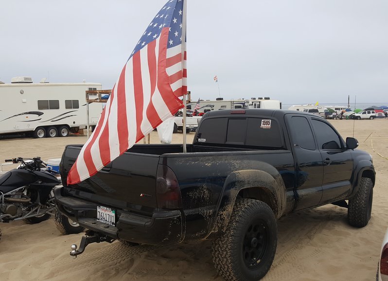

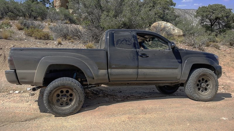

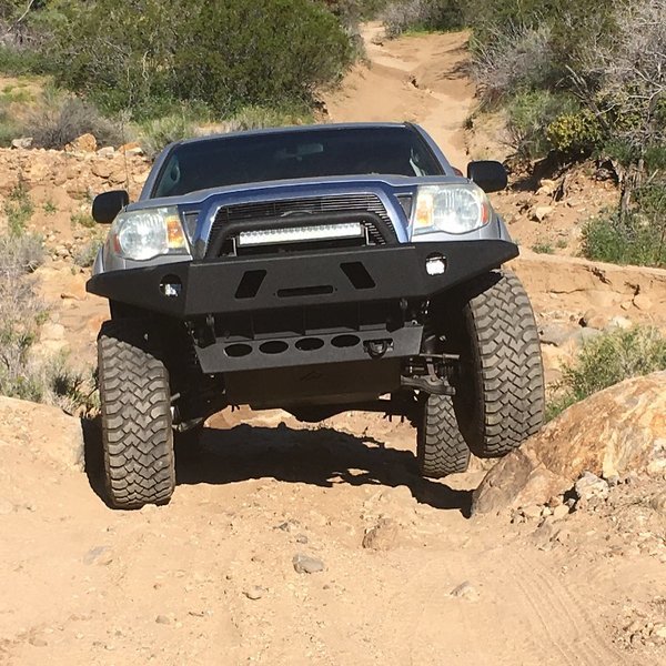

    Not as much as i would like. I daily drive it, so i try not to abuse it too much, i have other toys for that. But yea technically its been offroad lolIMG_20160705_222511.jpg IMG_20160704_081158.jpg

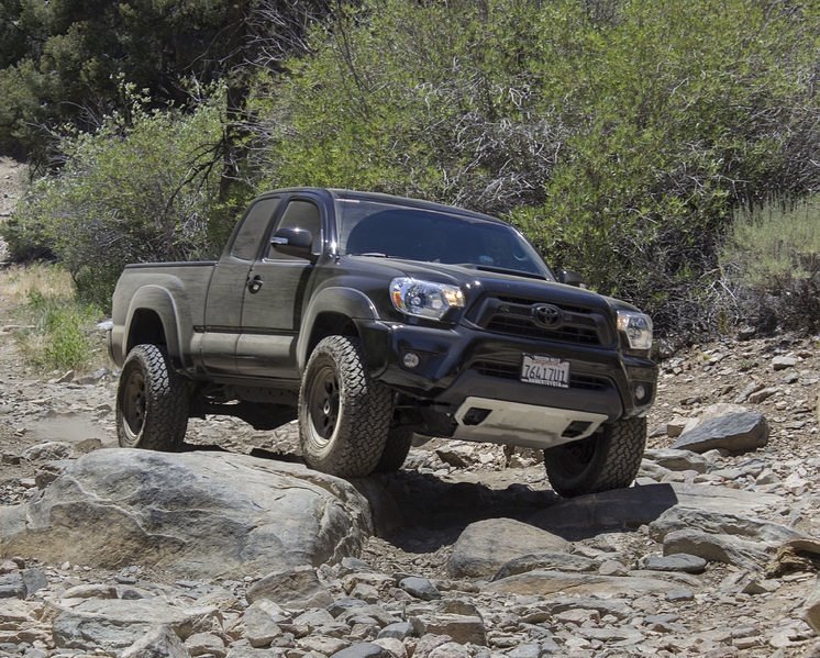

    Not much off-roading but I flexed it out pretty good and only rubbed the firewall lolIMG_3845.jpg
