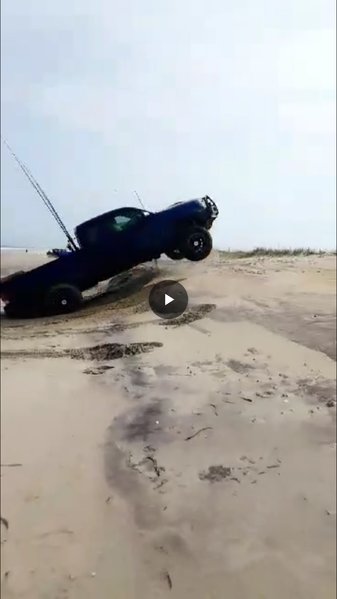

    Exactly. I guess I should have elaborated more. Thank you for explaining that, and very clearly.
    Which is exactly why I shouldn't have gotten rowdy at the beach this weekend when I got mad because I wasn't catching any fish... But it looked cool (not a video, just a screenshot). :D:D:D
    I had 5100s and stock springs before I got my Kings. With an ARB front bumper, and a winch shoved in it, I had to put them on the top notch to keep it level. It rode like you would think with all that preload. Like a dump truck. However, as stated, it's cheap, gets the job done, and it's decent shit.
    But after running these Kings, I can't go back. :D

    Oh yeah with one of those bumpers that would suck. Nice jumps there
