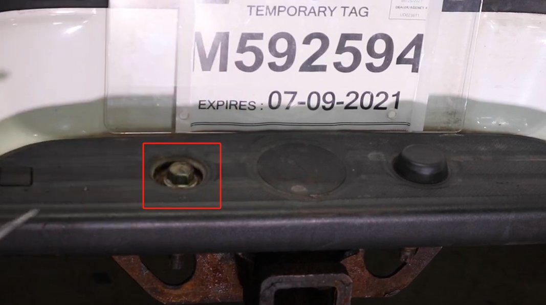

    I need to know the size of the bolts and nuts in the picture. I followed a YouTube video to remove the two bolts from the rear bumper, but I found that the threads on these two bolts are completely stripped and probably can't be used again. I need to know the size of these two bolts. My pickup is a 2010 TRD Sport 4.0L 4WD.
    I downloaded a service manual for the 2nd generation Tacoma, but I couldn't find the size information for these two bolts in the bumper components section.
    I would really appreciate any infomation you can offer.
    Thank you all in advance for your help!

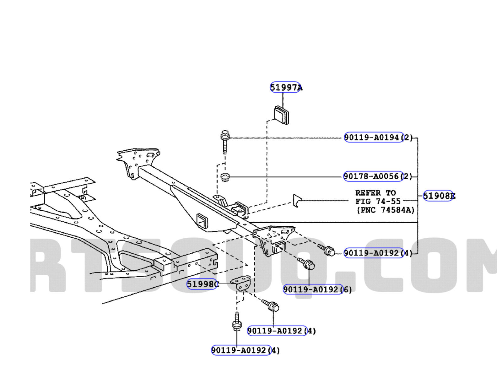

    The link in my signature below will have it.
    You need to pick the bumper with the tow package.
    Once you find the part #.
    Google it, and see what size it is.

    Pretty sure this is what you need.

    90119-A0194 and 90178-A0056 should be the ones.
    Thank you so much! I was browsing through the rear bumper section in the link you provided. Turns out I was looking in the wrong place.

    I'm not entirely sure about the socket size for this bolt because the bolt head was very rusted when I removed it. I had to use a flathead screwdriver to scrape off the rust for a while before I could barely hammer the 19mm socket onto it. After a few turns with the impact wrench, I noticed that the 19mm socket was turning along with the bolt. Then I tried hammering the 18mm socket onto it and used WD-40 and a wire brush to clean the threads up. Eventually, I managed to remove the bolt.

    The socket is a 19mm.
    The bolt size is a 14mm
    Toyota uses JIS bolts.
    Almost all the metric bolts sold in stores are ISO.
    So it will me a 21mm socket.
    I don't know thread pitch. Just buy new nuts to match the bolts you buy.
    I'd go with a minimum of grade 8.8

    This 19mm head. Which will make an 14mm. Also agree min 8.8 grade since it for the trailer hitch. The standard equivalent will 3/4”socket , 1/2”bolt.
