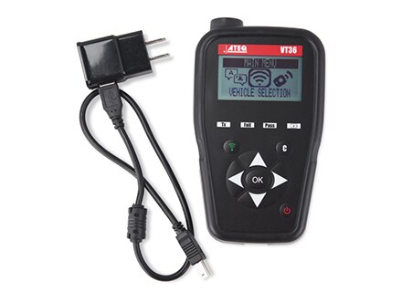

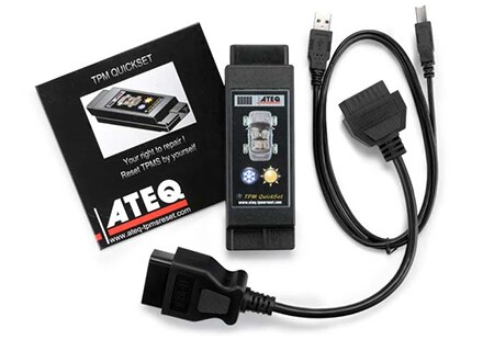

    [​IMG][​IMG]
    i had to buy these from tirerack to get my aftermarket winter tires to work,first to read, other to program into truck. I tried to get truck into learning mode, only worked once, but it failed to register.
