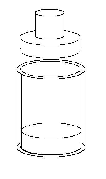

    Get a hydraulic press (ton of uses for them, you'll be glad you have one sooner or later).
    Make one of these. Slice the outer tube in half and rig a hinge on one side and solid latch on the other.
    Mount the bottom plug to a plate.
    Slip the sleeve over the plug, load the sleeve with copper, drop the piston into the top, and press it down on the press.
    When done, if the copper has squeezed between the piston and sleeve and you can't withdraw it, just open the outer sleeve.

    Make one? I don't have that much time on my hands. Lol
