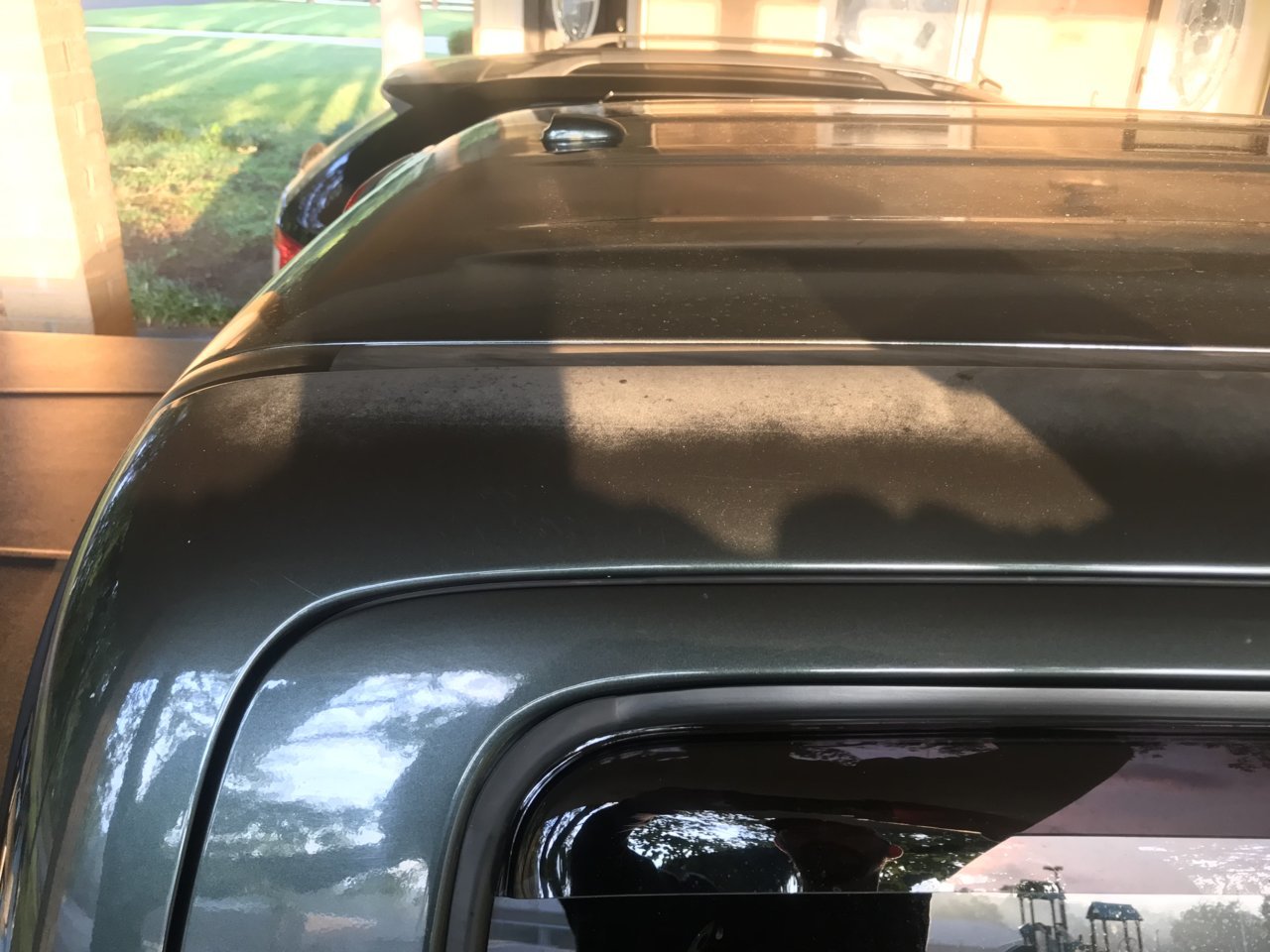

    036BA414-340A-4FBD-A899-4A350D299EE3.jpg Is there a product or technique that can get rid of the fade and white look of the paint above the doors? Thanks in advance for the help.

    you will need some clear coat most likely.

    Need more pics, but it looks like your clearcoat has failed. There is no fix for that other than a repaint and clear.

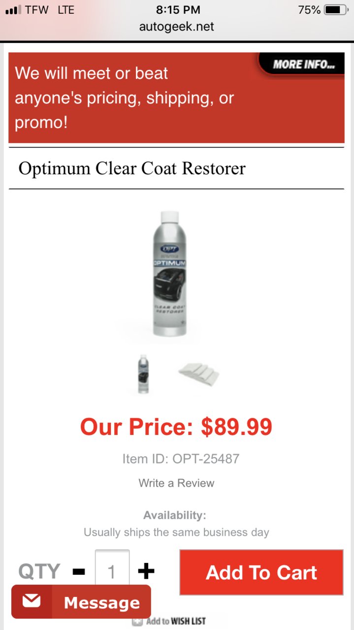

    Has anyone ever tried this product? Optimum clear coat restorer. Would this help or be a waste of money for me?D3CE56AF-B729-4D4B-A5F7-63E604B592CB.jpg

    That is a pretty cool products but I dont think it will achieve what you want. It ends up thicker and more durable than a ceramic coating, but is thinner and less permanent than clear coat. I don't know for sure but I think that is meant more for clear coat scratches, and clear coat that is depleted from years of compounding and polishing. I like that you're trying to find a solution but I would hate to see you throw money out the window.

    There is nothing that will fix that. Clear Coat has failed. That will need to be sanded down and repainted.

    That's not faded white. That's what the base color looks like before it's cleared.
    The clear is gone.
    Your options are few, and no professional option is cheap.

    I need to deal with the same but worse. I'm trying to formulate a plan to correct it cheap but my truck is not as nice as yours. From what I'm gathering, you have to remove all that failed clear and you'll likely get thru the base coat in some areas when prepping. A proper paint match will need to be done by professionals. If you just don't care and want to do it yourself, you can go a few routes but the you gotta weigh the options of possibly messing it up yourself and wasting a ton of your own time vs paying for pro work.

    I’ve decided to have it repainted. I was hoping to find a cheap fix but to get it done right there really isn’t one.
