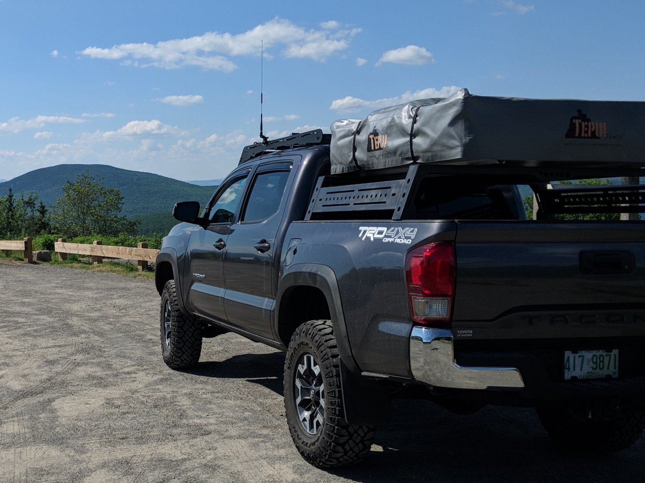

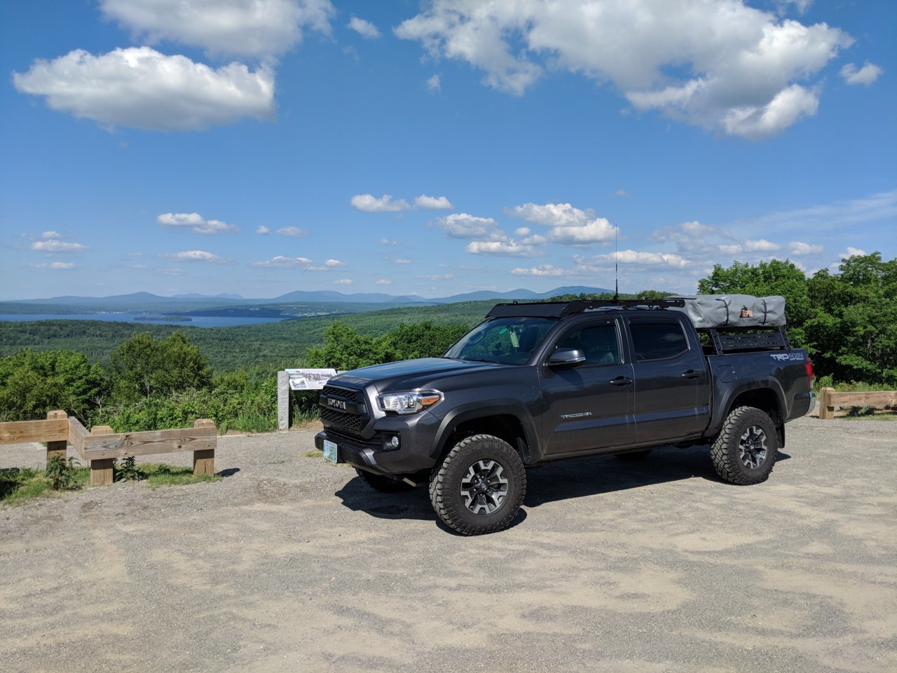

    2017 Tacoma DCSB OR MT
    Lots of sail boat fuel
    x10 on tires. A lift is nice, but real good tires can help you actually get places.
    265/75r16, and if you decide to lift later they'll still be fine.
