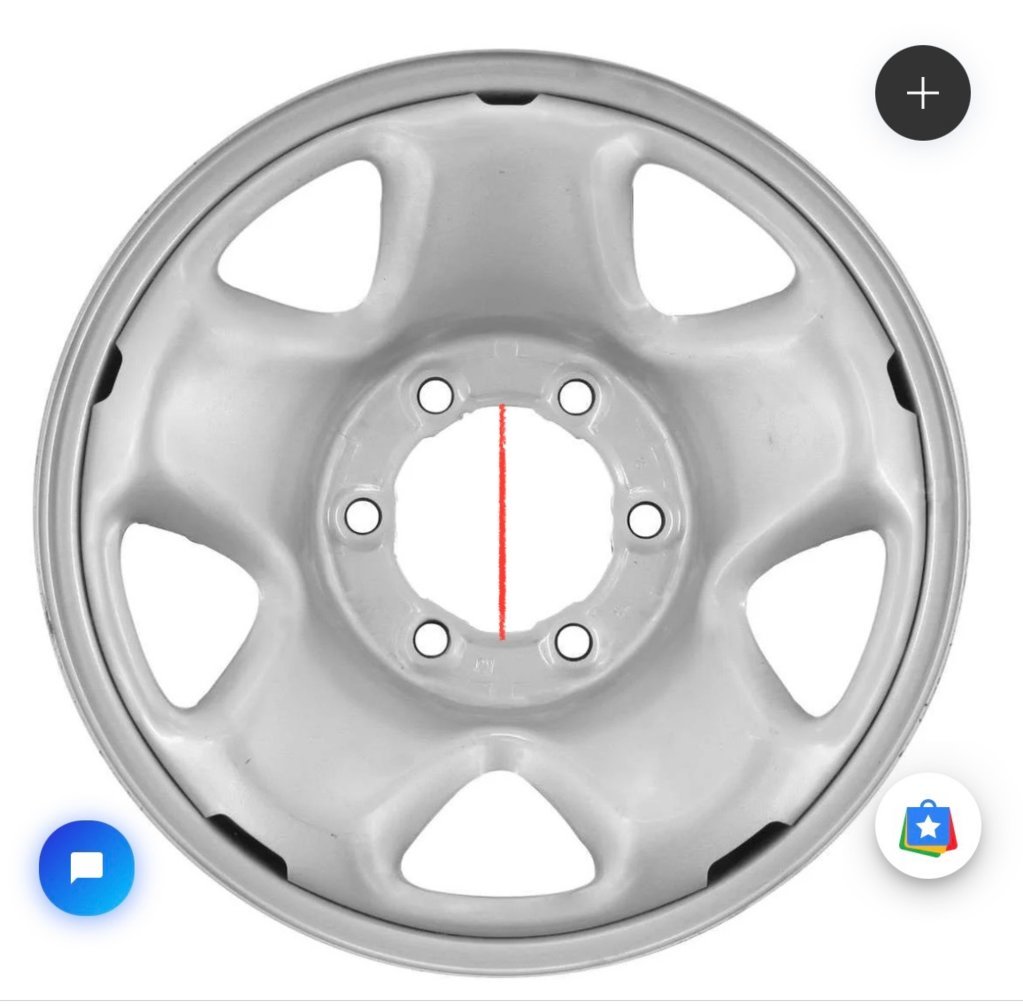

    Does anyone have a steel SR wheel that they could measure for me? I need the measurement where the red line is in my pic.

    If the webiverse is correct, the hub bore/center diameter is 106.1mm.
    On my wheel:
    The smaller diameter (between lug nut holes) is 106.2mm.
    The larger diameter (your red line) is 112.2mm.
    Hope that helps. :thumbsup:
