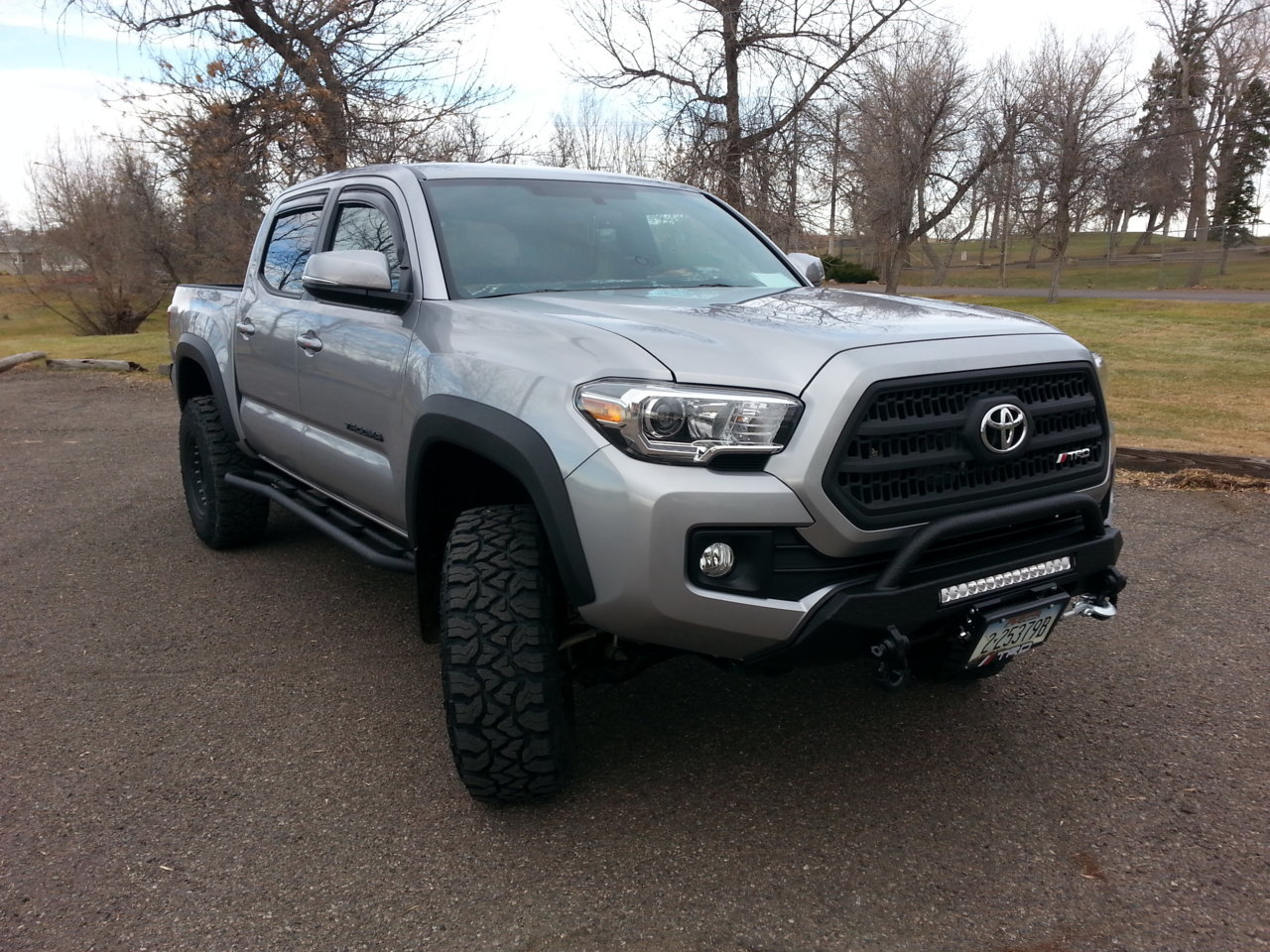

    16x9 -12 offset 265/75/16 but you will rub factory mudflaps without a lift and you will still get an occasional rub while turning going over bumps after removing the mudflaps. They stick out about an inch past the fenderwells.

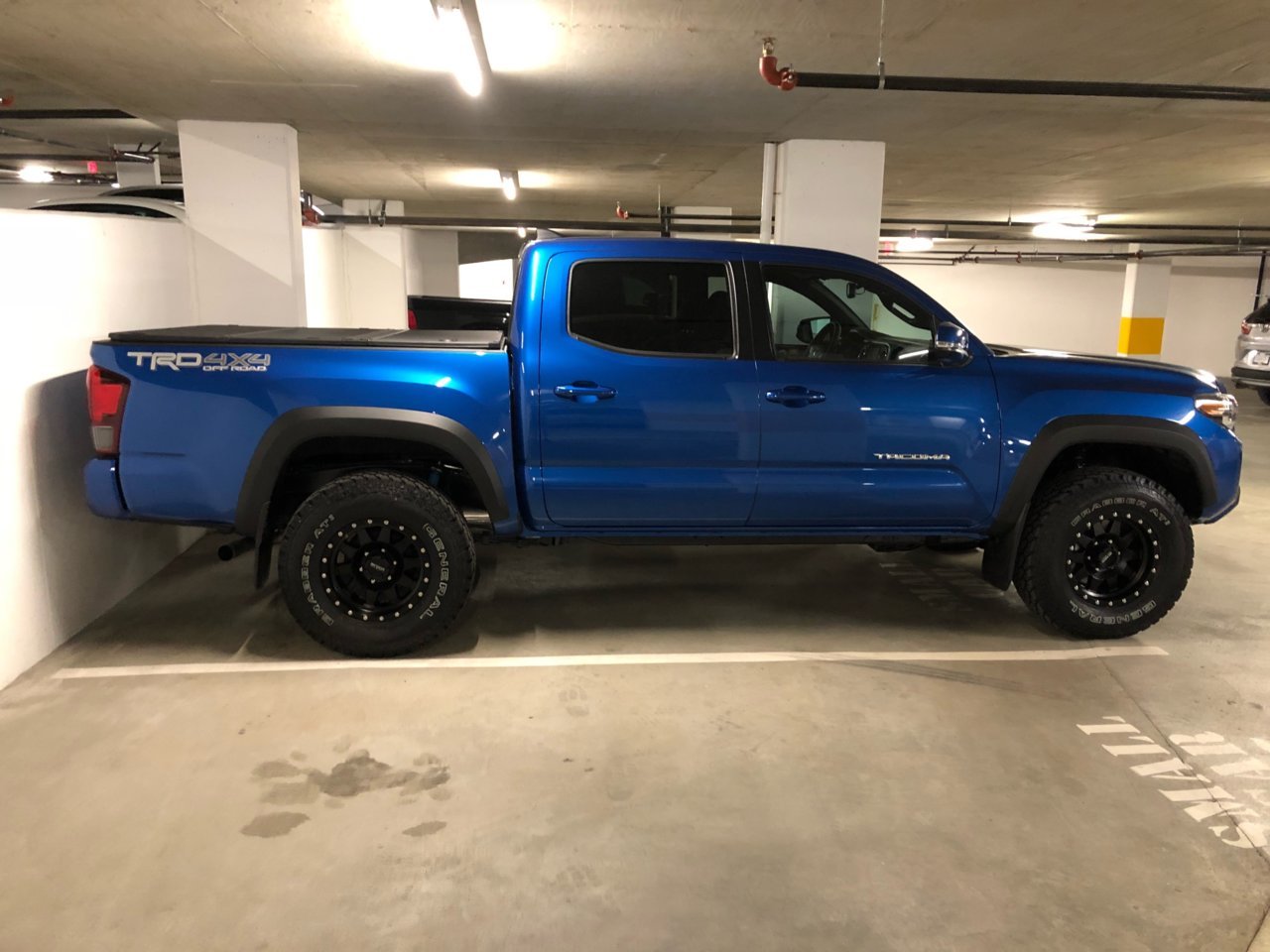

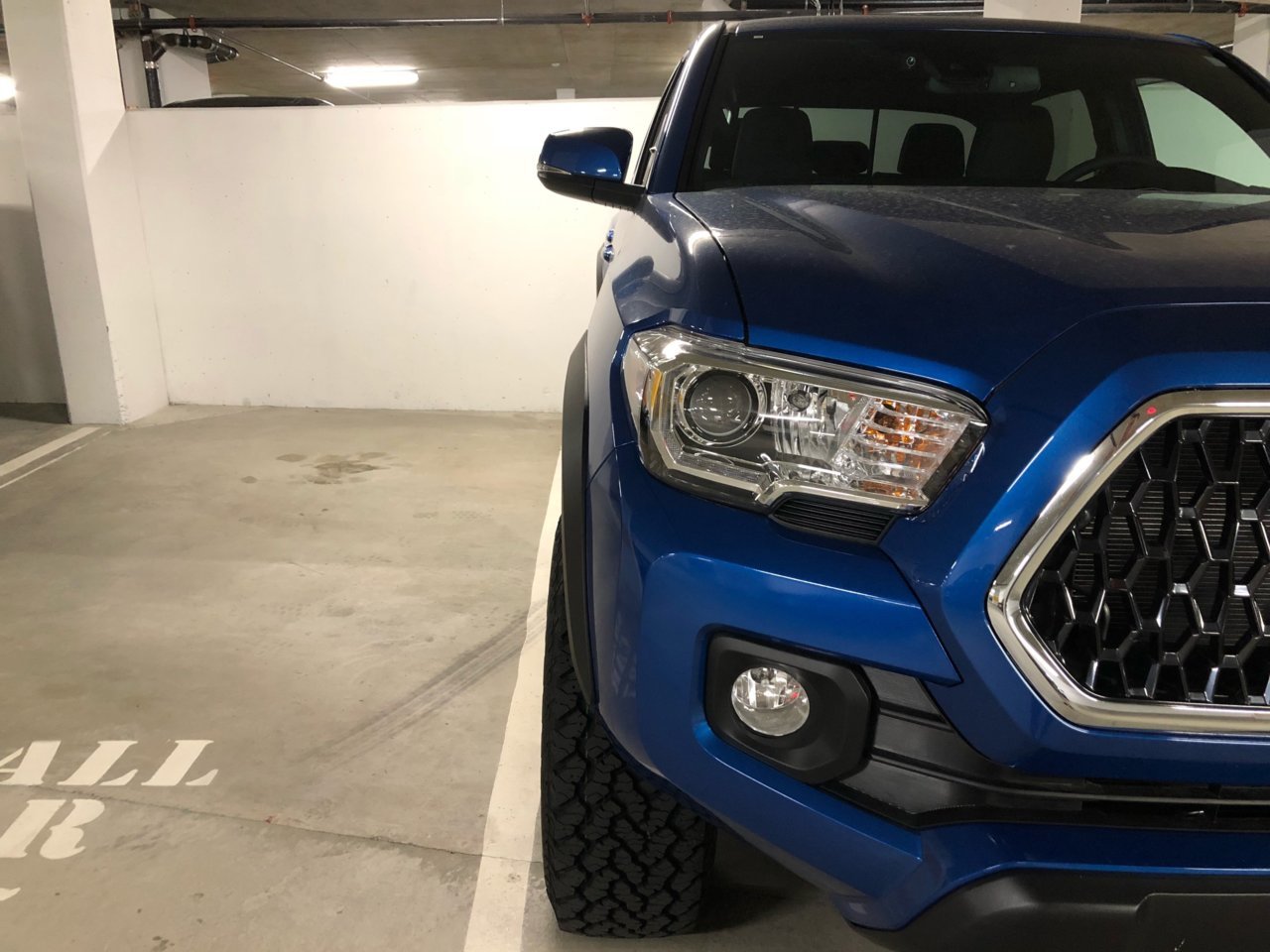

    If you want a bit of a wider stance you can look for wheels with an offset less than stock. I believe the Sport wheels have an offset of +30mm.
    Here is my TRD offroad with Method Standards (16x8) with an offset of 0mm
    Tires are General Grabber AT2 (265/75/16)
    Keep in mind that for the TRD OR the OEM wheels are 16x7 with a +25mm offset.
    Rubs the front mudflaps when turning while the suspension is being compressed. I will either just remove the front mudflaps, or trim them.

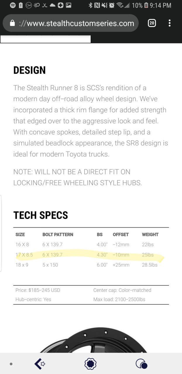

    Here are my 17" stealth custom series sr8s with 265/70r17 nitto ridge grapplers. Very minimal rub and no lift. 20180604_161443.jpg

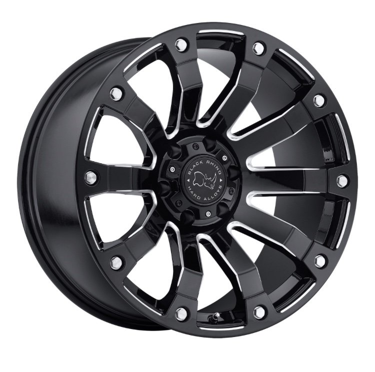

    I like these rhinos. They are 17x9 with +12 offset and looking at the new AT3 LT 265/65/17. However, I don’t think these would work because the stock rim is 17x8 and if my calculations are correct that would be adding 1.709” in total width?

    I believe stock is 17x7.5
    A 17x9 wheel is 1.5" wider than a 17x7.5 wheel. I'm not sure if you can run a 17x9 wheel though to be honest.

  12. Nov 29, 2018 at 9:46 PM

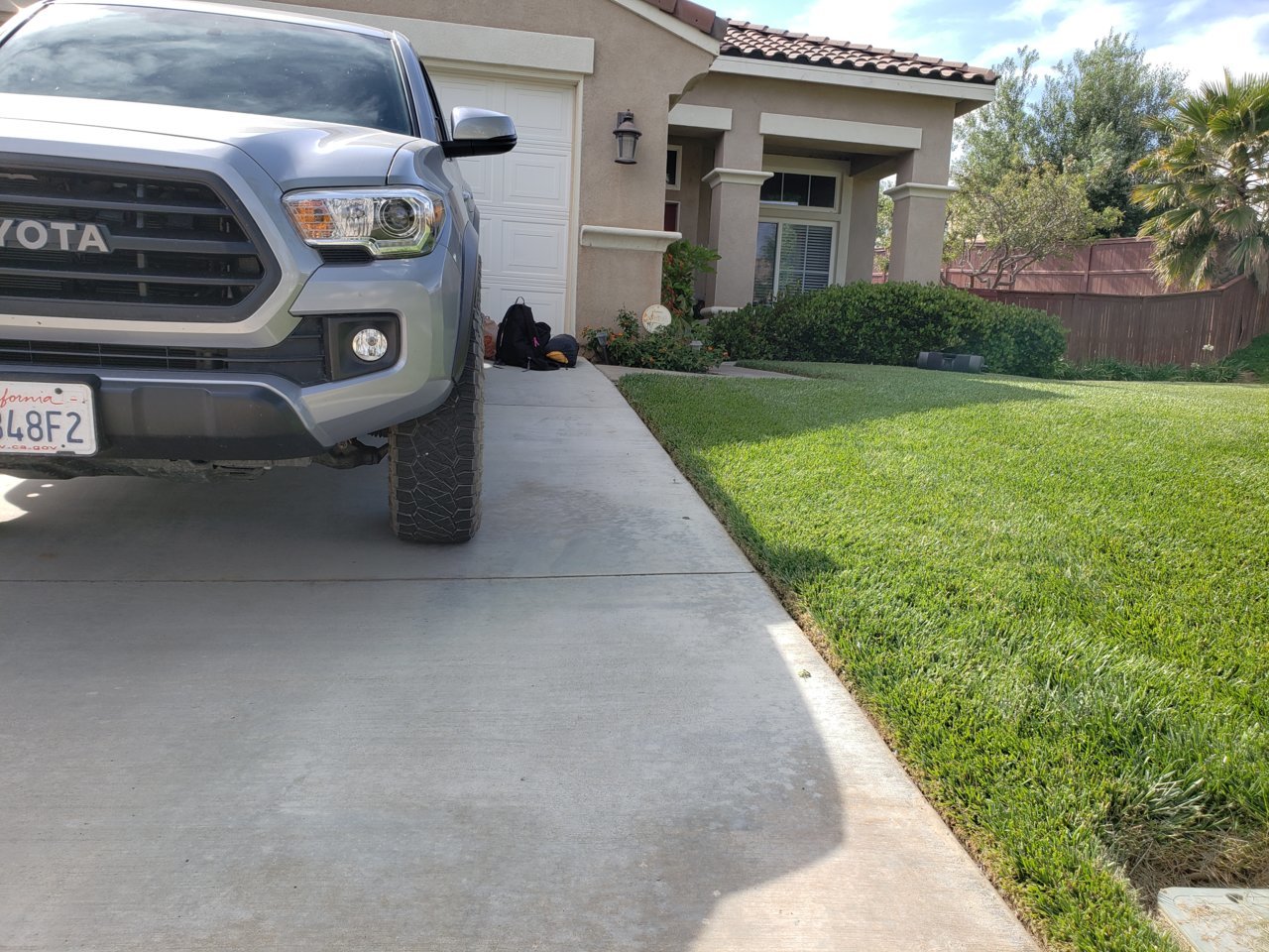

    Flowmaster, Pace Edwards Jackrabbit, bedrug, pop n lock TAILGATE lock Kuat Bikerack NV, PioneerNDBC8 front camera, pioneer avh-w4400nex head unit, DWG D10 17x9, good year wrangler ultra terrain AT Kicker speakers font/back Max Modular KBvoodo 10 inch rack (linger on short bed) Freespirit high country medium RTT Pedal Commander
    I bought mine new with these already on the truck dealer installed. It’s a DWG D10 17x9 in wheel with Wrangler A/T 265/70/17 tire with zero offset. No rubbing except when I turn into an uneven driveway and bottom out. I get very minimal rubbing but my mud flaps was removed at the dealership and it looks like they trimmed a very small area.
    I was hoping to one day put on a 2.5” to 3” lift when these tires are done. But I don’t know if I should go slightly bigger tires or if these same size tires will look weird with a liftD30A71DA-AE42-4CB7-BB9E-BB93AFCA5864.jpg
