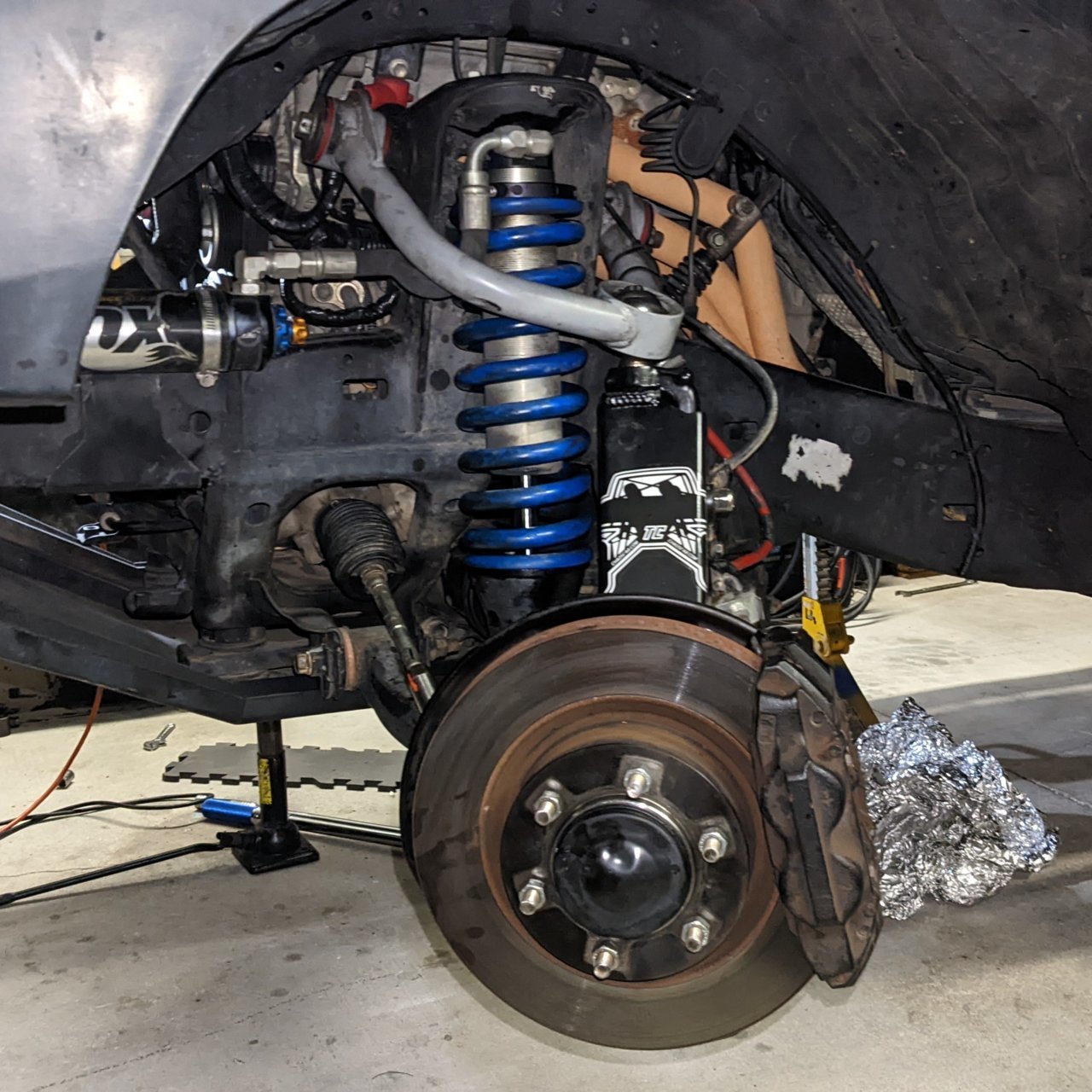

    My truck has 500+ pounds of tools and parts 24/7. 37" tires. It tows boats often, most are around 3,000 lbs, but has gone as high as 8,000 lbs. Whether it's towing less than 2,600 lbs or not towing at all it stops on a dime. All factory Toyota parts except for 1 small part. It's been installed for a long time now and no failures or anything else negative to say about it.
    https://www.tacomaworld.com/threads/my-2006-tacoma-brake-upgrade-edited.652471/
