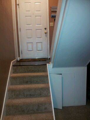

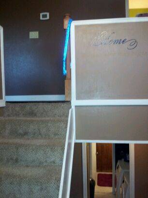

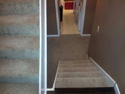

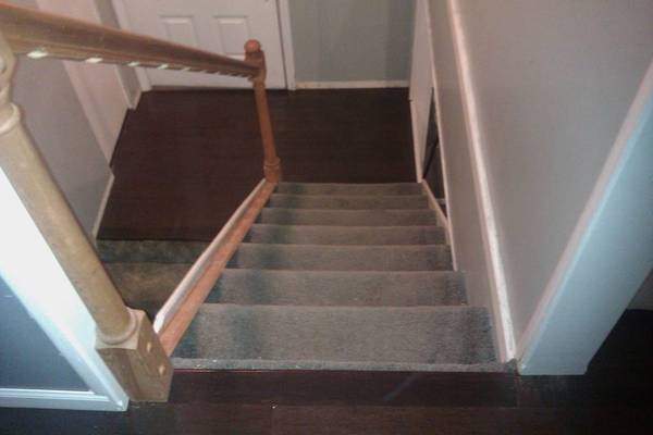

    OK, so I have a little predicament. I have a split level house where you walk into both sets of stairs. When I moved in, the house had a set of railings... but it does not fit the look of the house. It also was on the stairs itself and I do not like it. Here it was before I removed the actual railings.

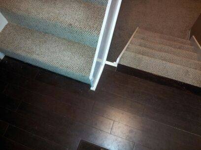

    Now, I have had some friends come over and look at it to find a way to add railings. None of them can figure it out yet how to make it work. Here is the area I am working with... anyone think they can help me with ideas? I am just looking to make some railings that fit up and down both flights together. I'm not wanting them on the actual stair like they used to be.
