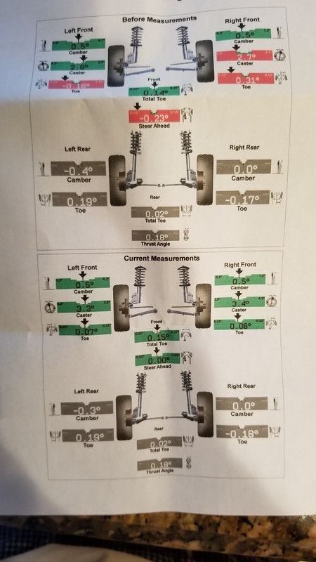

    These are my numbers from my last alignment..after trying 4 other alignments.
    As mentioned before I tried moving tires around no change..same pull to the left.

    Those alignment numbers look fine and I am positive this is a tire issue. I would try 0.5 degrees more caster on the left than right, bump it up to 3.9 and see if that makes a difference. It should fix your pull. This is assuming all your suspension components are in good shape and properly torqued etc.

    It should pull towards the side with less caster so a caster split of half a degree or so often helps, very common on Ford trucks. So if you increase the caster on the left, it should "pull" to the right an cancel out your current pull to the left.
