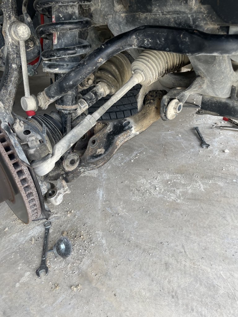

    I already did 1 side successfully by loosening the cam bolts so that my LCA falls. Easy peezy. Well of course the passenger side is 10x harder. My REAR cam bolt nut comes off fine but the front one is stuck. Front cam mount is loose.
    Also, my sway bar link nut turns, but the other side is literally a ROUND metal piece (yes no edges) so I can’t remove that either.

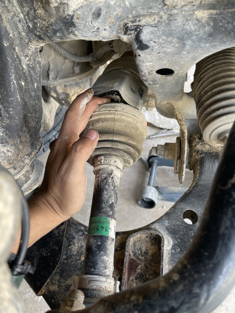

    Want an update on how it’s going? Lol look at this. How screwed am I

    ^Not a problem at all. The inboard CV joint "tripod" slides freely in the "cup". Just pop the tripod back in the cup and put a large hose clamp around the boot after you're done. Metal zip-ties work as well.

    Im trying to achieve that EXACT same thing. “loosen enough so the Lower arm swings down”. However. It isn’t swinging down! Yes the nut is loose on the rear mount and in the front the front the bolt is loose.
    I can move the LCA up and down and see the front mounts moving but NOT the rear mounts. I think it’s seized

    42
    hmmm this sounds much easier in your post lol. Thing is greasy as hell and does not want to fit back on there. I think there’s a metal clamp around it but with no ‘release’ clip. Tried needle nose pliers but no luck on that either. Any tips?

    Ahh the factory clamp is still on the boot. The dirt had cover it up lol. Use a flat screwdriver to pry up on the end of the clamp tab to release the three barbs. Picture below shows the small clamp. You would do the same action to the big clamp instead.
    The factory clamp is not reusable, so you can carefully cut it with side cutters as well. Be careful not to cut the boot.
