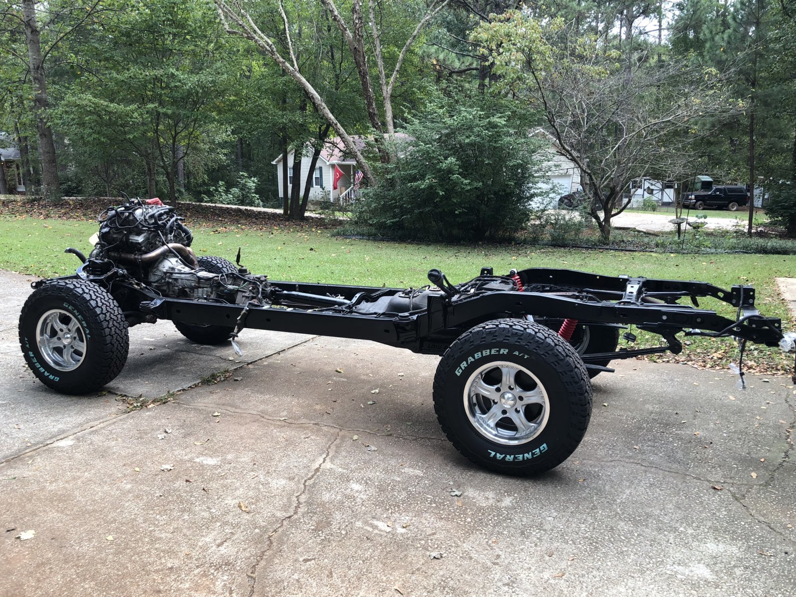

    I would like to know what is your opinion about 1st gen Tacoma that my friend is interested to buy. A 2002, 3.4l 2x4. Low mileage and price asked 7500$ Canadian dollars. The frame never been replaced by recall and the seller said it's just surface rust. I hope to be able attach the screenshots from the videos that seller sent to me. Thank you

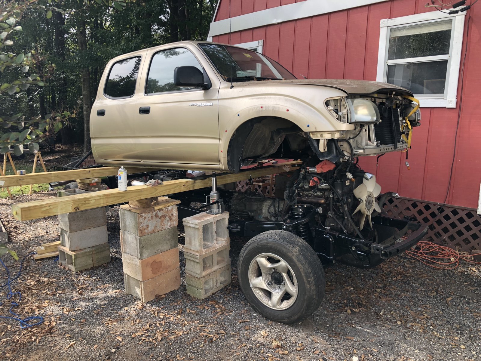

    9F76168C-81E6-4325-A8A4-9AF5606D1601.jpg 7E9768B8-6963-4F45-AD86-B135043FBA8B.jpg Having done this once, I would suggest first trying to even locate and price a possible replacement frame. Figure at least another 4-5k for fixing/upgrading stuff along the way.

    Do you have a death wish?
    Cinder blocks are a very bad Idea to support anything
    rocknbil and wingnutj468[QUOTED] like this.

    It was actually a lot more stable than it looks. It was a little creepy getting under it the first time, though. The Tacoma gods were with me. I reckon if they’re good enough to support all those mobile homes…

    I had a friends son killed using them. His Parents looked to have aged 20 years His Mom was never right again
    I saw another case no one around the block broke vehicle fell did a few thousand in damage to his Dads 66 Corvette
    If your vehicle is 60' foot long how many blocks fail before it roles over.
    Not so much you but the people your death impacts.

    Bivouac, the passion you have for the safety of others is admirable. It was not my intention, by posting this picture, to upset anyone with such an intimate experience of cinder block failure. Might I suggest perhaps starting a thread on the proper method for decabbing a Tacoma.
    TrueNorthGuy, please have your friend also consider the extra cost of some quality jackstands to his frame swap.
