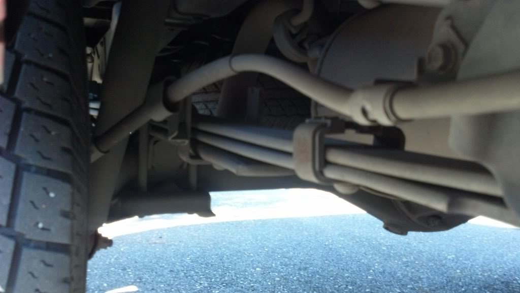

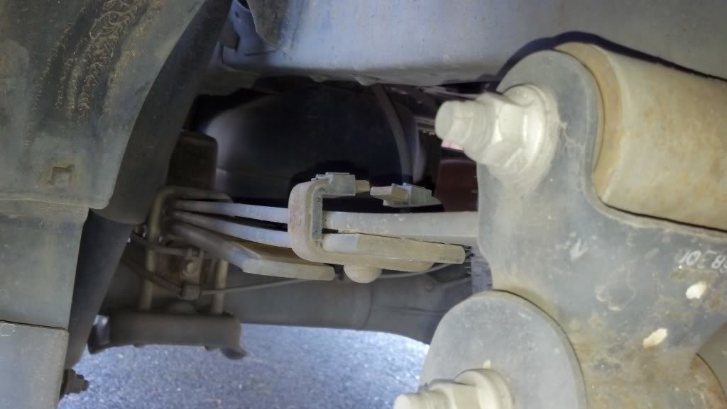

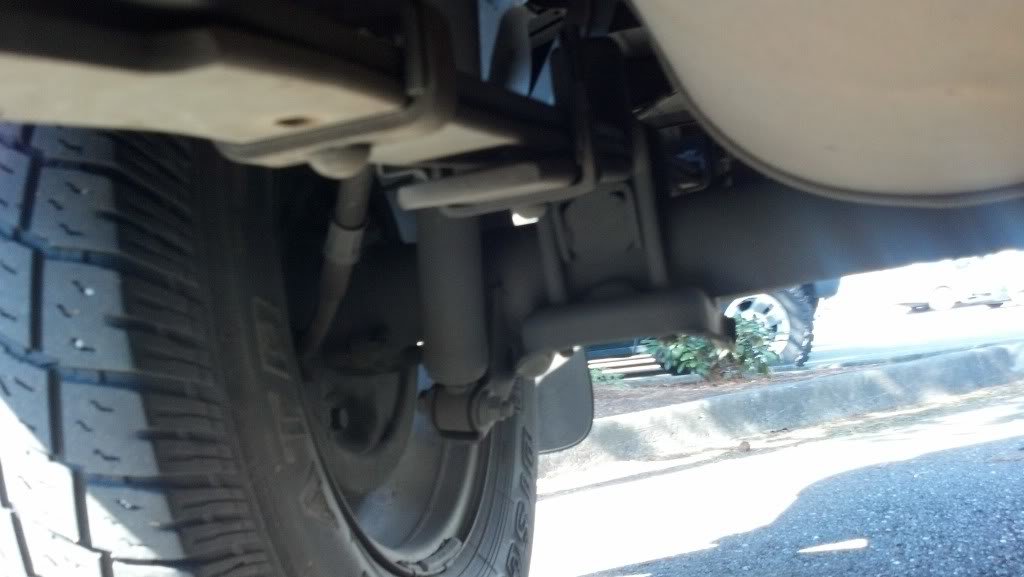

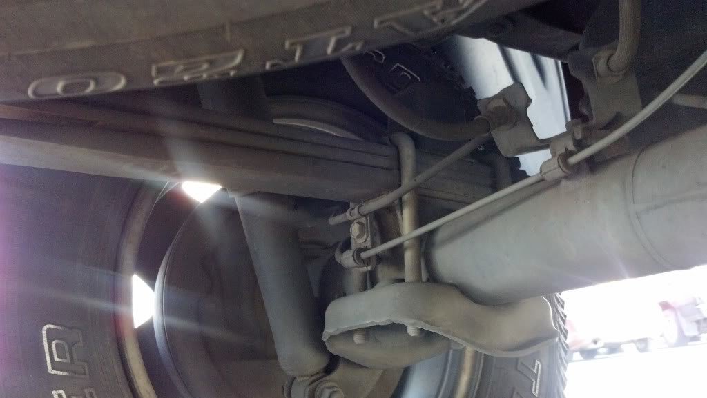

    So here's some photos that I just took:
    I wish I could do better than these, but I am at work. Anyhow, I've been reading up and saving up for a lift, but I'm thinking that these are not in good shape and that an AAL won't help me, and it's time for new packs.
    Can you guys help shed some light on this for me? I know there's a few options for new leaf packs, OME/Dakars for one, but any other suggestions would be wonderful.

    I'm going to go All-Pro standard leafs when my time comes.
    EDIT
    Nvm..you have stock suspension. Search our local craigslist to see if anyone is selling their OEM leaf pack. There's always a chance.

    TRD skid painted black,
    Mine look like that with a 1 1/2" AAL!!!
    I have a 2" but I don't know if it will help.
    May need a good set of springs.
    I do carry some stuff in the bed so..............

    That is pretty much my rear end on my 06 except mine are frowning a lot. I am getting some bilstein 5100 with 885x coils up front in a month and in the process the spring shop is going to build me some custom leafs. I have a canopy and haul tools around so I am stoked on the prospect of no more frown
