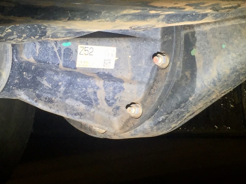

    2016 TRD OR DCSB built in 5/16. Vin not on list, but I would say I am having quite a bit of seeping. Also Have the howl.

    With all the photos of ORs with major seepage I wonder why they are not on the list? Seems strange.

    Seeing all these pictures of the OR trucks w/ the issue (and not on the recall list) is making me wonder if it's not an issue across the board really. Is it the bolt torque or maybe a crappy gasket? Warping of the cover and/or diff case? If there are this many folks having this issue, it could be more than just bolts not getting torqued correctly. And yes, I do understand that we on this forum are not the total population of trucks out there.

    The speculation is that it's the heat treat on the studs allowing them to stretch.

    That would make sense... so, just torquing them more really isn't helping, it's probably only going to leak again.
