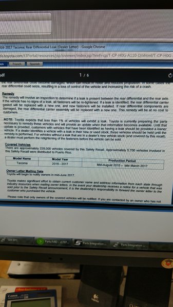

    Basically mid August 2015- late March 2017 production. If it's not leaking they'll recheck the nuts. If it's leaking they'll replace the gasket and fluids. If it's too bad they're going to replace the carrier.

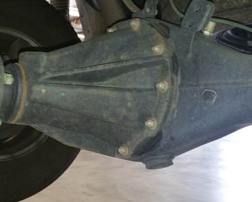

    Thing is if its leaking due to be over tightened would they not need to replace the whole gasket?

    My coworker had a full blown leak which was puddling under our parking spot we use at work on his 2016 DC SR 4x4 V6, they refilled and re torqued his diff a few months ago

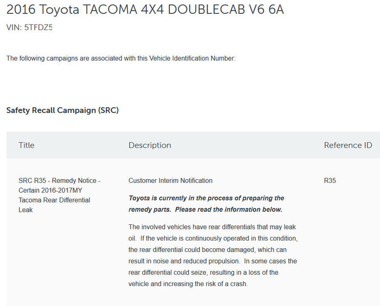

    @Joe23 My build date was April 2016. Anyhow, this is what I'm seeing on the site when I enter my VIN.
