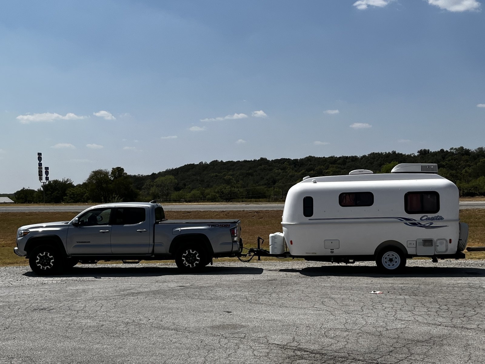

    I have a Casita 17' fiberglass trailer with a dry weight of 2400 lbs and 450 hitch, I would say this is pretty close to the max I would tow any long distance with a tacoma. I am not one to pay attention to load ratings but wind resistance is a killer with a travel trailer. It is rounded off like an egg so probably more aerodynamic than most RV's. If I stay at 65 ish mph the tacoma does OK. If I try for 70-75 = sitting a 3,000 + RPM getting 9 MPG. I cant imagine doubling the weight, sounds like a good way to kill a transmission and motor.
