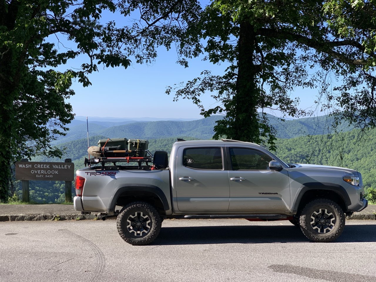

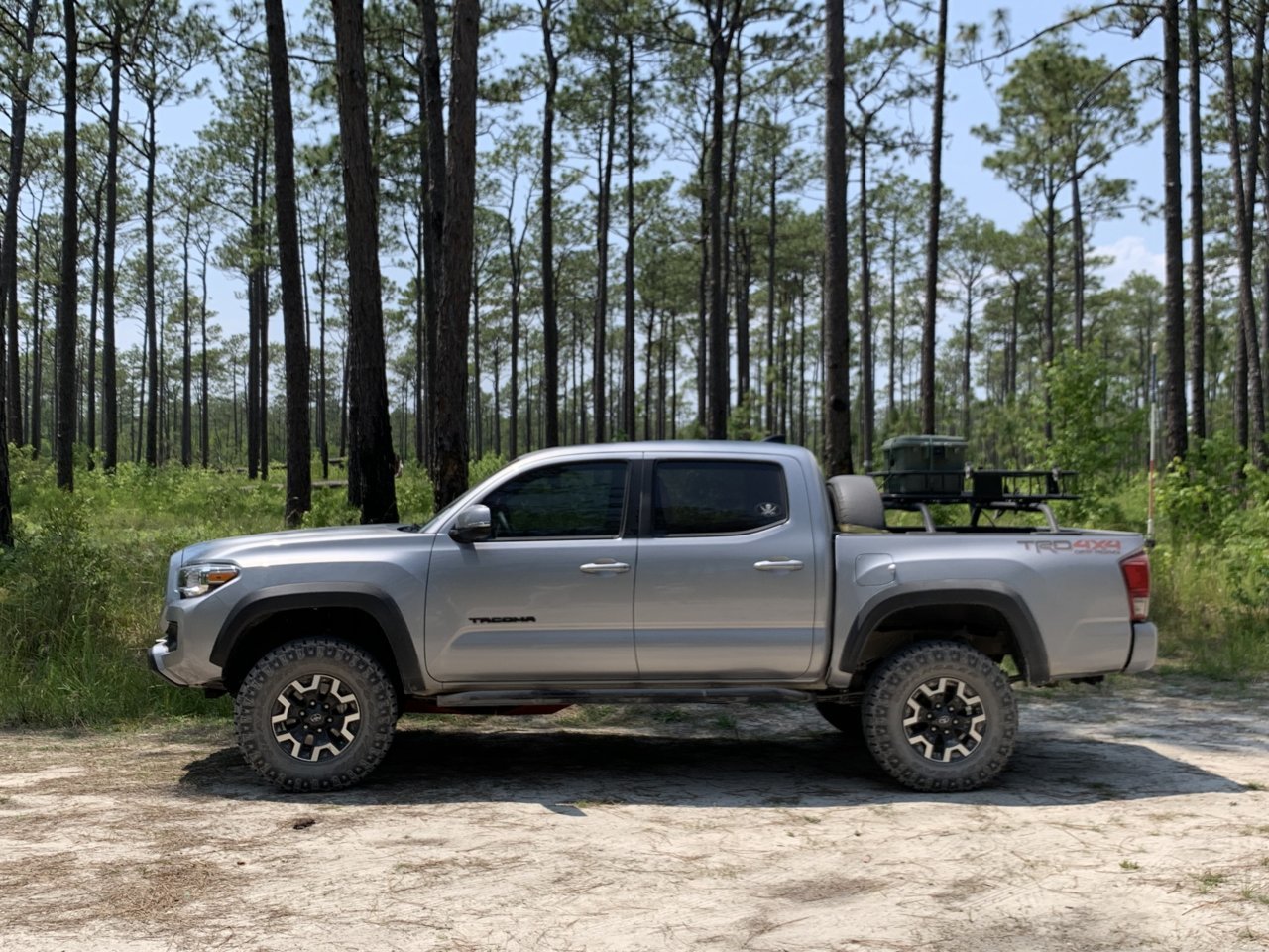

    3rd bedrail.32”duratrac tires.CaliRaised bed stiffeners,rear ditch bracket for cb antenna .SOS Concepts sliders,3skids,bedrails.curtis rack.cobra 75 cb.HAM license.887 coils,Bilstein 5100’s,medium Dakar leaf pack,extended rear brake lines,wheeler’s superbumps bumpstops.carrier bearing drop bracket.sway bar delete
    @HeadStrong Off-Road is a good place to start.
    I like my 887, bilstein, Dakar leafs, uca’s...much better ride.
    The 5160/6100 may be a nice setup, but was probably a long wait at the time I did mine..
    A pic to see it after the lift..I am on 32’s in the pics..

    Does look nice from the pic. What is the expected price range of similar setup? I do know that I don’t want to spent 1,000 or more now and then turn around later and spend 2-3k more later on due to non satisfactory addons.
