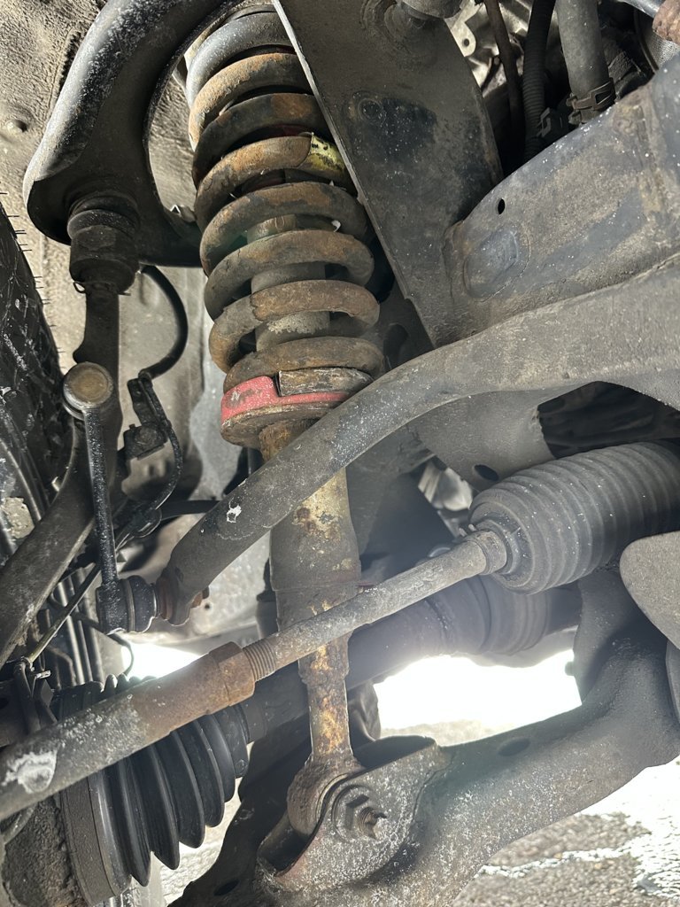

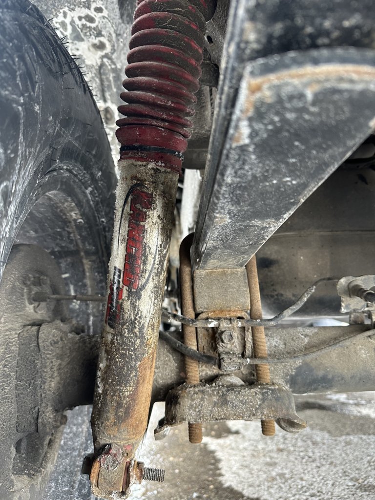

    I'm not too sure how to post correctly on here just yet, and I'm a first time truck owner, and first time doing any major work on one, but I want to learn. I've researched for days on here but still have some questions that I'd like direct responses too. I bought a 2011 trd sport 4x4 the other day. First owner of the truck put a 2" lift all around with a lift block in the back and from what I can tell a the fronts just lifted with an aftermarket coil over. The rear existing shock absorbers are Rancho RS9000 xls and i cant identify the front from suspension from all the wear on them. Currently riding on 265/ 70R 17's. My first question is am I going to be okay keeping the 2" lift blocks on the rear and installing some 5100's? 2nd owner put a new leaf pack on but I have noticed there are only 3 leaf springs to it and I thought trd sports came with 4 leaf springs, should I be concerned about that? I don't plan on towing or hauling anytime soon but will upgrade the leaf springs if i buy a tow behind camper (Which I plan on doing) And my other main question is what suspension I should put under the front end. I'm open to dropping the front end lift to give the truck some rake but not sure if that is advised. I'd also like to change tire sizes to a skinnier tire (my fuel economy is lower then it should be, I barely got 15 on the highway) and I'm considering doing a 255/ 75 17.

    I would replace the leafs and the blocks. Those are likely the original leafs. Or, whatever leafs the 2nd owner supposedly put on are OEM leafs from a pre-2012 tacoma. In any case, they are shot (which happens at lot). You can see them flat and even some negative to the arch in one of your pics.
    Up until 2011 they only used 3 leafs. This resulted in the leafs sagging, so they issued a TSB to replace the leafs with 4 leaf versions. 2012 and forward have the 4 leaf TSB leaf packs. The 4 leaf packs weren't a huge improvement either. Mine lasted about 3 years before sagging on my 2013 lol.
    OEM leafs are expensive af to buy new (for what they are). And used ones are often already sagged. So you're better off going aftermarket for replacement. If you stick with around the same lift numbers, you can put a set of Deaver Stage 1s or Dobinson 111's to get about 2" of lift without any blocks. Deaver will ride significantly better than Dobinsons, but they are also more expensive. Both will handle towing much better than the OEM leafs. If you find either too stiff when unloaded, just toss some bags of rock back there.
    The front coilovers are Rancho as well, likely came as a kit with the rears. They claim 2.5" of lift in the front. 5100's will be a decent replacement. They would be comparable to those Ranchos in terms of ride quality, maybe a bit better. You'll need to purchase new coils to use with the 5100s in the front though. Might want to look into 6112s as they are a step up and include coils for not much added cost.

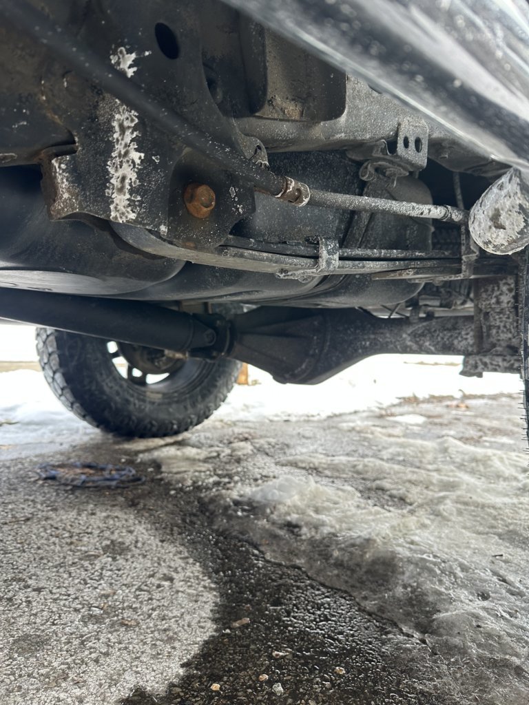

    Rear axle seals leaking?
    see all that grime caked onto the brake backing plate?
    cant tell if shock is leaking to from pic, dirt of grime / oil trailing down the rear shock?

    I hope the rear axel isn't leaking, I had a prepurchase inspection done by the local toyota dealership and the only thing the mechanic said about the rear end is that my shock absorbers (especially passenger side) were shot and needing replaced. So it could be from the shock draining but I also live in PA where we love to over salt our roads and that winter grime builds up quick, it was a 3 hour drive home from buying the truck and I haven't washed it yet.

    Not certain from 1 pic, but the last pic....
    See all the grime, caked onto the brake backing plate at the rear wheel?
    All over it.....
    Its wearing out inboard past the leaf....
    Thats usually a sign of rear axle seals leaking....
    Run your finger through it & run it grime in-between your fingers...
    If it's grimy, it aint just dirt.....
    the dirt collects to the gear oil & hides the oil.....
    Looks like a leak from my laptop!!!
    You can also compare the side in question to the other side, if other side is dry & clean......

    I just went outside, both sides look almost identical when it comes to the grime coverage. I scratched away to the metal surface of the brake backing and rubbed the grime in between my fingers. It was slightly grimy but there wasn't an oil residue left like i would normally expect. Is there a chance that a fluid film undercoating would assist in the grime build up? Either way I'll get the area cleaned up and keep an eye on it. Thanks for the heads up. If the axel seal is bad I'm assuming that's a pretty serious job?
