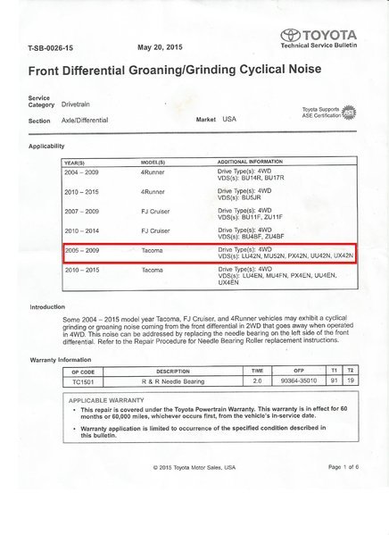

    If you need a copy of the 7 pages, let me know.

    No you won't be fine if your out of warranty. Look at the bottom of the TSB it says covered under 5yr 60k warranty. Unless you have an extended warranty then your out of luck to have it done for free. You could pay the dealer to do the fix though.
