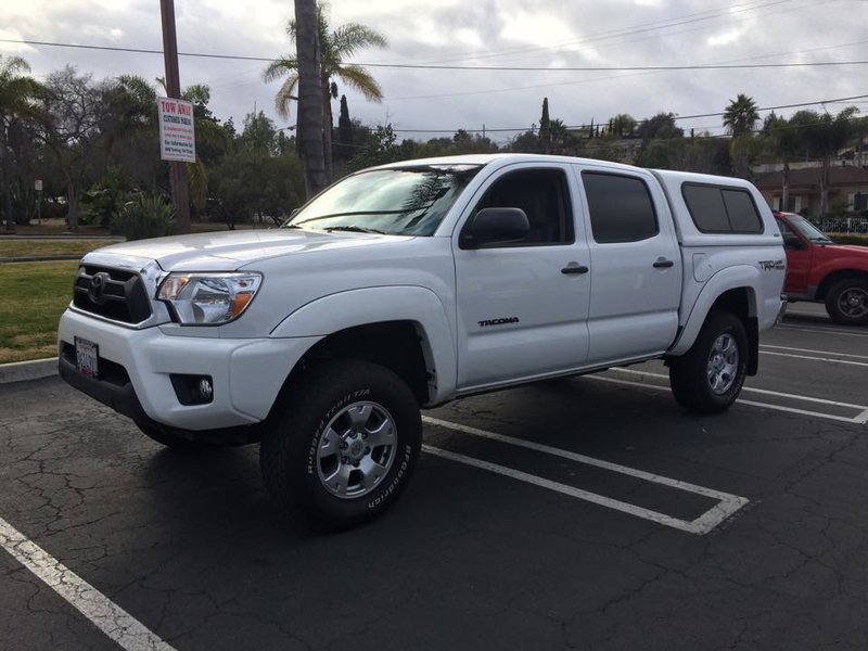

    Check this out.....
    I lifted my 2015 DCSB 4x4 TRD OR about 2 months ago. After a few day's I had gotten the Needle Bearing symptoms. I took my truck in with the TSB in hand. The service tech said we've done these before. Cool.. The tech drove my truck and said with an attitude it was normal and they were not going to do anything. I said I know it is different I drive it every day. I asked if he'd take a ride with me and I would point out the symptoms. He did but he had a major attitude. He said it was normal. I said no it is not. I asked that someone else drive the truck. They had another technician drive the truck that was more familiar with the Tacoma's.
    They came and got me and said we are ordering the parts and will honor the TSB.
    I let the service manager know about the Major attitude I had received and they knew he was an issue. I hope I helped get rid of the bad apple...
    All in All they new my truck had a lift and they honored the TSB.
    It has been a week with no issues.
