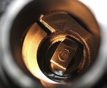

    Was it the ECGS tool that broke? What piece broke?
    5nahalf[OP] and Superdave1.0 like this.

    Yeah, the part that goes behind the bearing snapped in half. Not sure how though, it was straight in there and pulling on the bearing. Got about 4 turns before it snapped.

    Wonder if the insert plate caught on the lip of the diff housing, as cautioned in the ECGS instructions:
    My bearing came out easy-peasey. The bushing took a lot of hammering to go in though. At the time I didn't think about putting it in the freezer.

    I bet that's what happened! The diff started turning right as it broke.
