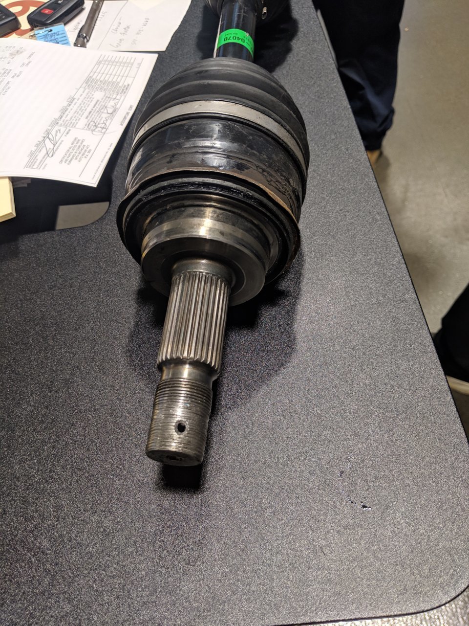

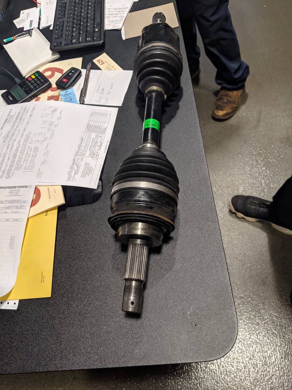

    be picky where you take it. my trusted mechanic f-ed mine up, then pinched the seal re-installing the axle. Ended up having to order a brand new axle to fix the problem. Then the dealership pinched the seal re-installing the brand new axle so they hade to pull it back out to replace the seal.
