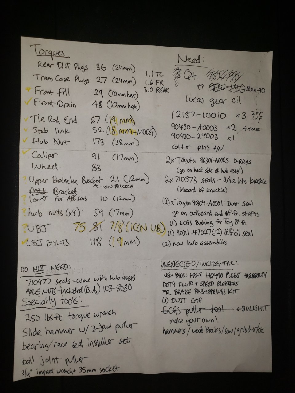

    I am one of those happy customers.
    If you are going to do your bearings, then you'd may as well also do the needle bearing, since you are doing 90% of the work getting to it already. And it doesn't cost a whole lot compared to the hub assemblies. And who knows, maybe it's on its way out too. So then, you might as well also change the diff fluid, since you have to drain some and top it off anyway. And when you get in there, you'll realize you need to change out all the axle seals, especially around the failed bearing(s), because they're shot too. Maybe you discover that your brake pads are paper thin when you pull the caliper, so you order some new pads too. But they don't come with new pins and springs, and yours are pretty rusty, so now you're ordering those too. And what a great time to bleed in some fresh fluid, right? And while you're waiting for those parts to arrive, why not also change the rear diff and t-case fluids?
    And that's how a "quick" project turns into a whole week of ordering and installing parts.
    Here's your cheat sheet for the whole project:
    Good luck!

    Holy crap hahaha. Good call on the CV/ spindle seals though. Mine got damaged so I had to take apart again to replace them because i didnt notice initially.
