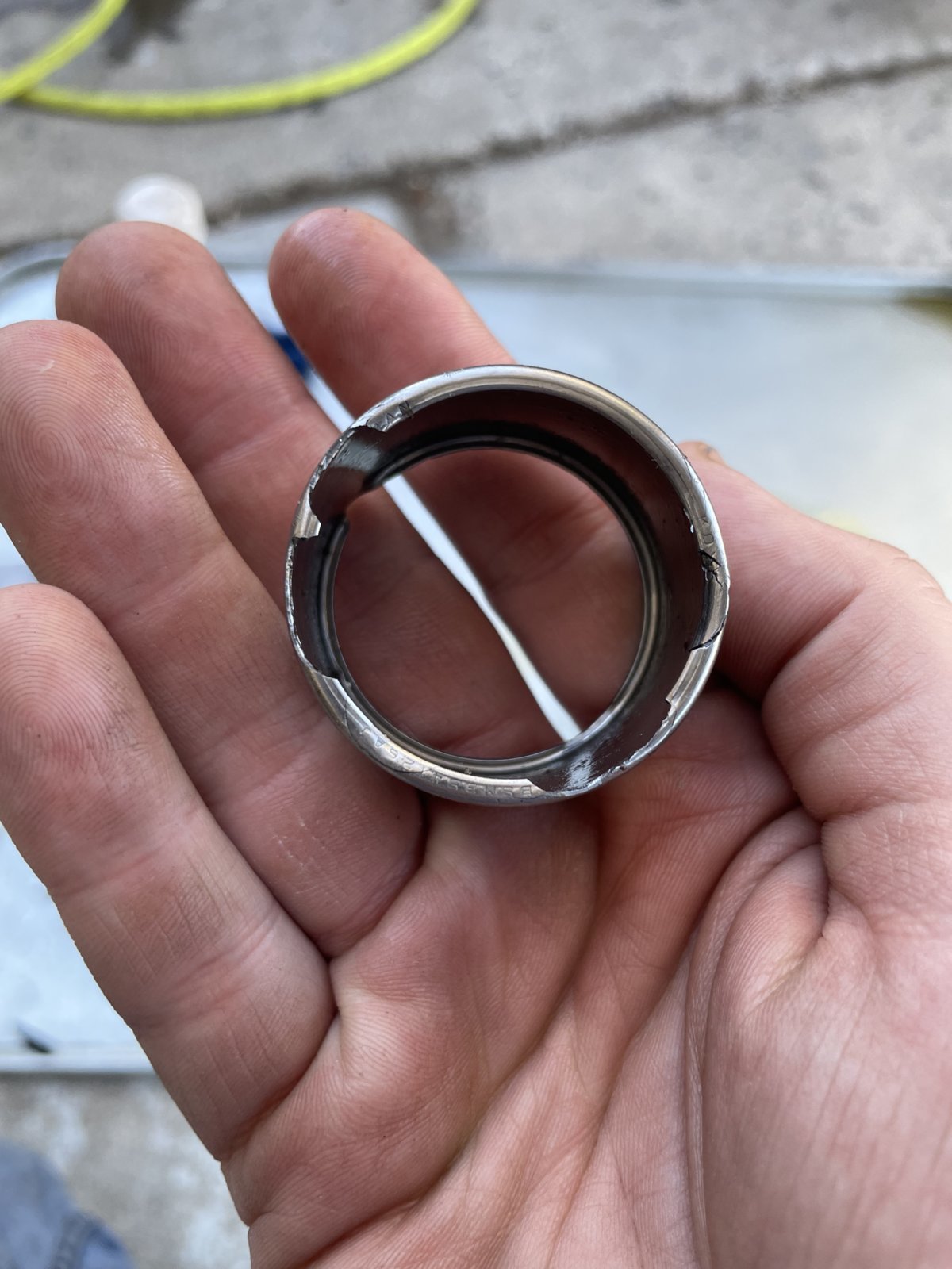

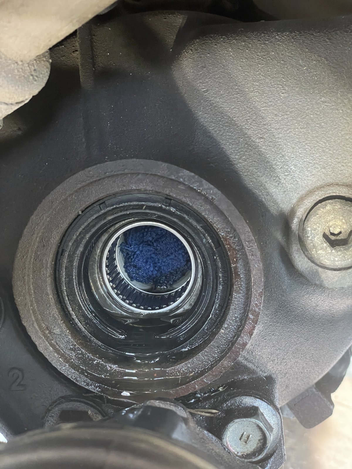

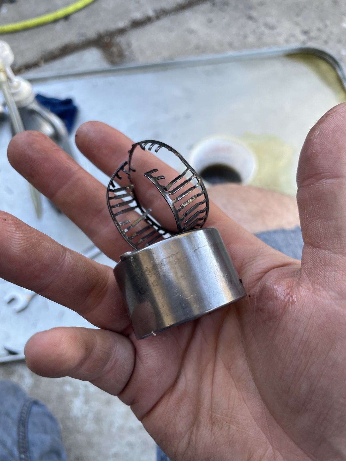

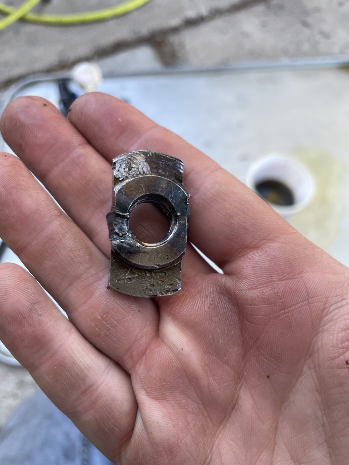

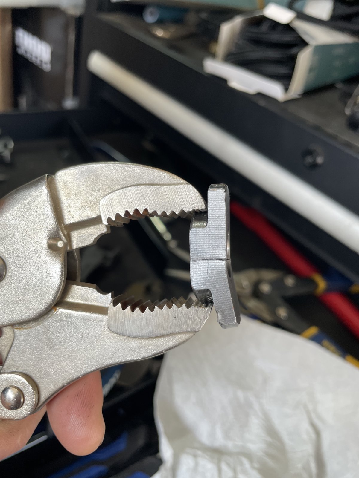

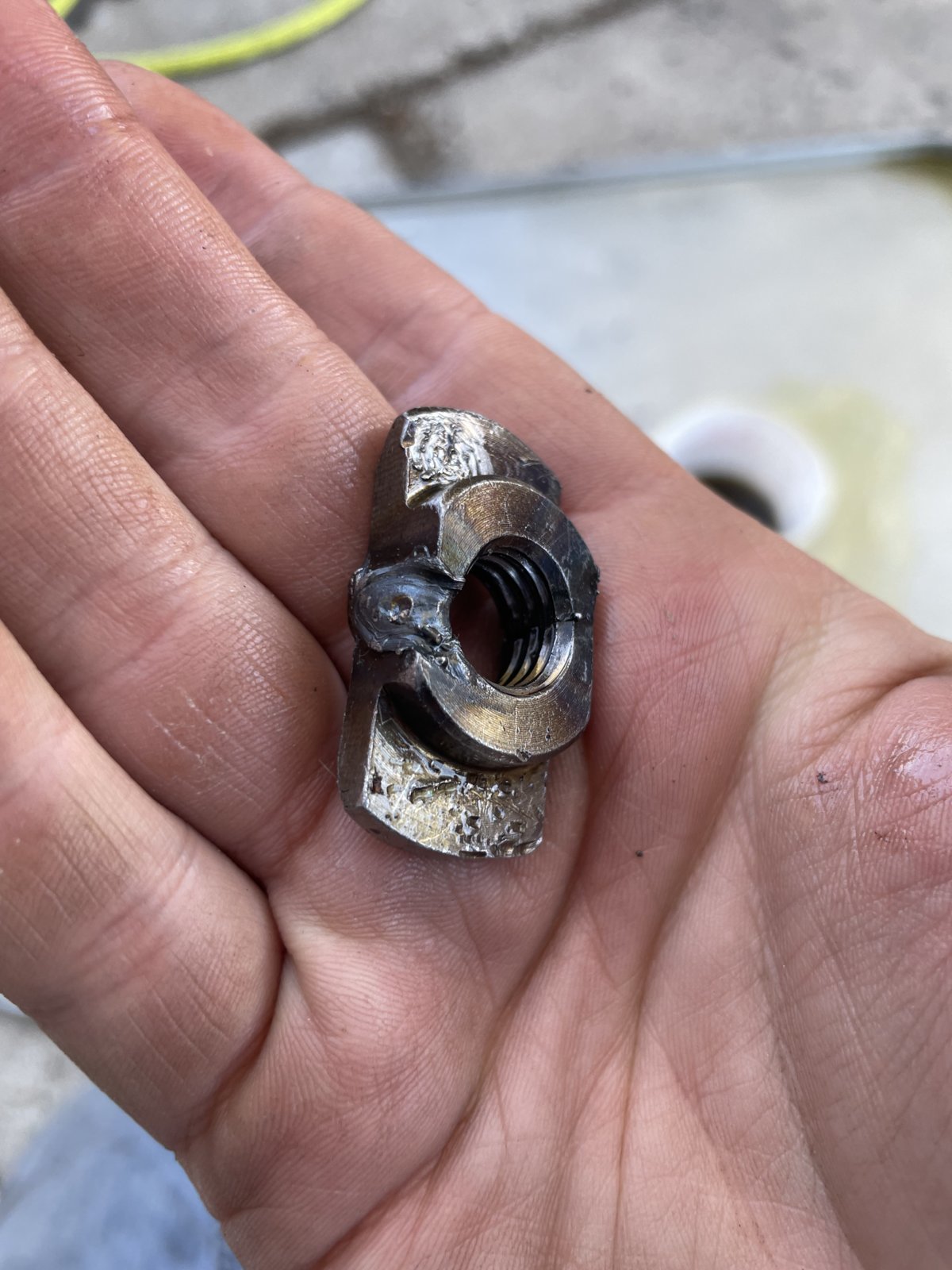

    Problem: So my needle bearing was reallllllyy bad on a 2018 Tacoma DCSB TRD-Off Road. I was able to shake the driver side CV axle by hand and it would rock quite badly. The rotational growling sound that's in the TSB, fixed by going into 4H, the whole deal. Loud vibrations, etc. It was so bad I stopped driving for two weeks. I'm 30 days out of warranty and I have a 1.5" lift, so no fix from the local dealership in Reno (they won't touch any after market stuff).
    So I went the ECGS route. My friend also needed one replaced because he had a severe diff. oil leak, like holy shit it was all over his skid plate, caked up and all over the diff.

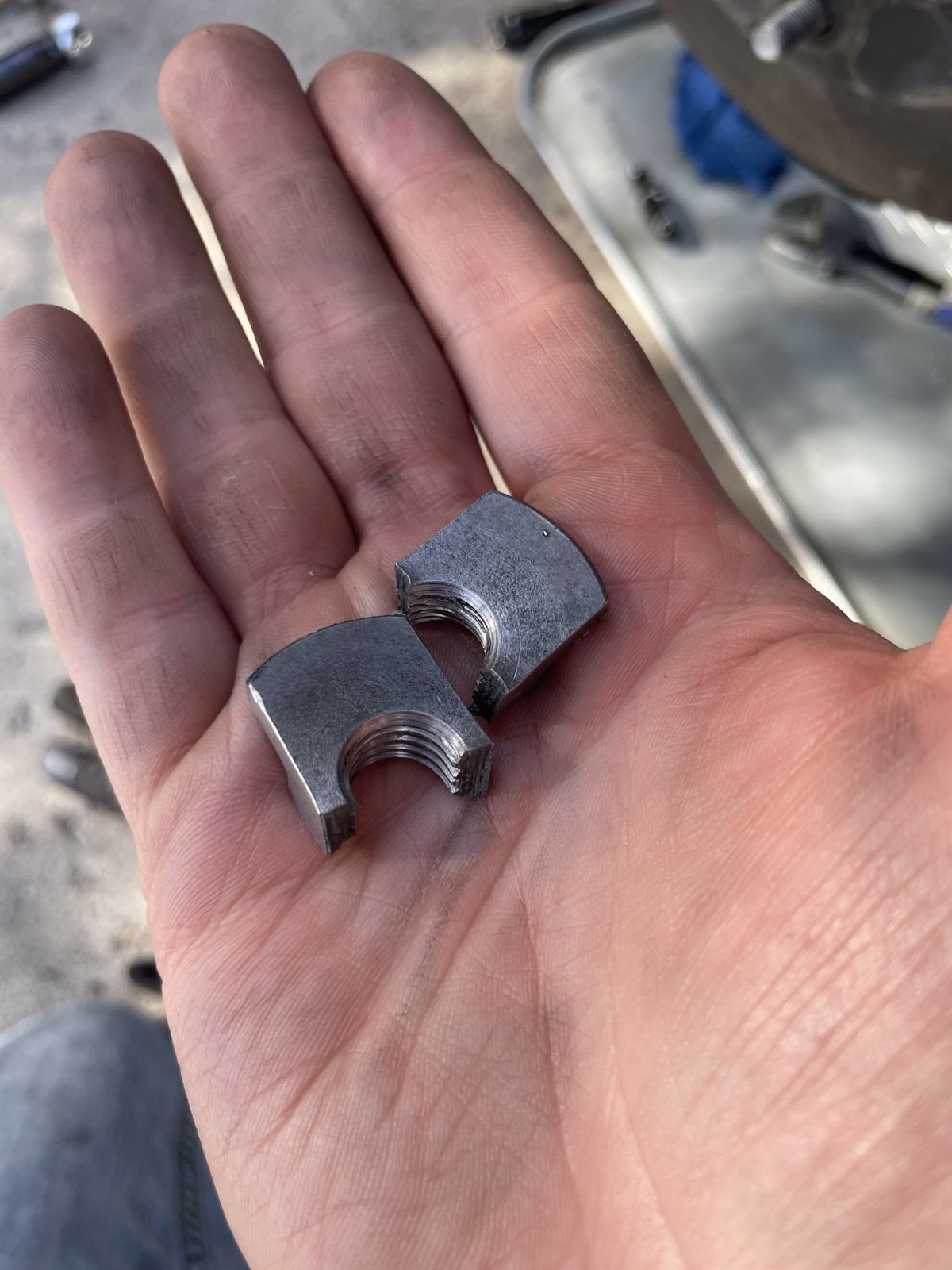

    Fix: So we got to do the *easy* fix. And long-story short, we break the ECGS tool because the tool was too big and didn't fit correctly and we ended up pulling it at an angle.
    Meanwhile, we've torn up the needle bearing in the process so we can't go back. So we try a bunch of rental tools from Autozone and nothing works.
    We finally toss a Hail Mary and have a friend weld it back together.
    In the process of welding it, the tool straightens itself out again and it looks strong. And the threads still work!
    But it still doesn't fit like in the videos!!!!! So we finally grind the edges down and it pops right in just like in the damn videos. And we try it all again and the bearing comes out just like in the videos. I'm dying here, it's like 4 hours into this mess. It was like birthing a baby, so much relief.

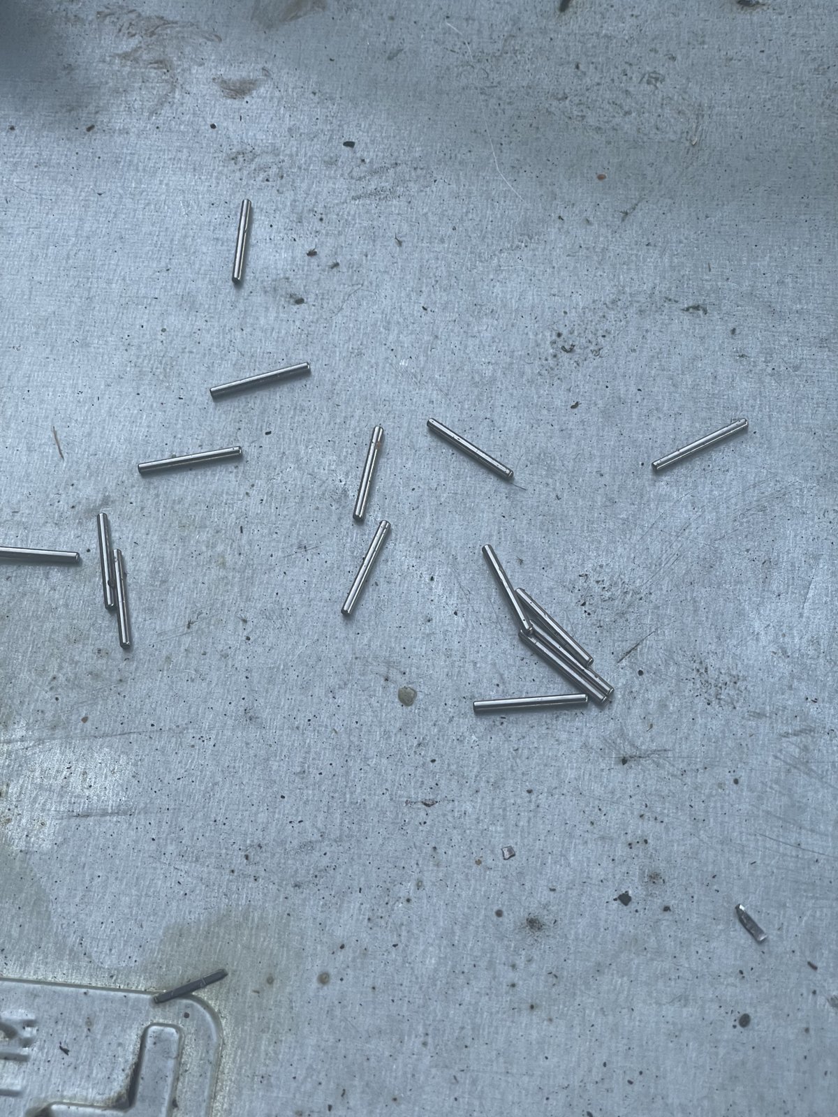

    We magnet al the needles out. So if you need any, let me know.

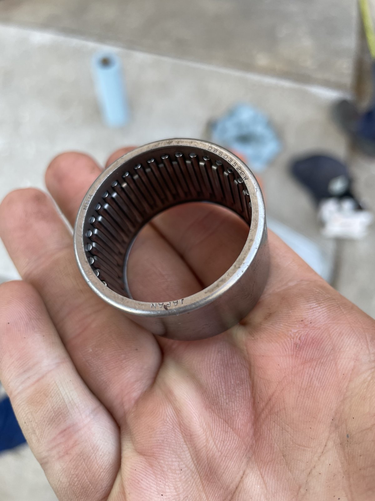

    And the piece of shit is so messed up.
    We're lucky we had enough lip left to pull it out and also what an incredibly breakable piece of shit bearing.
    SOLVED! We pull the seal, put the new bushing in, everything goes perfectly, we put it all back together and BOOM, perfect! No more sounds, no more vibrations, handling and braking feel less "weird." But then my alignment is off. Whatever, I'll fix that later.
    We switch to my friend's truck and it goes so damn easy. The piece slides in, his bearing comes out in perfect shape. Put the new one in. We see that his seal is punched in deep and that's why he lost almost a quart of oil! In the picture below the seal should be flush with second rim. But it's just shoved deep inside. We replace his, done in 90 minutes flat.
    The lesson here is: If the ECGS tool doesn't immediately fit as it does in the video, file it or grind it down around the edges and or corners lightly. We used an angle grinder with the wire brush attachment, not the wheel. We were able to "Tap it in" using a long file and a picture hanging hammer just like in ECGS's videos. Don't force it. Don't let it go in at an angle. Make sure it's perfectly square or it won't work. That was our bad for trying to make it work but also I'm pretty mad that ECGS's tool wasn't fitted and fucked this up so much.
    Thanks for coming to my TED talk. Good luck out there.

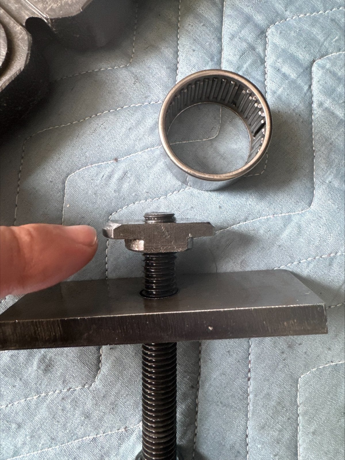

    I built my own puller with a piece of threaded rod and a couple nuts for less than $10.00. I just did this swap today and it is a mother alright. The potential for disaster looms at every corner of this job. I'm still trying to figure out how to get the fill plug out.

    How did you make your tool? I'm having issues getting my bearing out and was thinking about making my own tool as well.

    i basically copied the design from the tool you can buy. 1st, You need a welder. I used the replacement bushing for a stencil, traced it's outside diameter on a piece of 1/4 steel plate. Cut it out, drilled it direct center and welded a nut to it. Cut another piece of plate ( with a hole through center) to fit against the outside of the diff housing (this piece you may need to double up as all the pulling force is on this plate). Place the first piece through your needle bearing with the nut facing out. You may need to do some trimming to the piece in order to get it in. Then threaded rod into the piece, 2nd plate onto the rod to go against the diff surface, then a nut on the rod and tighten that nut, keeping the rod stationary. Youtube the process. It can take a few attempts. The key to the process is getting the first piece to sit perfectly against the collar of your needle bearing only, and not touching the inner diff case at all. Not gonna lie, on an older truck in the rust belt, it can suck onions.
