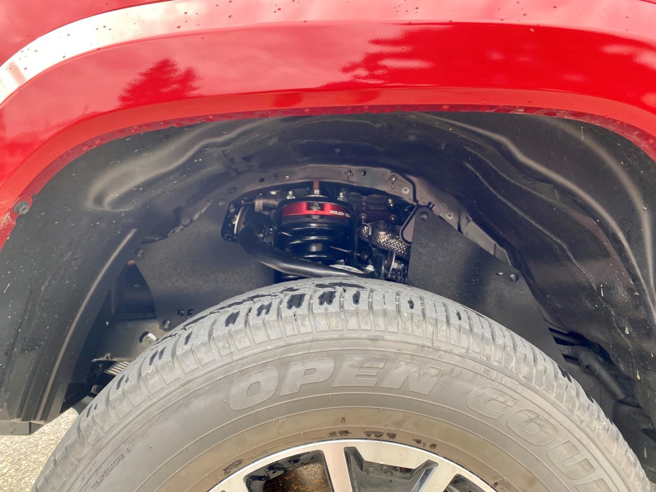

    I installed a 2" RC spacer lift (To hold me over until I can go Eibach Pro) on my 2020 Tacoma TRD Sport 6MT about 2,000kms ago. Truck only has 5,400kms now and I have started to develop a vibration and worry it is the needle bearing going. The strange part is I only notice the vibration when the truck is cold and going over 50-60mph. Once it warms up I do not notice it. Truck was at the dealership for unrelated warranty work and they did a complimentary alignment check and said everything is in spec. I plan to double check all the bolts and such this weekend but wanted to see if anyone else has run into this. Truck drives as it should other than this!
