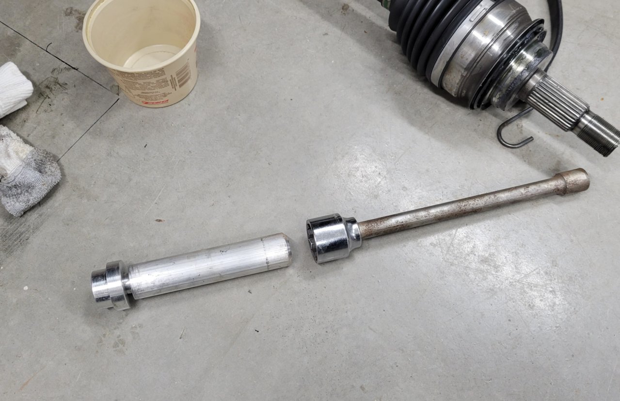

    I did mine in my '23 at 529 miles while I installed 5100's. The tools are a must have IMO..... buy them and resell them or find someone that will loan/rent them to you(what I did). I highly recommend the insertion tool too to help drive the bushing in straight(bushing is very tight).
    My OEM bearing pulled out slicker than snot using the ECGS puller. The nut that pulls the bearing out was a little tricky getting it into position but not too bad. I used a magnet. Don't forget to use something to keep from loosing the nut inside the diff. Have at least a half a quart of 75w90 on hand to add back. Of course, this is a great time to change fluid if you have some miles on your truck.
    I used a ratchet and multiple extensions to remove OEM bearing.
    I had the ECGS bushing in freezer for hours and it was still pretty tight. This insertion tool is one that i made. I ended up using a 1-1/4" socket over the end of the tool with an extension to make it easier to strike with a hammer.

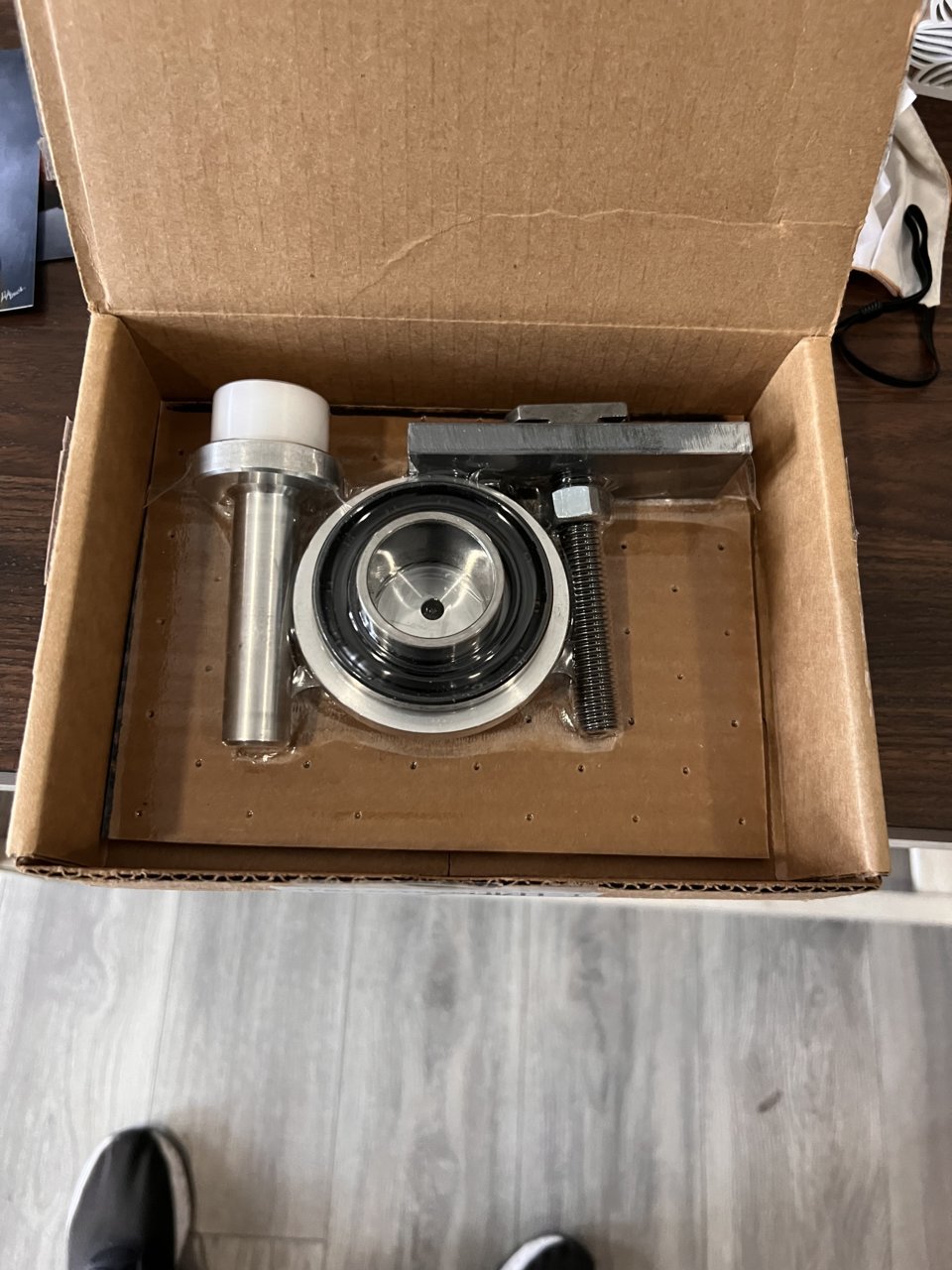

    I got my kit from ecgs, now to look for a shop in socal that can get me a decent price for labor. Also having whatever shop does this install my upper control arms and get another alignment done.

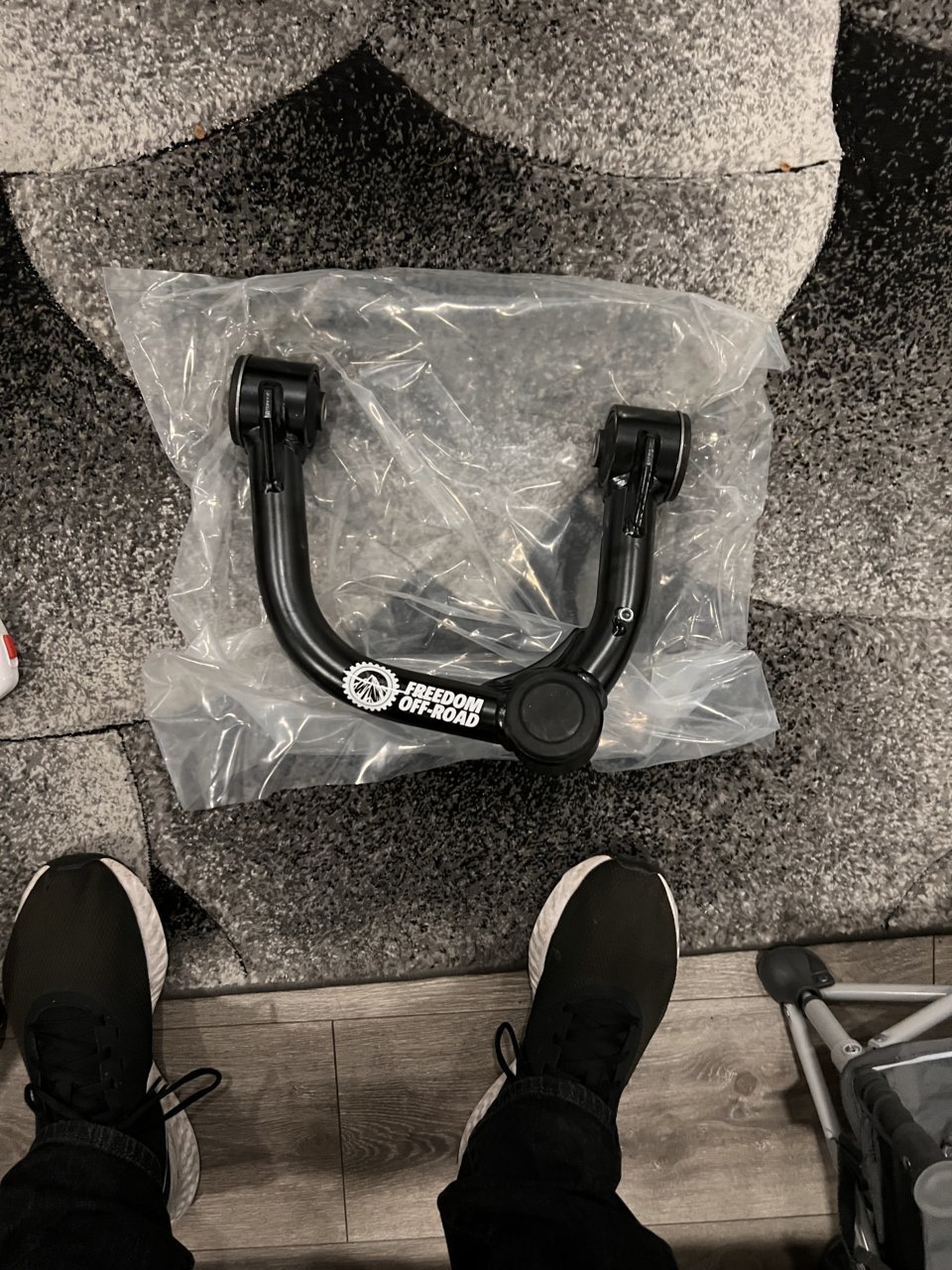

    Just got a quote from Miyaki motor sports in El Monte he quoted me 340 for the needle bearing replacement not as bad as other spots JBM offroad wants 495 for the labor cost. Miyaki priced me at 580 for uppers, alignment and ecgs install not bad but he’s booked out. I made an appointment for mid April will see if I can get in anywhere else sooner and for close to what he’s charging.
