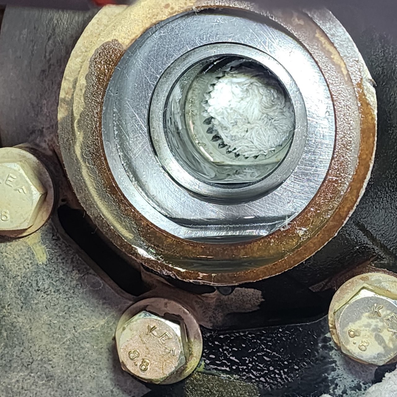

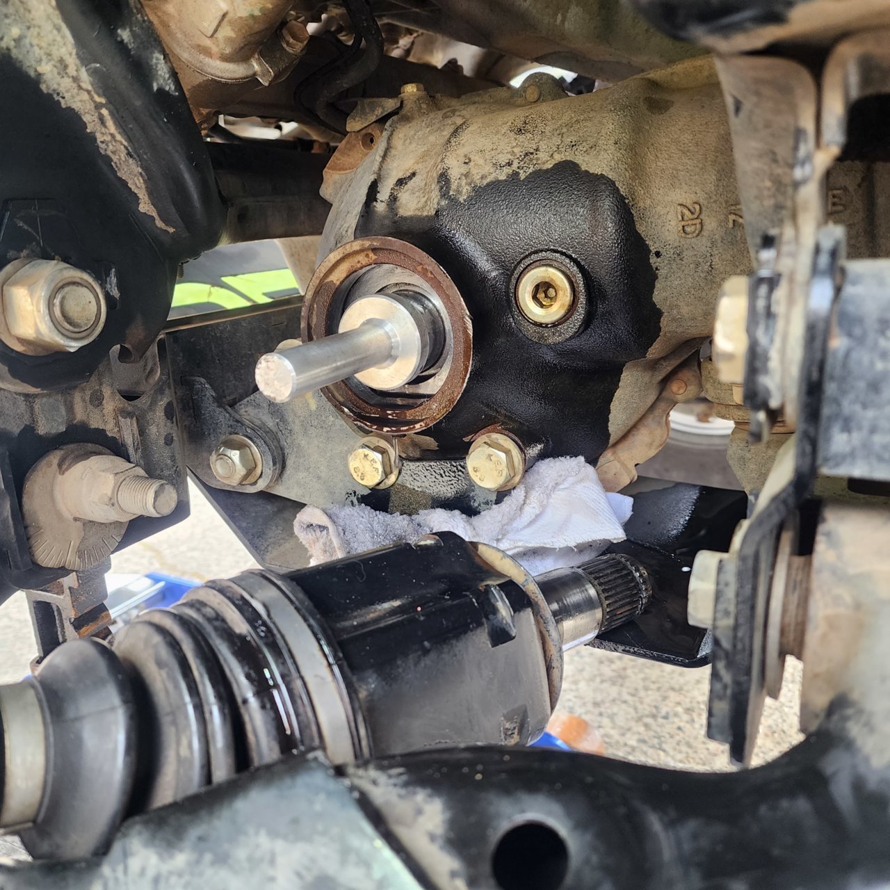

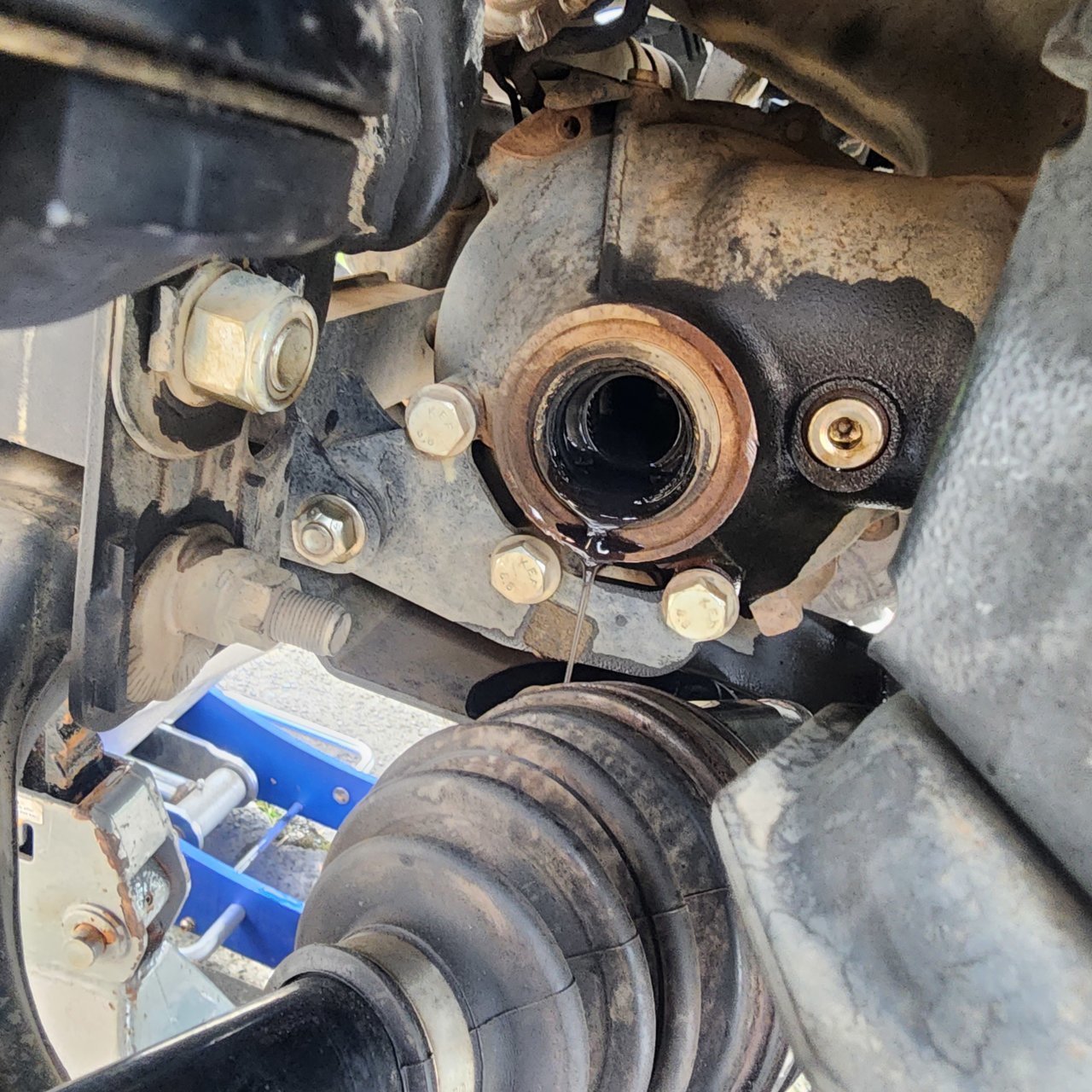

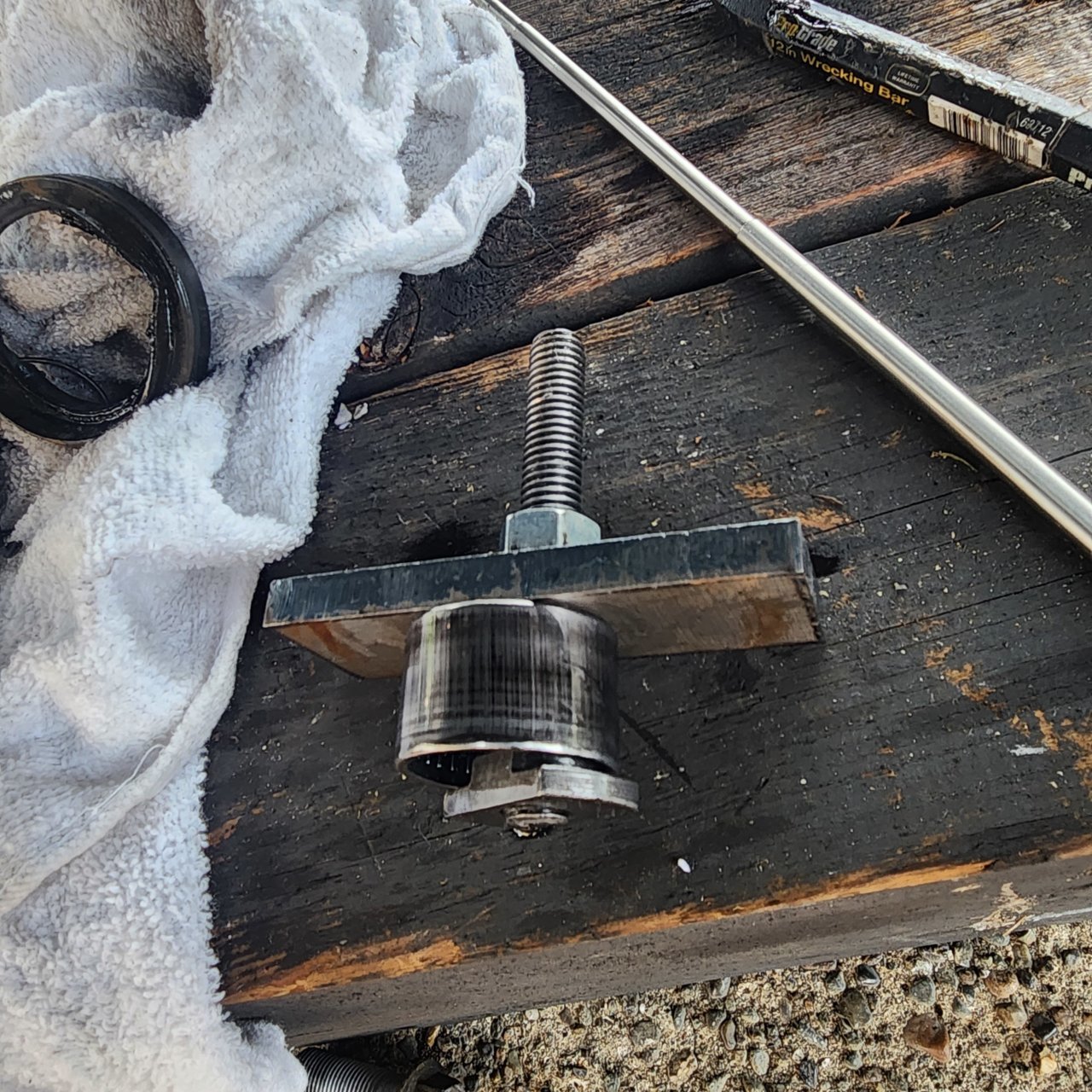

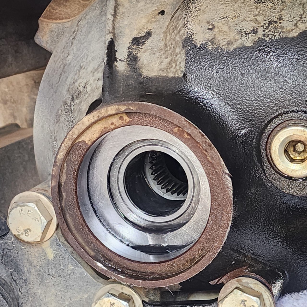

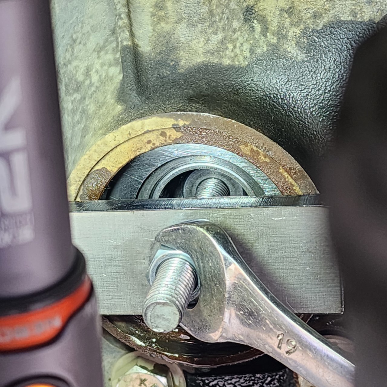

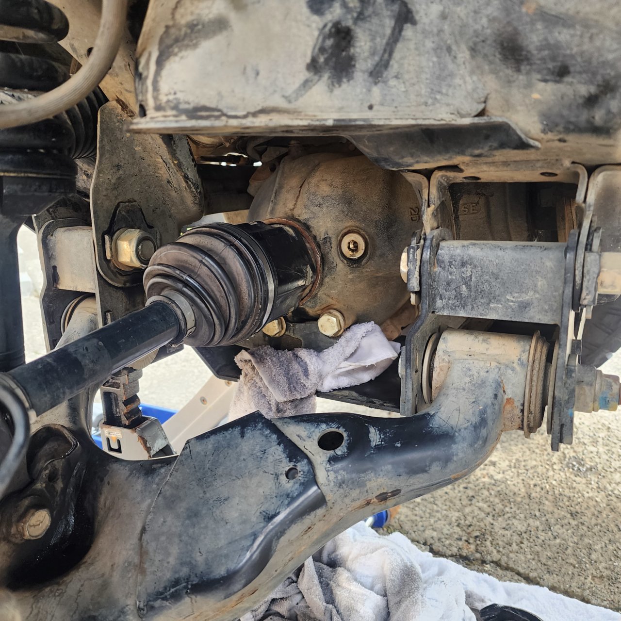

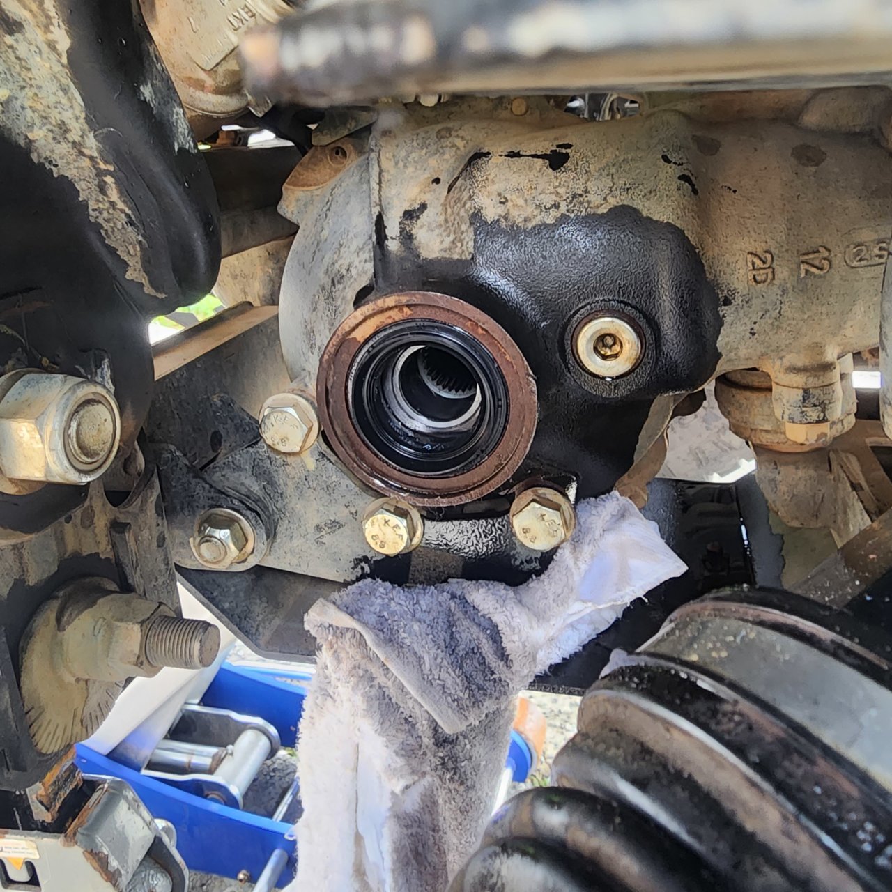

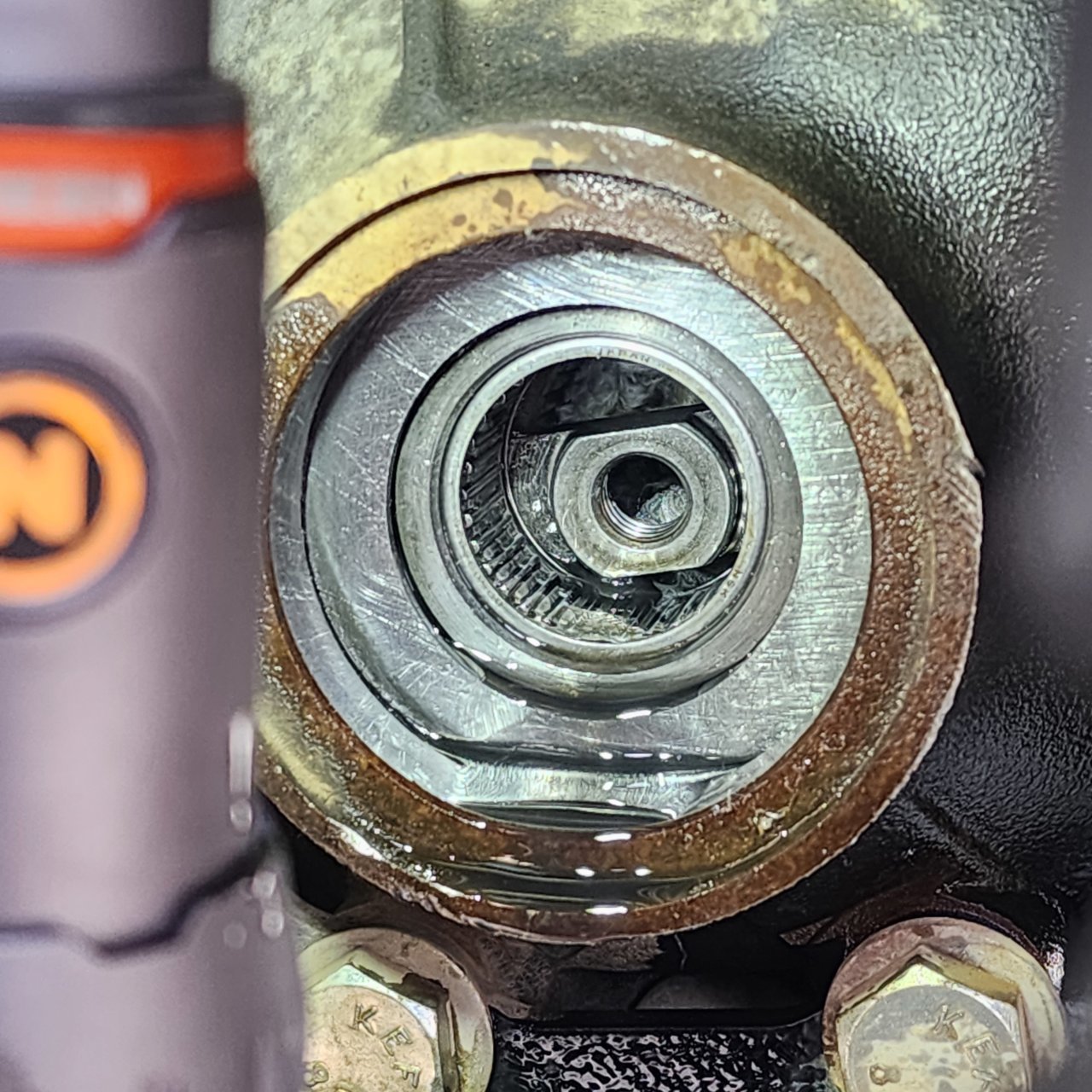

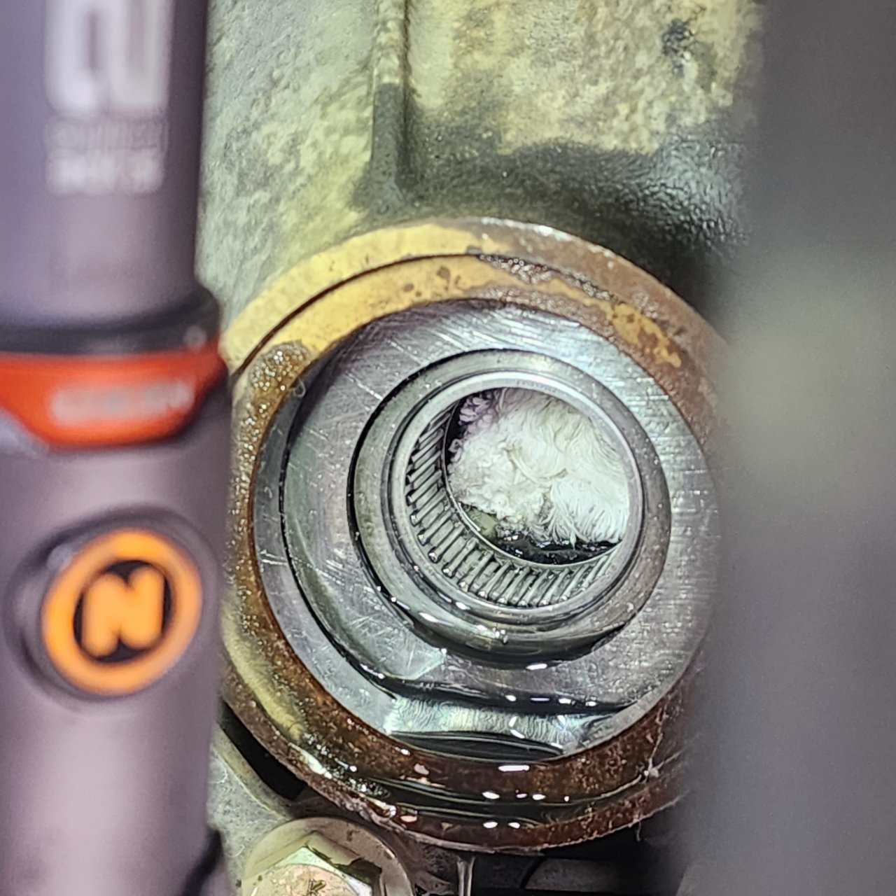

    I just swapped my needle bearing out for the bushing this weekend at 127000 miles. While I was at it, I changed oil in both diffs, greased the drive shafts, and put on new rotors, and pads. The tools from ecgs are ok, but the removal tool needs to be ground smaller so it will fit, and I'd recommend Getting a seal remover to take out the old seal. Pretty easy job.
    Metalguy
    Dryvah and Superdave1.0 like this.
