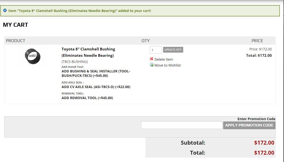

    wait, am I getting something incorrect?
    with the tools needed(?), it comes out nearly $200.

    Nope…that is correct with the bushing, new seal, the removal tool, the bushing install tool, and the seal tool. You can remove some of the tools and the seal for savings, if you want.
    Don’t forget to find the TW coupon code for free shipping…
