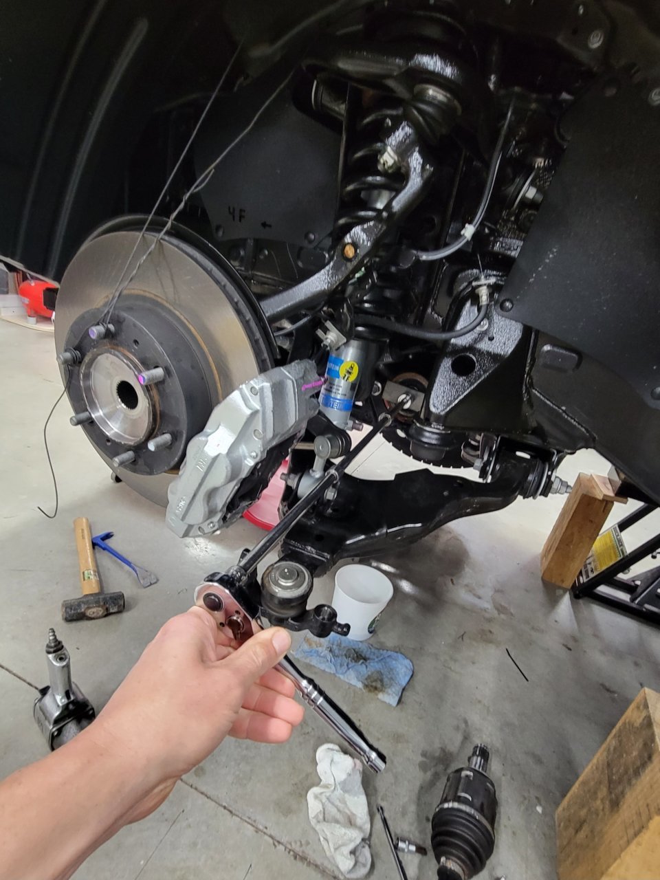

    I did a 1.5" lift via 5100's and 3AAL on my '23 TRD OR at 520 miles and replaced the needle bearing with ECGS while I had it apart. I read too many stories and have seen too many videos about failures to ignore the possible problem. I consider this a must do for even a mildly lifted truck. Yes, some(possibly many) folks get lucky. But ask yourself one question... do you feel lucky..... well do you... punk? :quickdraw:

    I agree with this. The photo I posted on post #268 shows what your explaining. The brake hose bracket bolt, axle nut, LBJ bolts and sway bar end link are all that has to come off. The axle nut is the only one that might be considered tricky due to the breaking it loose and torqueing it to 174 ft/lbs.
    Also, here's a photos that shows what I used as an extension to drive the bushing in. I think the ECGS insertion tool likely has a smaller diameter shaft so this socket would be smaller on it.
