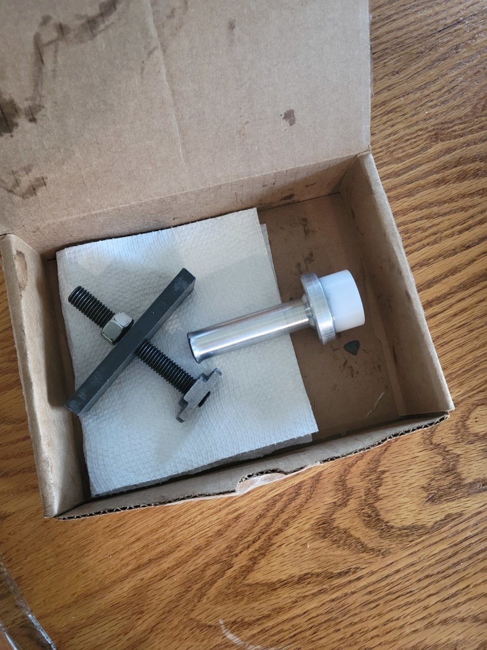

    My mechanic did mine today. That slight vibration around 55 is gone.
    I have an install and remover kit.
  13. May 9, 2023 at 2:29 PM
    #313

    Installer was $30 and remover was $45- make an offer.
    edit: he ground a few millimeters off the remover piece that goes behind the stock needle bearing. I've seen others do this to get it to fit best and get the OEM bearing out.

    For those that have modified the tool to get it to go behind the bearing easier, did you grind all four corners of the piece that goes behind the bearing? Do you chamfer just the edges that touch the bearing? My tool just came in the mail yesterday, so im gonna get mine done before i do my lift, pictures of modifications to the tool would help:)
