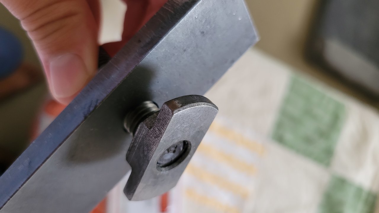

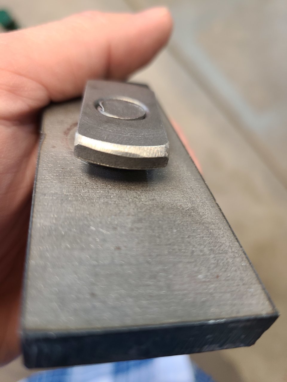

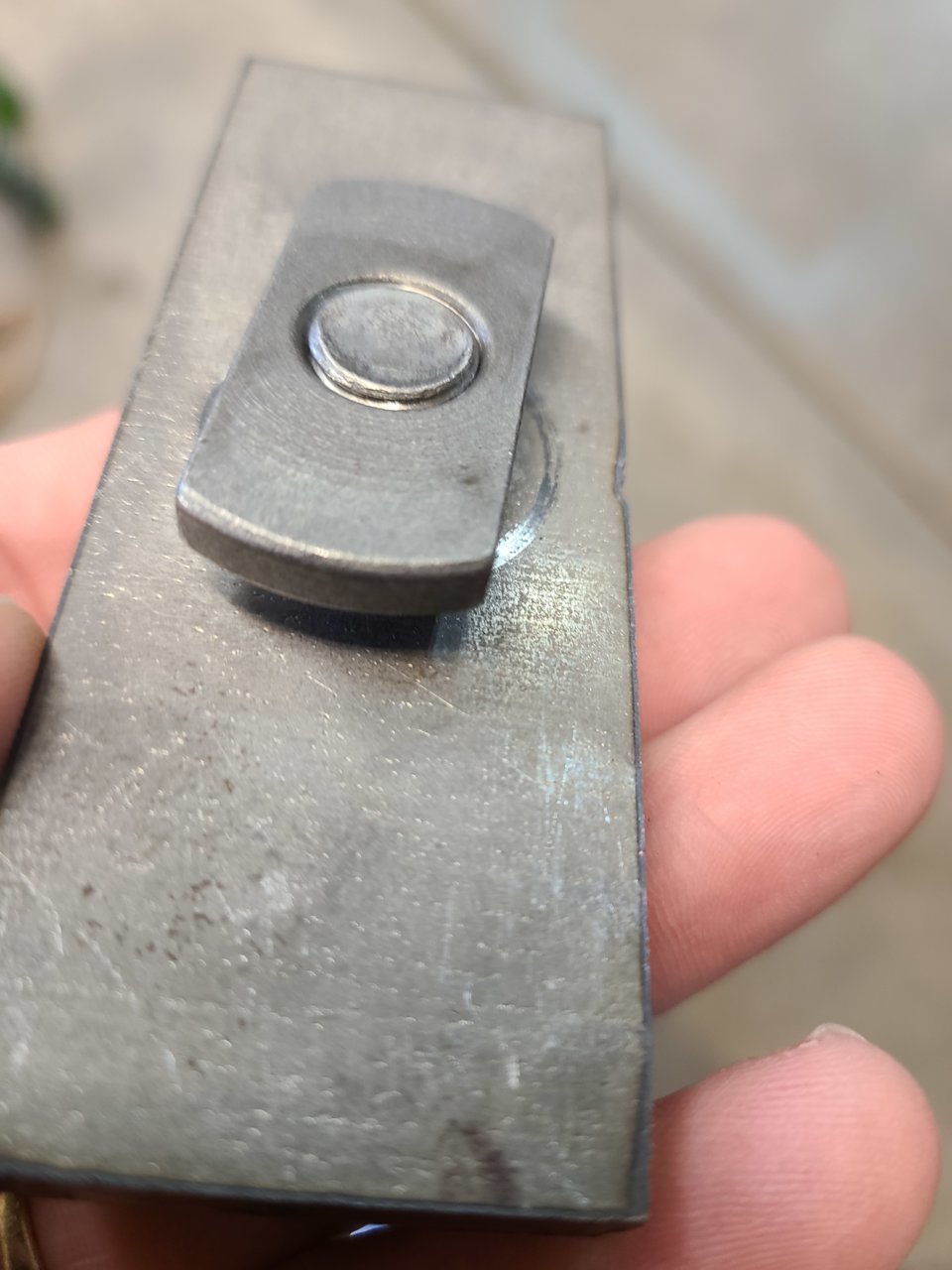

    I just chamfer a tiny bit and maybe round off the corners a touch You may not have to... It just depends on where your bearing is set etc. I have two tools, one is chamfered and one is not and I use the unmodified one most of the time. Just depends on the diff.

    So did you chamfer just the one side shown in the pic, or the other side too?

    Both sides

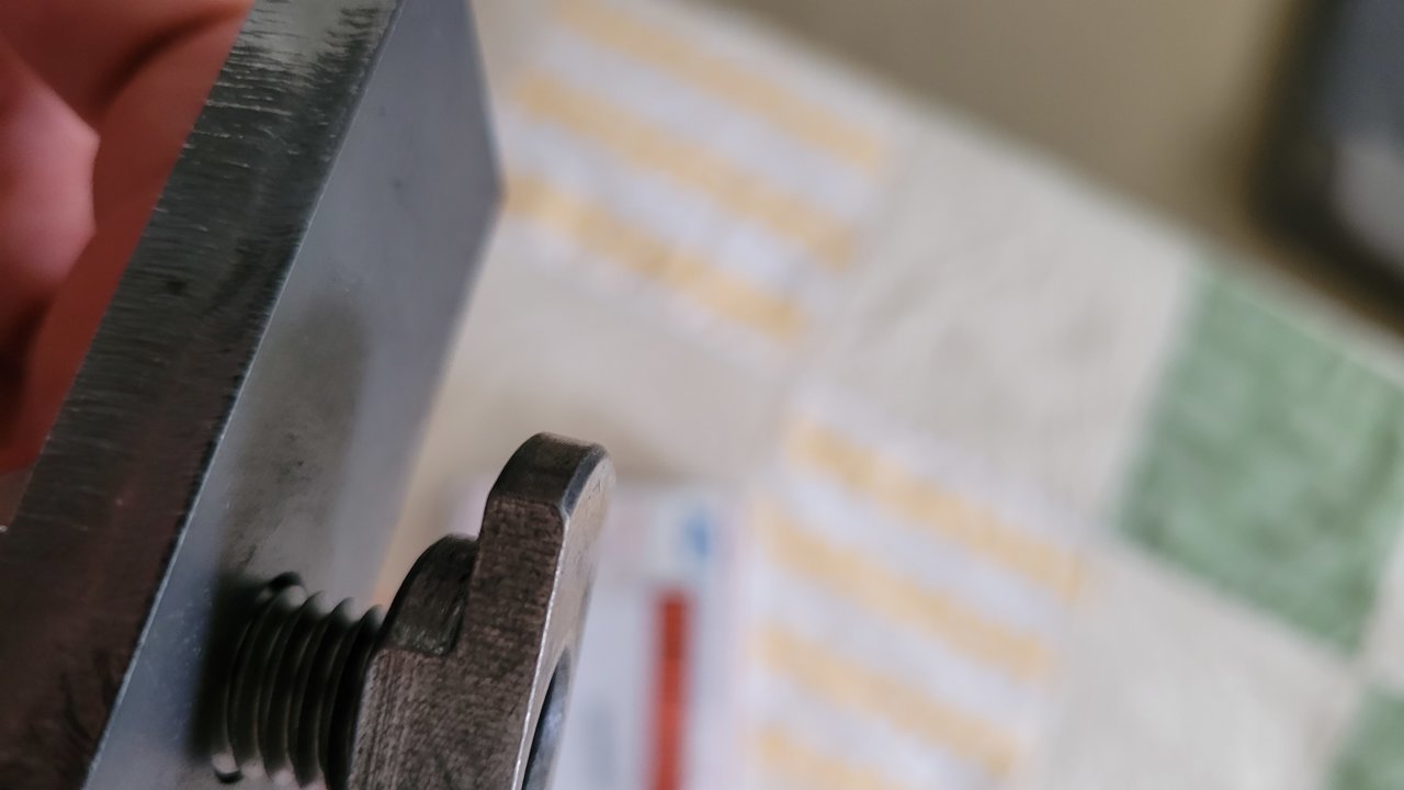

    Thank you! Just got my tool in the mail and it kinda looks like the back side is beveled a tiny bit, maybe they updated their design? Ill try it how it is, and grind it down if i need to

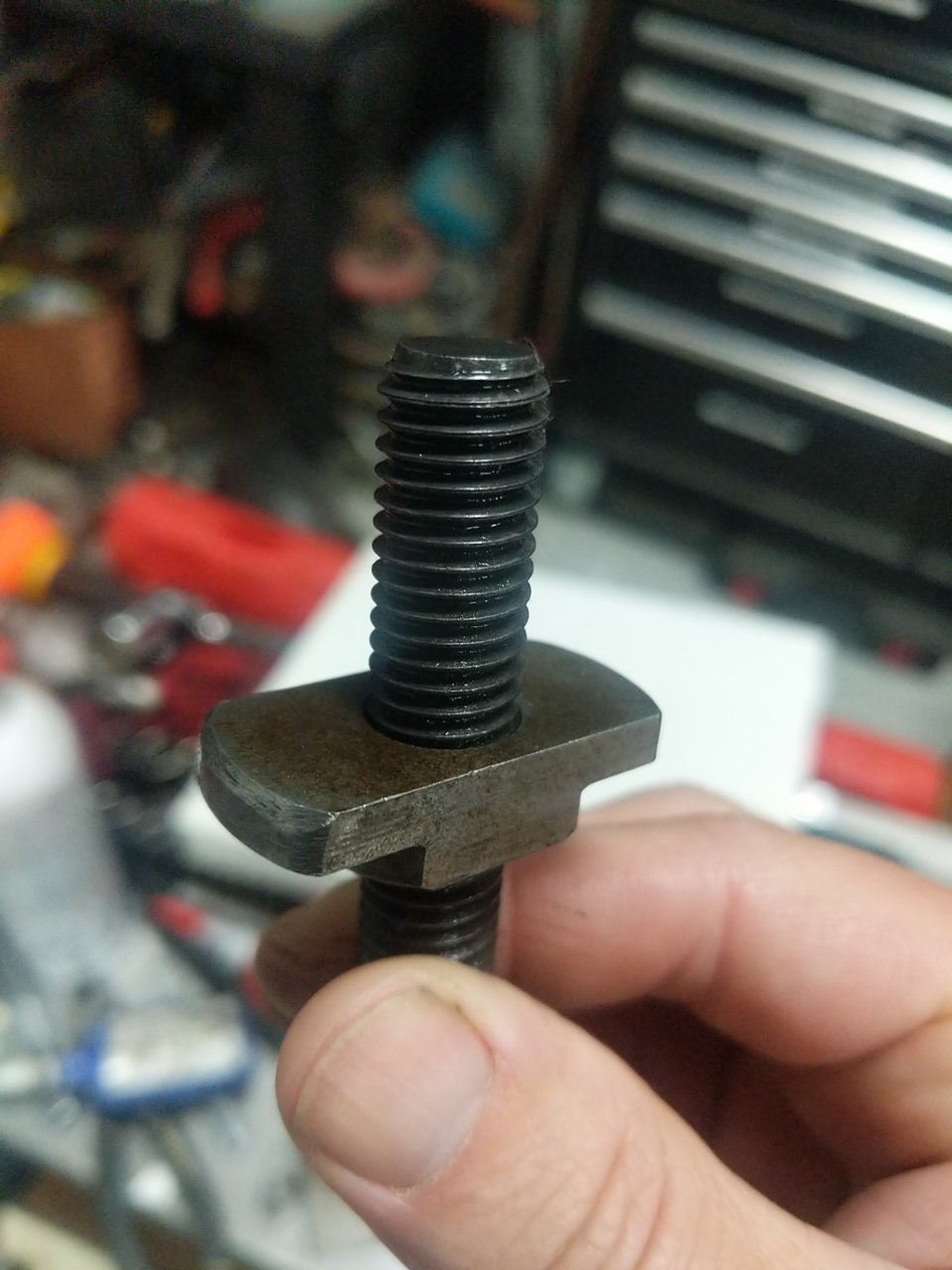

    Show a pic, of their chamfer. Thx.

    Not sure if all the tools look like this, its very subtle 20230516_155427.jpg 20230516_155438.jpg

    I hit all sides with a flap wheel. It didn't take much.

    Here's what mine looks like, I still had to tap it in. I hit it with a grinder.

    I only had to do one side to get mine to work...

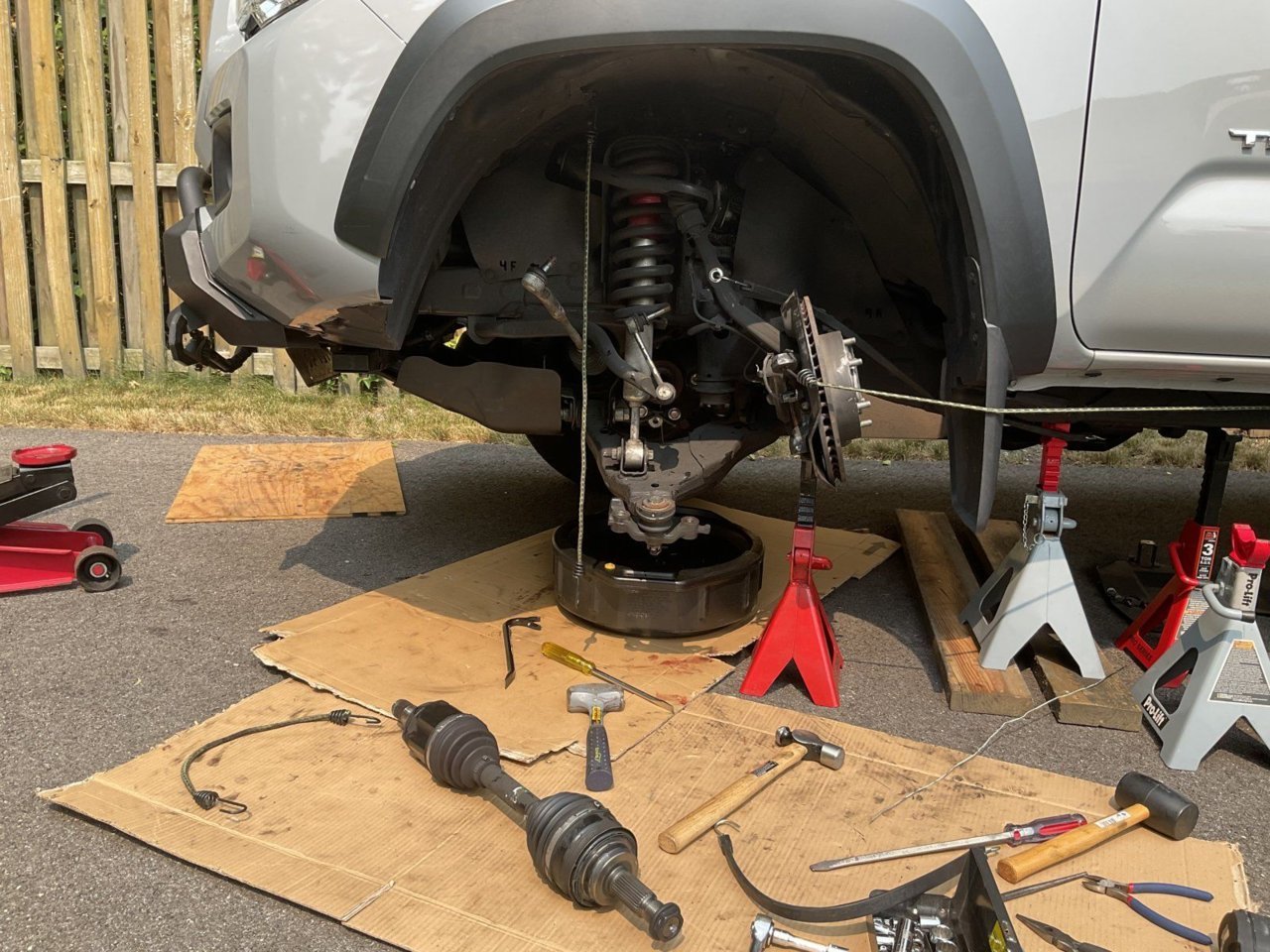

    Replaced my needle bearing yesterday with the ECGS bushing. Also installed a new seal. Lifted my truck 2" a little over a year ago, and decided to go ahead and just do the ECGS now while the weather was not too hot or cold.
    I had some slight buzzy vibration start to develop, in the driver's side floorboard and accelerator pedal that "seemed" to go away after I put it in 4x4. The same vibrations are still there though after the R&R of this needle bearing. So could be the tires. They are the original Goodyear Kevlar's and now going on 5 years old and getting worn.
    Took me about 4 hours to do it, was working by myself so didn't have an extra pair of hands. Bungee cords helped me keep the CV axle suspended in a nice, horizontal position while I tapped it out and back into the differential. The ECGS install tools definitely made things easier, I also used their puck to install a new oil seal.
    Only remarkable thing about this surgery, is that my C-clip on the CV axle seemed to be a bit "chewed" and I've never seen that before in other videos. It's still functional. Could've just been a result of it getting tapped out past the splines. It's didn't take a lot of force to hammer it out or getting it back in. Just gotta rotate the CV a little bit each time until that C-clip is in a good position to allow it to compress and allow movement.
    Watched every YouTube video I could find for this enhancement. The below video is the one I followed for the most part:

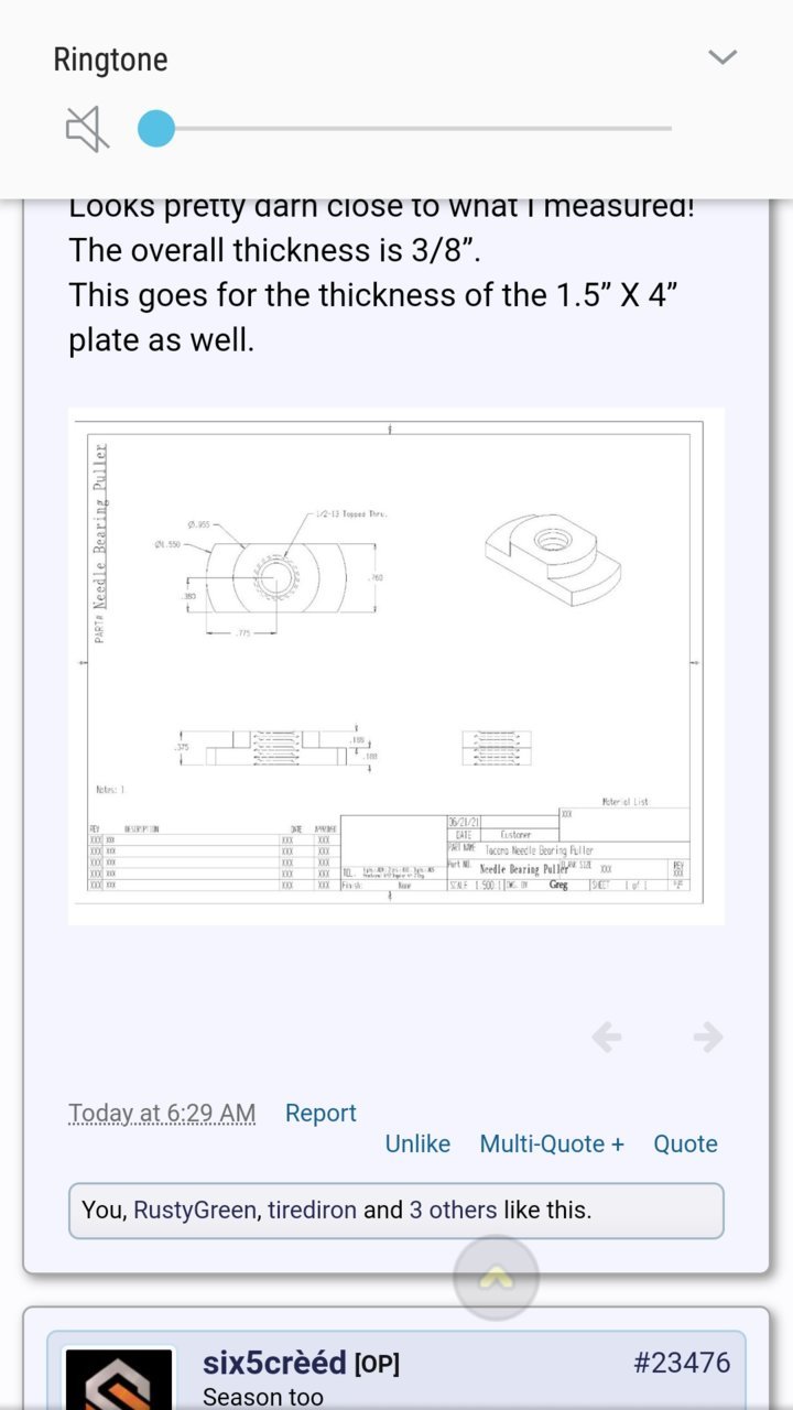

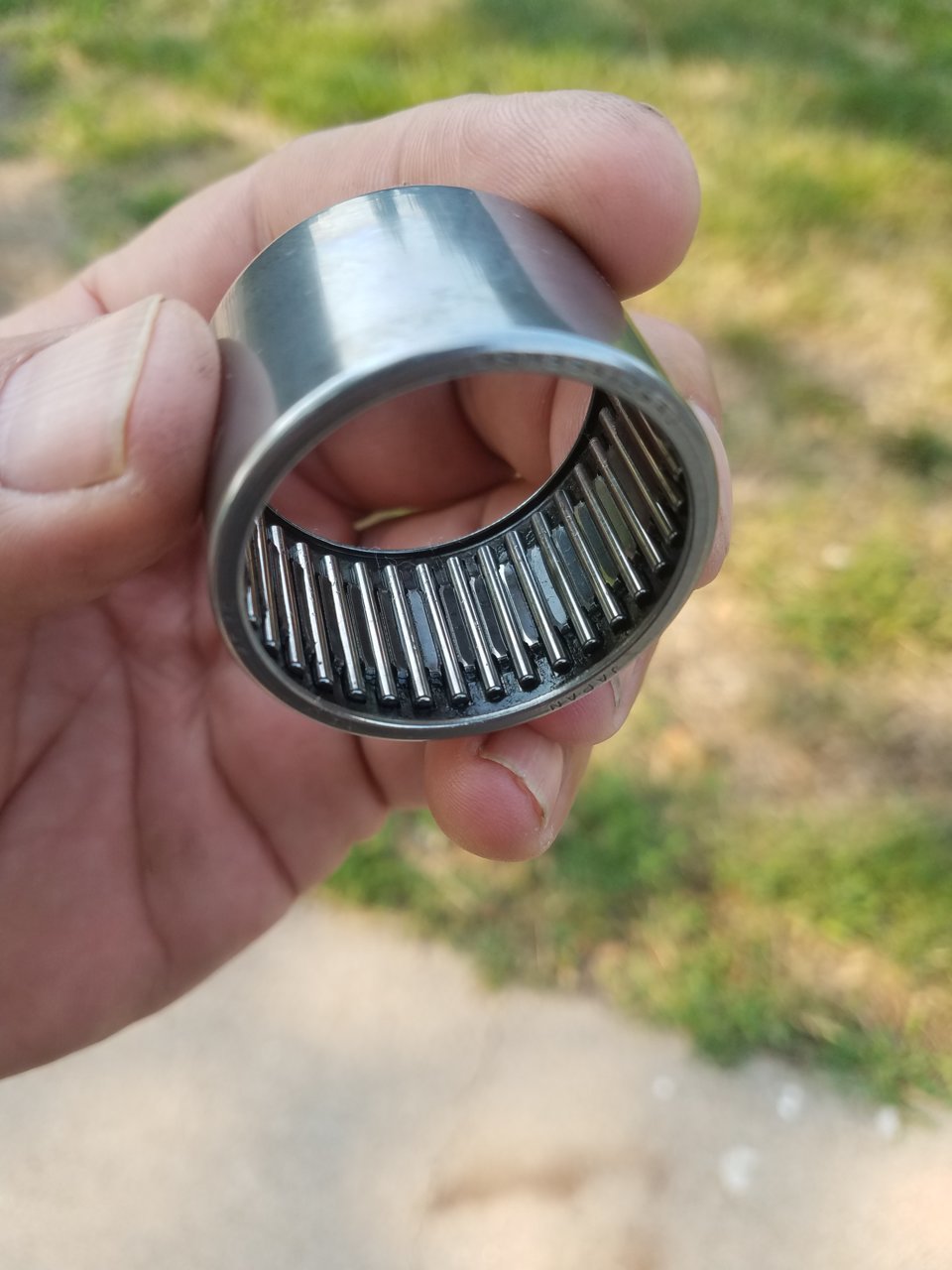

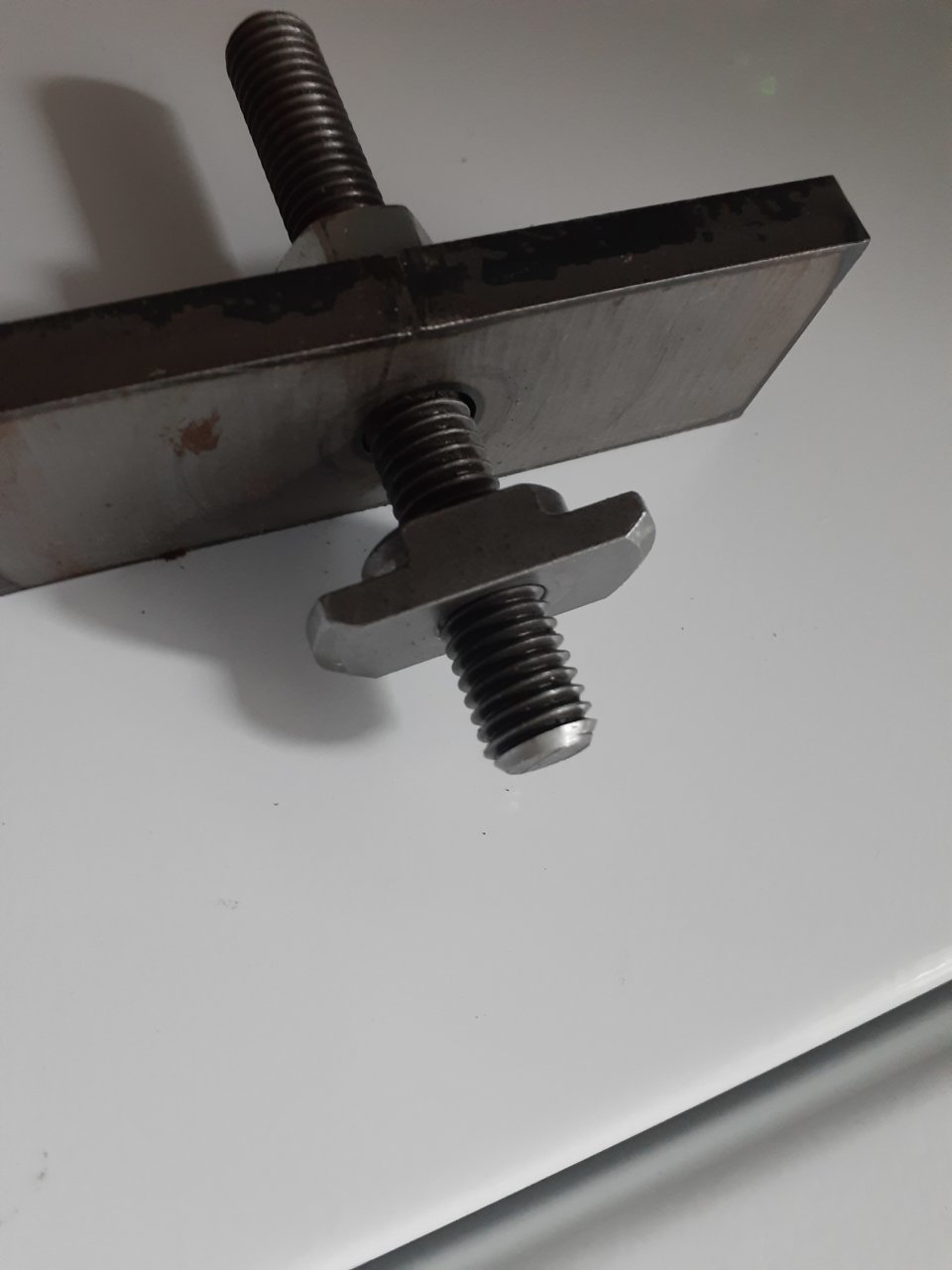

    Picture of bearing post lift after ~60k miles and sketch of tool for DIY

    Good job! Seems like a daunting task, but isn't really that hard once you get going. I was mostly worried about not getting the tool straight and breaking it trying to pull the needle bearing out like I've seen happen to others. Once the needle bearing came out i knew it was smooth sailing from there. Did you top of the diff fluid after you finished?

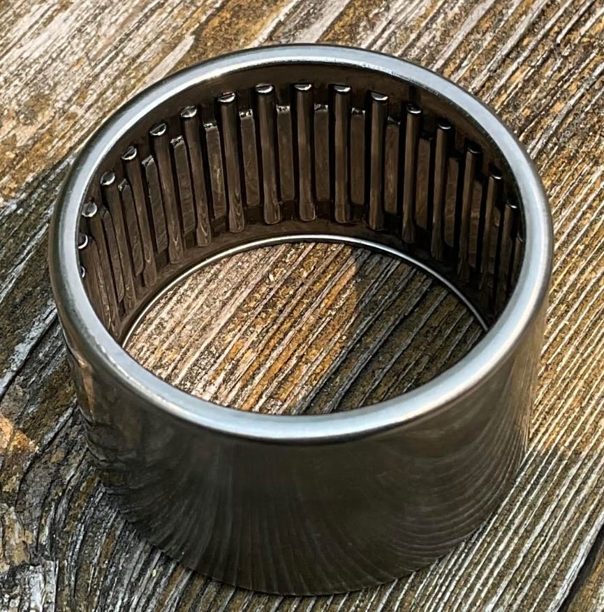

    Here is a pic of my needle bearing. No appreciable wear on it. The CV shaft on which it rode, was stained a little blue which I imagine was long time frictional pressure.
