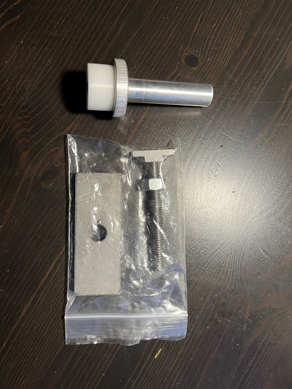

    Sir! May I borrow it please! Of course I'll send it to the next!

    Yes! PM me your address and I will drop it in the mail this evening when I get home.

    Can I use it after you're done? Going to be putting on my lift and replacing the bearing within the next month. Will also send it out to the next person who needs it.

    I sent it off to treetop89, he hasn't seen the message yet, but I'm sure he'll send it your way when he's done!
