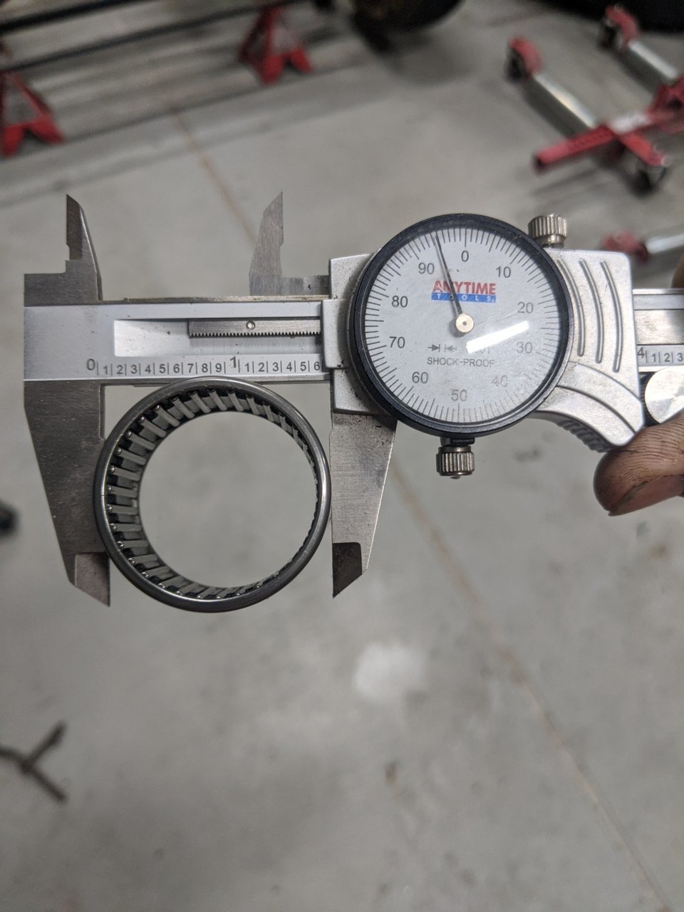

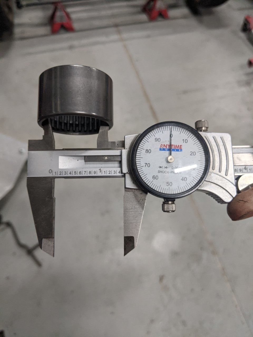

    If you figure this out for certain, ideally w/ calipers to the thousandth of an inch, please share here. I have a set of bearing pullers & seal insertion tools already & would rather use those if they'll work, vs. paying for ECGS's special tool.

    Inner 1.400", outter 1.595"

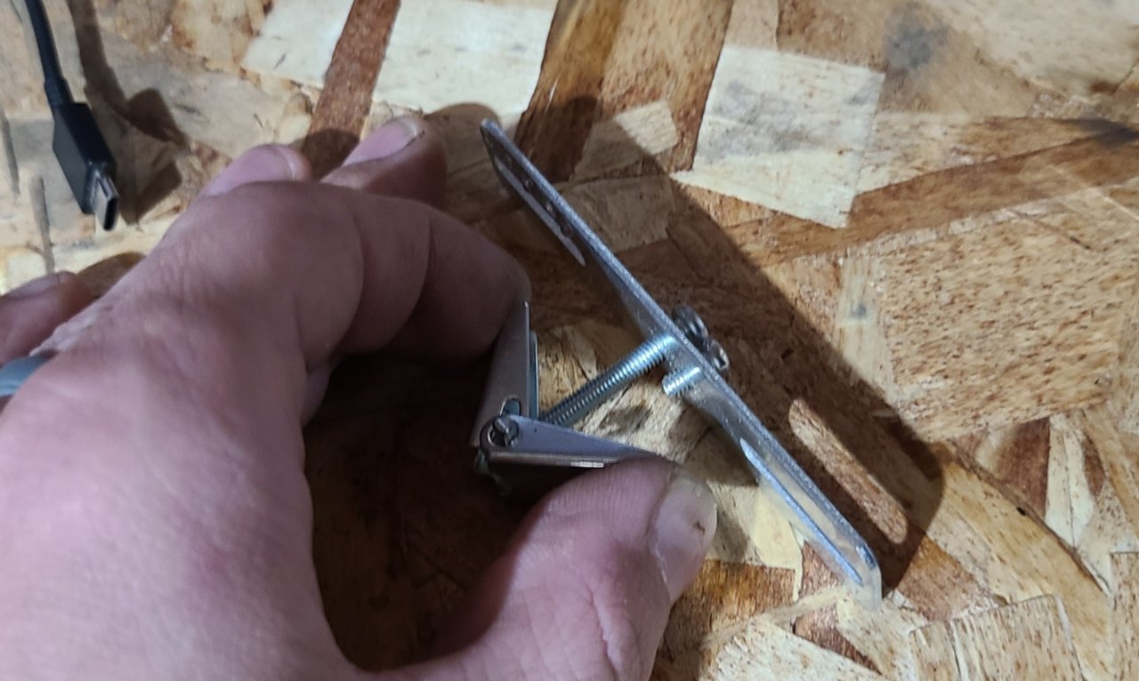

    I think there might be other shared ecgs tools floating around the site.
    I was hoping to get in on borrowing one once I get my bushing.
    The removal tool doesn't look difficult to make.

    This is a concept only taken off the wall anchor idea of a spring loaded removal tool. Made strong enough and to size would require no trimming.
    Possibly universal?
    Where are the machine shop guys at?

    The ECGS tool is cheap enough that it isn't really worth the time to build .... I have a metal lathe and mill and I still bought the ECGS tool. I have not broken one yet. The blind inner bearing puller below I think worked as well. Then you have it for other projects. I like where your head is at though!!!
