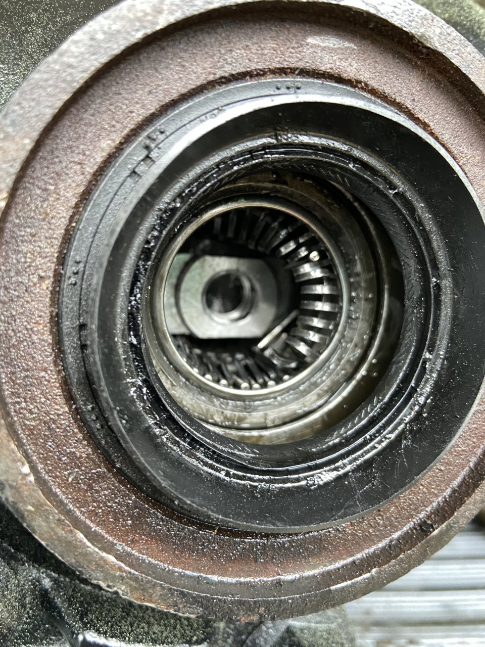

    Mine came out looking like this. Was a blast fishing around all in the seals to find all the pieces

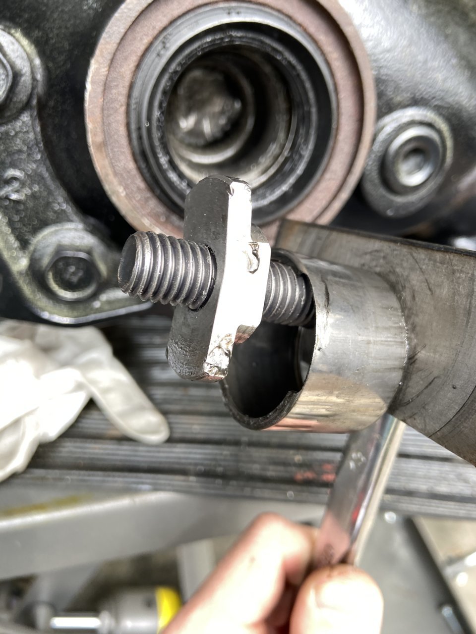

    These things ain’t very strong. I broke this with a hand wrench lol

    I thought the same. That flange does not take much load, even when the rollers are getting pretty bashed up. That flange should see no thrust load except when being pressed in or out.

    If you change the bearing before it's completely destroyed, it comes out relatively easily.

    I've replaced over a dozen needle bearings on Tacomas. The only time I've seen one like OP was the first one I did, on my personal truck. And it was due to the ecgs removal tool being too large by just a mm. Shaved down the ends and it fits like butter now.

    How easy should the ECGS bushing go into the housing? I did mine a few weeks ago. Took quite a bit of time to get the removal tool in place and got the needle bearing out. Bushing went in nice until it was about half way and it sure took a lot of effort to press in the rest of the way. To the point the end of the tool started to mushroom pretty bad. Thankfully I had an old piece of steel pipe I put over the handle. Not the worst job in the world but not as easy as YouTube made it out to be LOL. Happy my vibration is gone though.

    Starting it straight is crucial. For me I use the same amount of force going in throughout the process. I will say it takes a lot of strikes with the 3lb hammer. I just keep tapping until their install tool bottoms out. My install tool also mushroomed slightly. Still works great.
