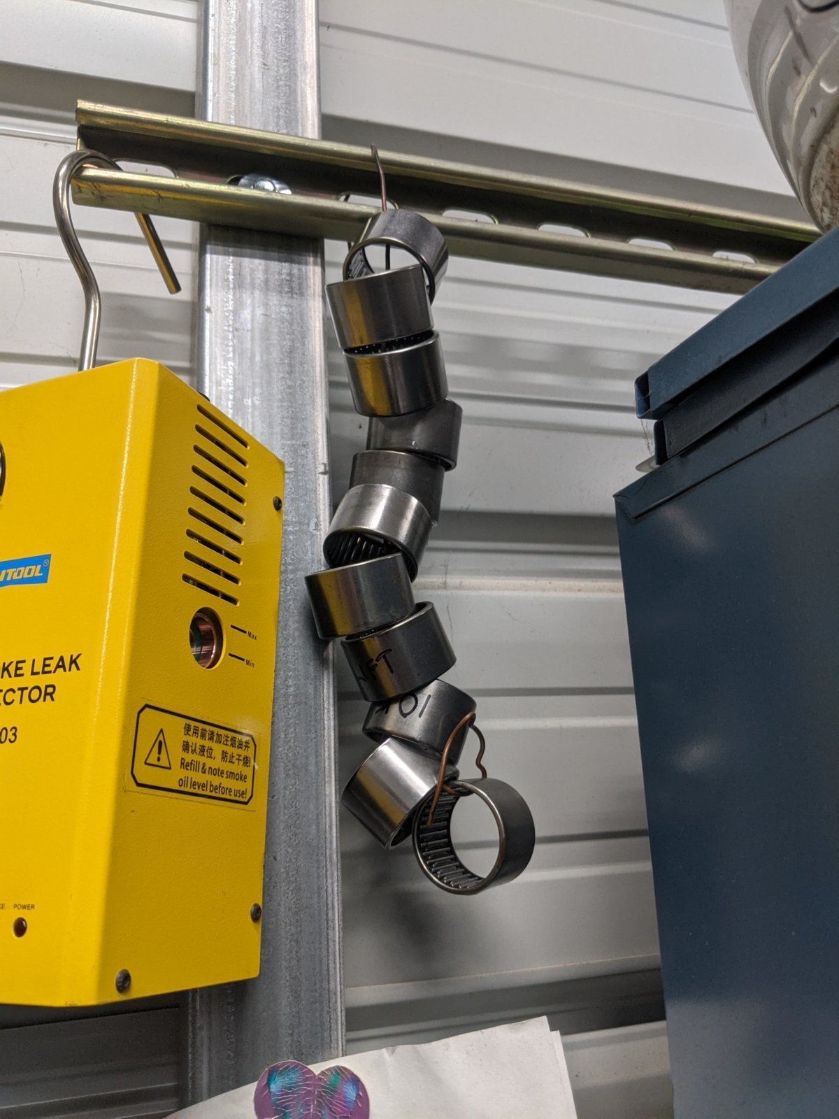

    I started keeping some as my trophies...... A local Toyota tech had me change quite a few under warranty with some creative paperwork... I've changed somewhere around 50 of them.
