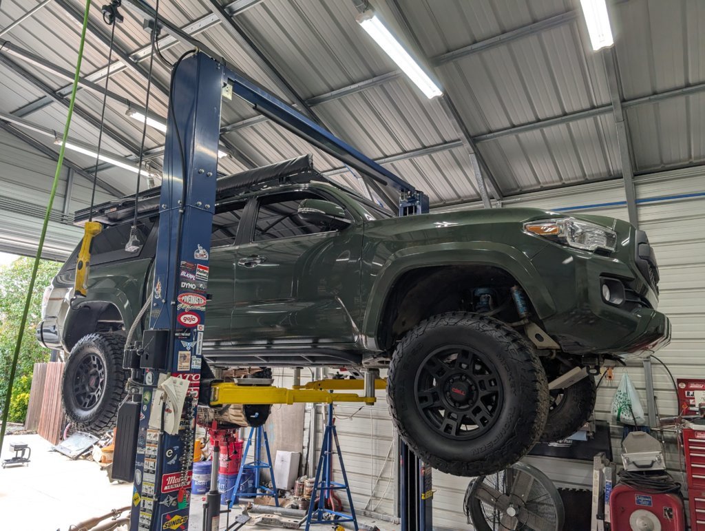

    Clutch (had to) and ECGS Bushing (preventative) on the lift today

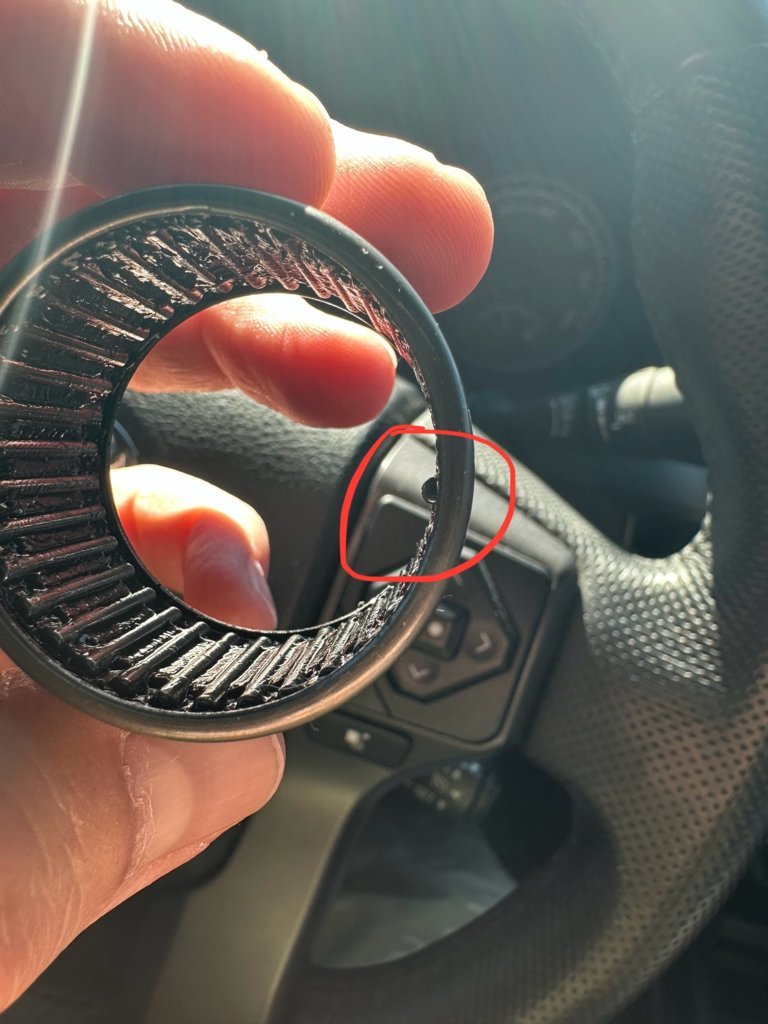

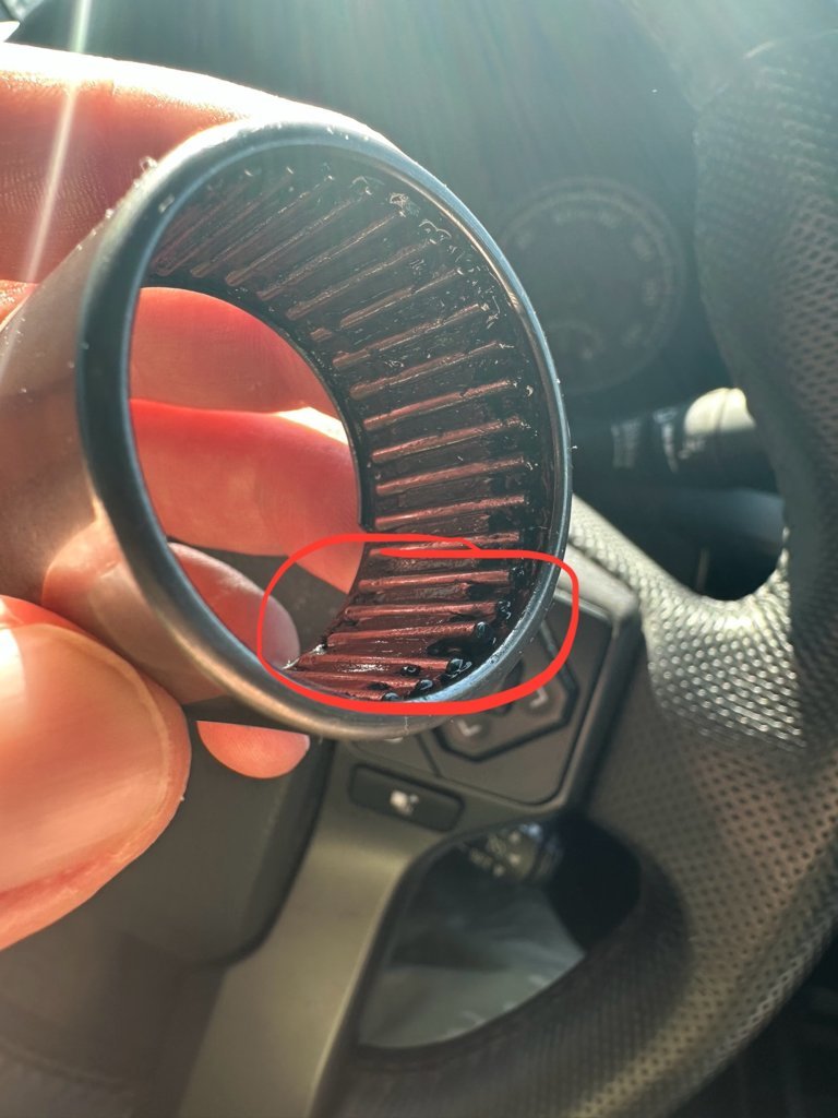

    EditEdit: just got the truck back and no more humming! Thank the Taco Gods! Shop let me hang on to the bearing, noticed something, one of the needles was pretty close to popping out (pictures inserted), glad I got it done when I did. (Needles were coated with grease to make them stick to the bearing body just in case they wanted to fall out).
