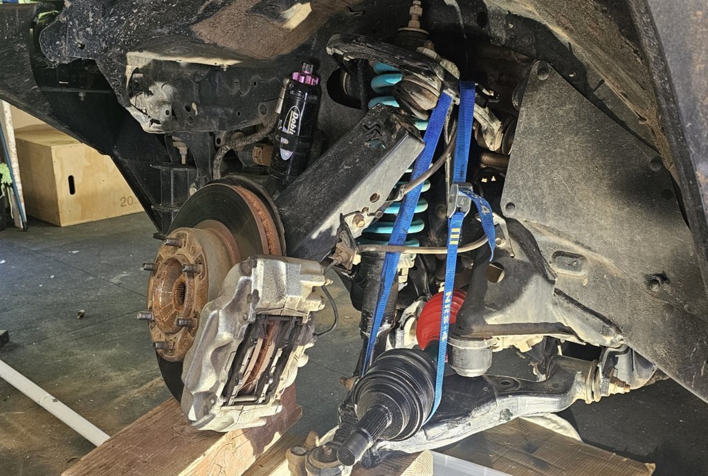

    I had my needle bearing replaced by @MyWyfsRnnr. He did a great job. I'd highly recommend.

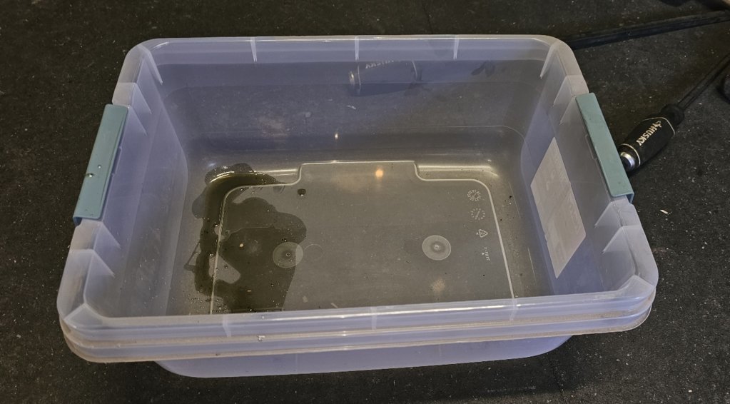

    I have since needed to replace my axle a few times and and thought I would share. I have found all I have to remove is axel nut and the 2 bolts at the bottom of the lca. I tap on the axel to seperste it from the spindle. I then swing it out of the way and sit it on something. I found it easier to remove and insert when it is level so I use a cam strap hooked to the uca. I remove my skid to knock axel out from the inside closest to the diff. OEM axels have these nice little grooves that a long pry tool can be used to hit. I have also found that if you jack this side of truck up as much as you can, like more than needed you will spill very little oil.
    Here how much oil was lost.
