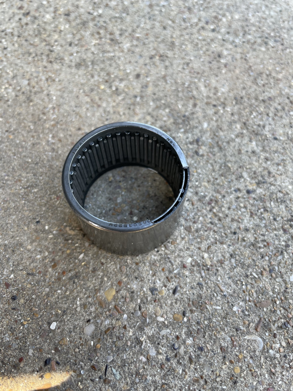

  16. Apr 22, 2022 at 6:09 PM
    #56
    eurowner
    eurowner Duke Sky
    Feb 23, 2017
    #211429
    7,385
    Scoty
    The Syncro Ranch, Salida ColoRADo
    '17 TRDOR DCLB FTMFWBBQ Silver Sky Met
    Bilstein 8112+650lb coils, 8100+Deaver Stage II leaf pack, SPC UCA, DuroBumps, Mobtown 0* sliders W/fill plates, Mobtown Recovery Bar, Radium PVC & CCV Dual Oil Separator Catch Can System, Snugtop Hiliner Sport, ATH bed Stiffeners (cuz bottle openers!) + front corner tie down, Badger plates for Firestone airbag + Relentless U-bolt flip + Daystar cradles, TRD Pro shift knob, TRD Exhaust, HPS Silicone intake tube, Green Filter, TRD Intake Air Accelerator, 265-70-17 Toyo Open Country ATIII on TRD 17" Rockwarrior Cold Forged wheels, TRD alloy front skid, RCI Aluminum transmission & transfer case skids. Much Meso awesomeness, FreshMexicanTaco TacoGarage Camera Controller + DDM, 67 Designs cradles, Banks Pedal Monster + iDash gauge, WarFab Sheridan hitch skid, Ricochet LCA aluminum skids, Rago lower rear shock guards, FN Koning Countersteer 16" spare, OEM T4R 90105-14104 coilover lower mounting eye bolts
    That's what the needle bearing looks like after they are pulled out. The outer race breaks off.
  17. Apr 22, 2022 at 6:19 PM
    #57
    Hook78
    Hook78 Well-Known Member
    Dec 3, 2017
    #237571
    6,896
    Eastern NC
    2015 DCSB TRD OR
    Bilstein 6112/5160 Icon RXT
    Mine didn’t look like that. Why would that portion break during removal, isn’t that the part that faces outboard (ie no contact with pulling tool)? I’ve seen lots of pictures of pulled needle bearings and this is the first like this.
  18. Apr 22, 2022 at 7:30 PM
    #58
    CaptainBart45
    CaptainBart45 Well-Known Member
    Sep 22, 2017
    #230761
    4,037
    Bart
    2017 Tacoma Sport 4x4
    Work in progress...
    Where is the broken piece? I hope you found it or some fragments.

  20. Apr 25, 2022 at 5:04 AM
    #60
    kasberry
    kasberry Well-Known Member
    Dec 20, 2021
    #385099
    216
    Kyle
    Kentucky
    2019 Cement TRD Off-Road
    It seems like most of the broken ones get damaged driving the ECGS removal tool in place behind the needle bearing. Mine came out undamaged, but hopefully everyone who had a piece of theirs break off shoved a rag or shop towel in first before beating the removal tool in place. Chunks of metal in your diff is never good.
