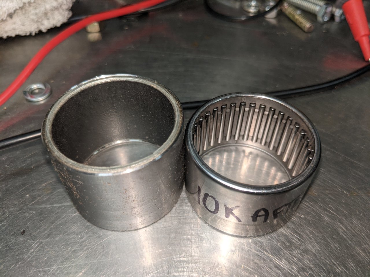

    I have had enough people in the Sac Ca. Area asking me to do them that I am "stocking" a few of them in the shop now. Here is a pic of the needle bearing vs the ECGS bushing
