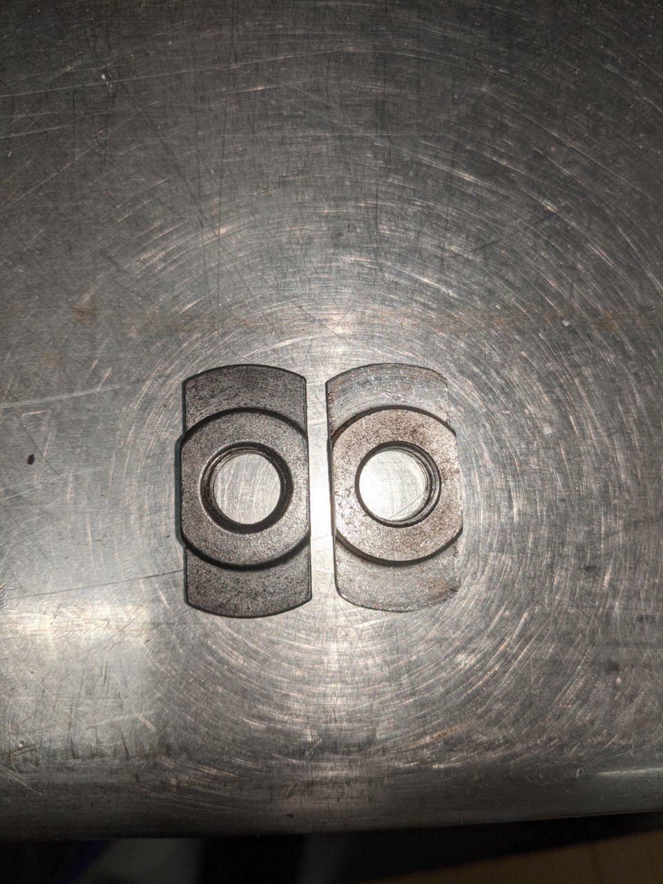

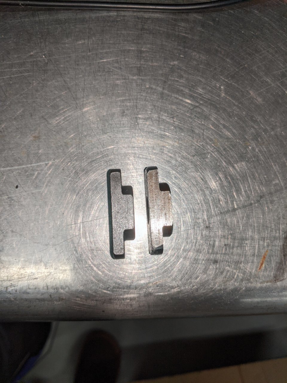

    Barely had to modify it. I could see it being a manufacturing issue because they are not "precision made". (not saying that is a bad thing, they work perfectly). But also the seated depth of the stock bearing could have something to do with it as well. PXL_20221017_133255862.jpg PXL_20221017_133320982.jpg

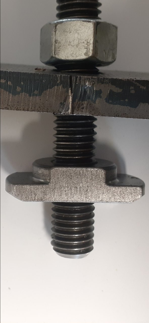

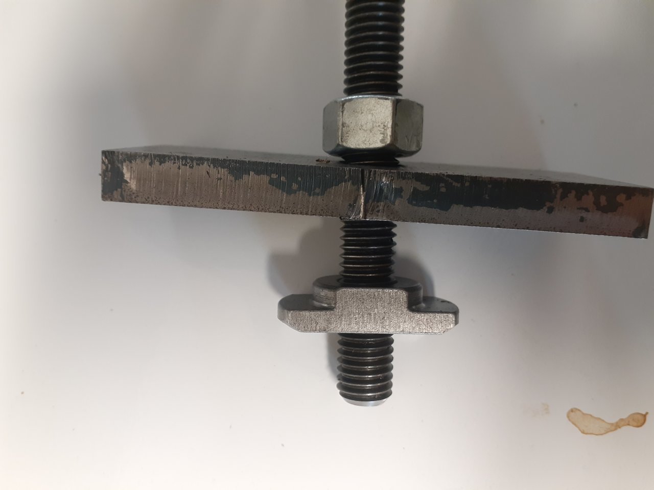

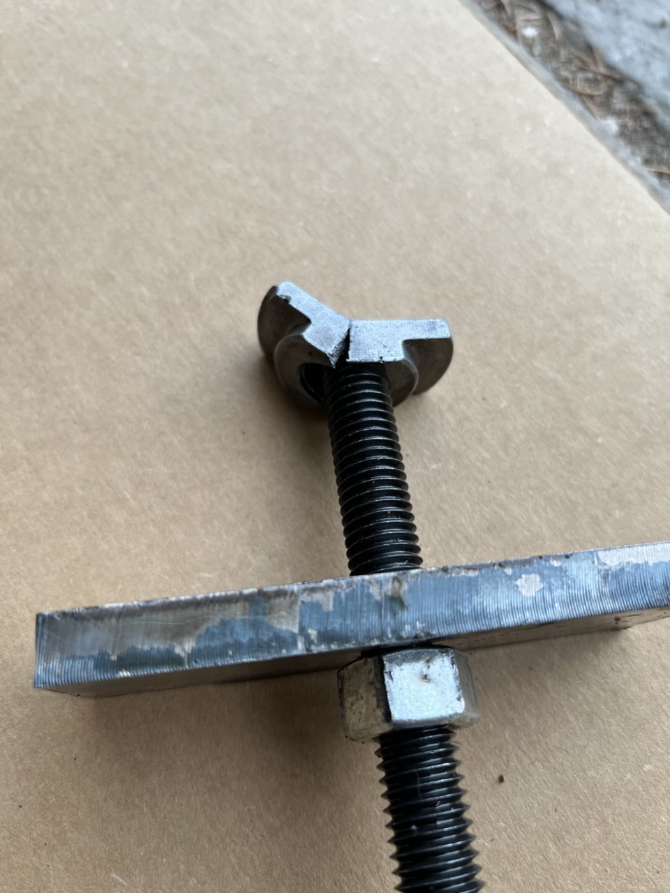

    Here's a pic of my Removal Tool, I just ground down a little on the top edge to make it easier to slip behind the bushing.
