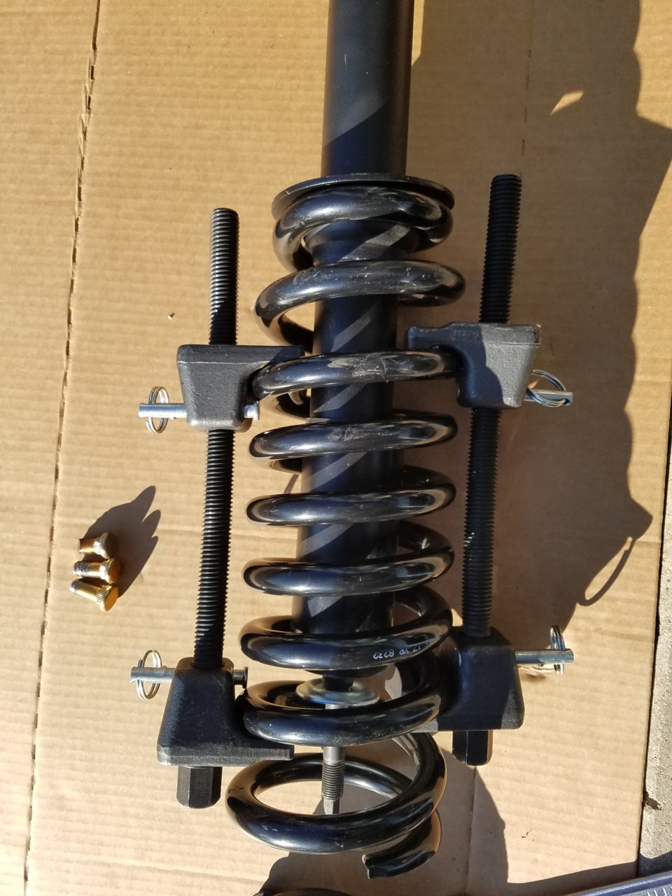

    Also, if you are doing the work yourself, spring compression is a pain, and slightly risky activity. Done it numerous times and it's not for the faint at heart.
    BTW, I know the safety pins are not engaged. They get stuck and bent on this particular type tool, but the gap in our coils seems to be less than others, and this is the only type rental tool that I have found that fits them.

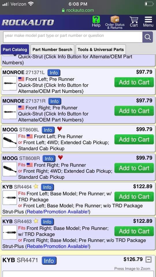

    Marie at Head strong is on a holiday vacation right now. I was unable to contact them. I did call wheelers and they advised that Bilsteins do not come with a coilover. They said I have to either buy new ones and assemble myself or use the factory ones. Seems like KYB might be the best option if the factory coils are now flattened as someone mentioned. Can I get the TRD ones if I have an SR5? [​IMG]80520858_10220223009262777_7652368498575_7679ba3c83ecb09193b9622c9a24a12d4b09edd1.jpg
    Can you tell by the picture how little space I have between the tire and the front fender flare in my profile pic if the coils are flattened?
